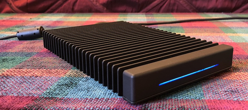

The ThunderBlade V4 comes in a hefty aluminum enclosure covered in large fins to help with heat dissipation, as this drive can get fairly warm when you're reading and writing a lot of data. There is no active cooling in the drive, which helps with the ThunderBlade V4's ruggedness as there are no moving parts.
The ThunderBlade V4 measures just under 5 inches wide, a little over 7.5 inches deep, and just over an inch high. It weighs a little under two pounds, which gives it a solid feel and good stability on a desk. A separate power adapter also adds some bulk to deal with elsewhere.

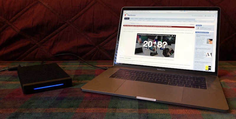

The only feature on the front of the ThunderBlade V4 is a thin three-inch long LED that shines white when connected to power (and also when connected to a sleeping computer) and blue when the drive has an active connection to a computer. While the LED appears to be a single thin indicator, it's actually made up of four distinct segments, one for each M.2 drive in the ThunderBlade.
Each segment will blink blue when data is being written to or read from the corresponding drive. With the speed of the drive and the four onboard SSDs, you'll see a sort of flickering ripple effect across the LED as data is moved.

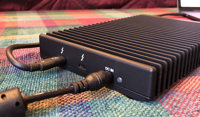

In addition to the light sensor, the rear of the ThunderBlade includes a port for the power adapter connection and a pair of Thunderbolt 3 ports. One Thunderbolt 3 port is used to connect the ThunderBlade to your computer using the included 0.5-meter Thunderbolt 3 cable, while the second is available for daisy chaining a display or other peripherals.
The Thunderbolt 3 ports are capable of supplying 15 watts of power each, but that won't be enough to power a MacBook Pro. This isn't intended as a true docking station, however, so it's not surprising that the power output is limited and primarily intended to drive downstream peripherals rather than host computers.

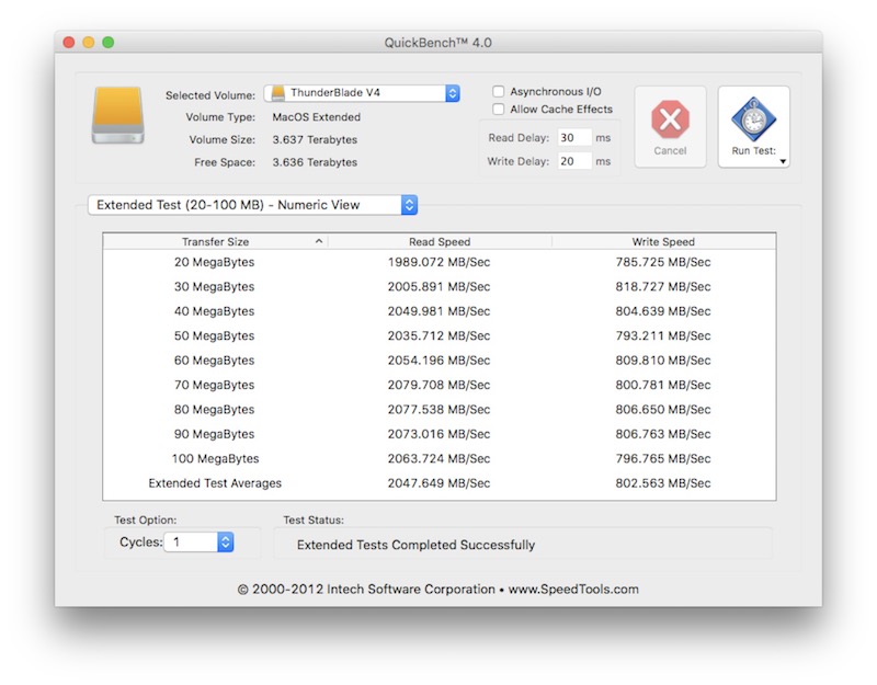

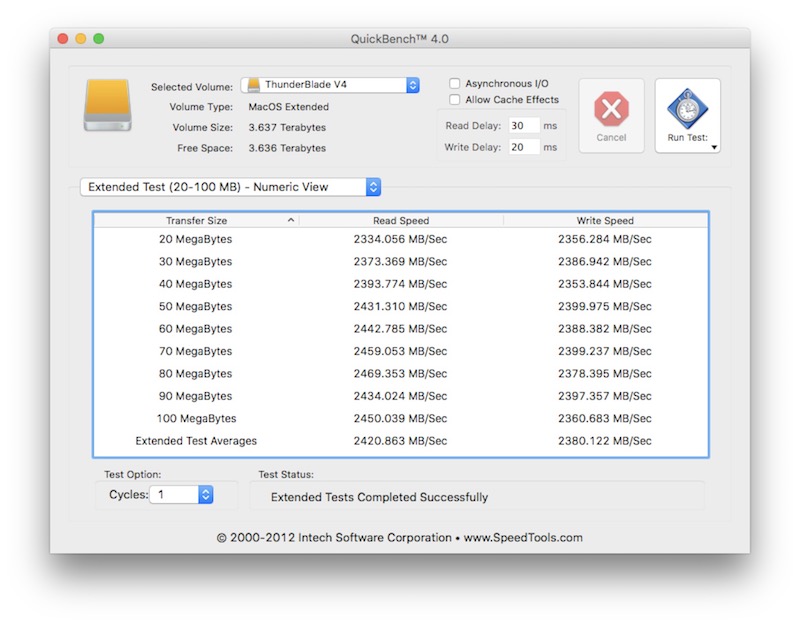

We ran some QuickBench disk speed tests on the ThunderBlade V4, and while we didn't quite hit OWC's top numbers, the drive still showed some seriously fast performance. Connecting directly to a 2016 15-inch MacBook Pro, we saw read and write performance in the range of 2400 MB/s in extended testing mode with transfer sizes in the 20-100 MB range.

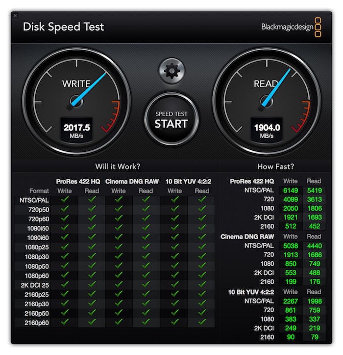

Similar speed tests using Blackmagic with larger transfer sizes of 5 GB yielded slightly lower speeds of over 1900 MB/s read and 2100 MB/s write, although it is difficult to directly compare the two different methodologies. Even that performance allowed the ThunderBlade to ace Blackmagic's "Will it Work?" rating system that determines whether a drive is fast enough to handle video in various combinations of formats, resolutions, and frame rates.

With an LG UltraFine 5K connected to the downstream Thunderbolt 3 port on the ThunderBlade, we obviously saw lower speeds as some of the bandwidth was being dedicated to the display. Write speeds were impacted most significantly, dropping to around 800 MB/s, while read speeds dipped slightly to around 2050 MB/s.
