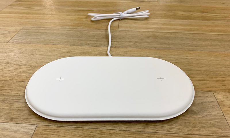

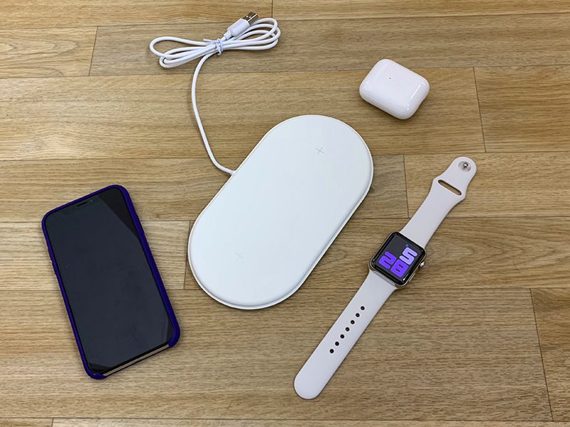

Priced at $99, the AirUnleashed promises to charge the iPhone, Apple Watch, and AirPods all at the same time with a single oval-shaped wireless charging mat. The catch is that the devices need to be placed in specific spots on the charger rather than anywhere.

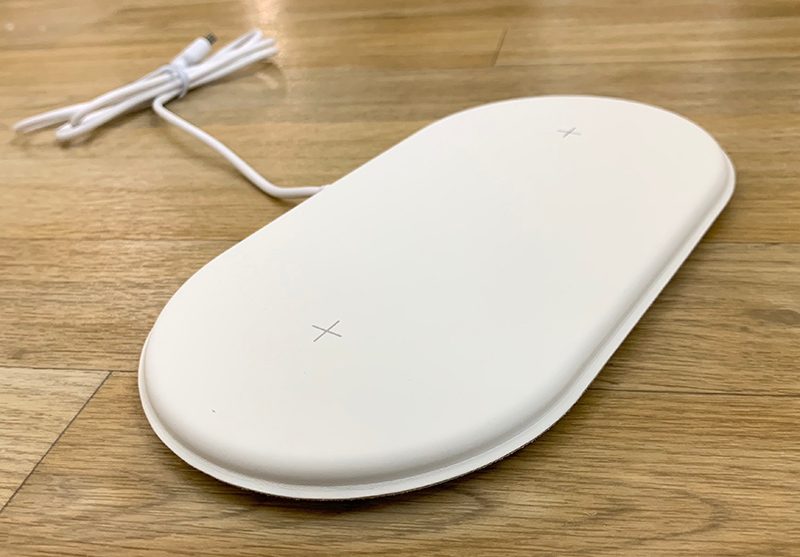

Design wise, the AirUnleashed is a simple flat wireless charging mat with a suede-like microfiber coating. Two "+" icons let you know where to place the iPhone and the AirPods, while the indentation at towards the middle right lets you know where the watch needs to go.

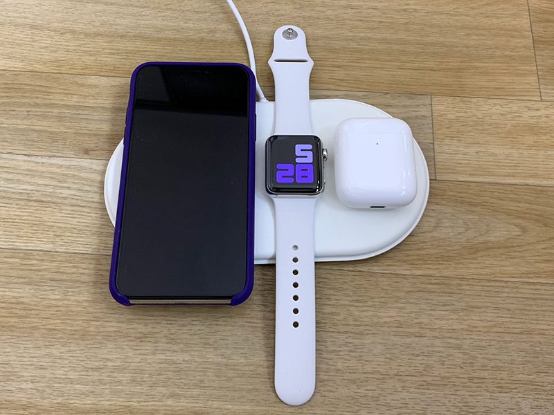

The Apple Watch needs to be specifically placed in this spot because the Apple Watch uses a magnetic inductive charger (underneath the mat's surface) and is not able to charge via Qi wireless charging. The larger charging spot on the left side of the mat is designed for the iPhone, and the smaller charging spot is meant for AirPods.
The AirUnleashed has a design that's reminiscent of the AirPower. In fact, it straight up copies the AirPower's design, which would have been an issue had the AirPower ever launched. It's a fine design -- Apple came up with it after all -- and it doesn't take up too much room on a desk.

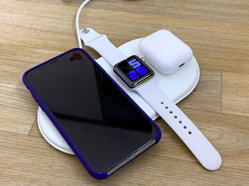

Flat charging like this is fine for the AirPods and the iPhone, but when it comes to the Apple Watch, it's not great with the loop-style bands. With my Sport Loop, for example, I can't use this charger without taking the band off or twisting it out of the way, which is a hassle compared to other watch charging options better suited to loop bands.
I didn't have issues getting any of my devices to charge, but aligning everything properly sometimes required more attention than I generally prefer to give to a wireless charger. I also imagine it could be finicky to use in the dark.

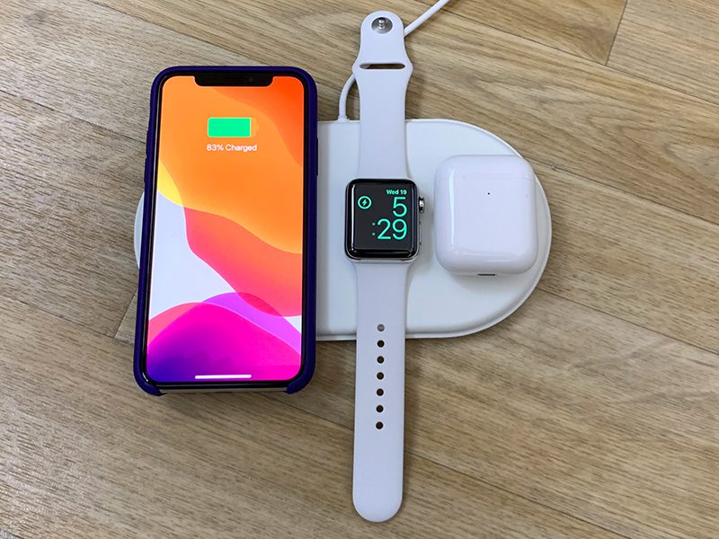

The charging coil on the on the left of the device is 7.5W, so it can charge your iPhone at full speeds, and the charging coil on the right is 5W, so it can charge the AirPods at full speed or an iPhone at a slower speed. The Apple Watch charger is 2W.
You'd probably expect the AirUnleashed to be able to charge all three devices at their maximum charging speeds at one time given that it's meant to be a three device charger, but there's a catch. The maximum wireless output of the AirUnleashed is 11.27W because of a 75 percent conversion rate, so with three devices on the charger, it's not going to charge them at the full power they're capable of receiving.
My iPhone X charged from 0 to 41 percent over the course of an hour when it was the only device on the charger, but with AirPods and an Apple Watch also charging at the same time, that dropped down to 37 percent over the course of an hour. It's not a huge difference, but this isn't going to be a charger you'll want to grab when in a time crunch.
The slower charging speed is fine over the course of a day if you've got it on your desk, or at night. If you have a Samsung phone or another device that can charge at 10W, the AirUnleashed's right side charger does support 10W charging, though the same caveats with charging speed and multiple devices apply. The AirUnleashed is unfortunately not great for charging two smartphones at once because of space constraints when the Apple Watch is charging and because of the speed limitations.
