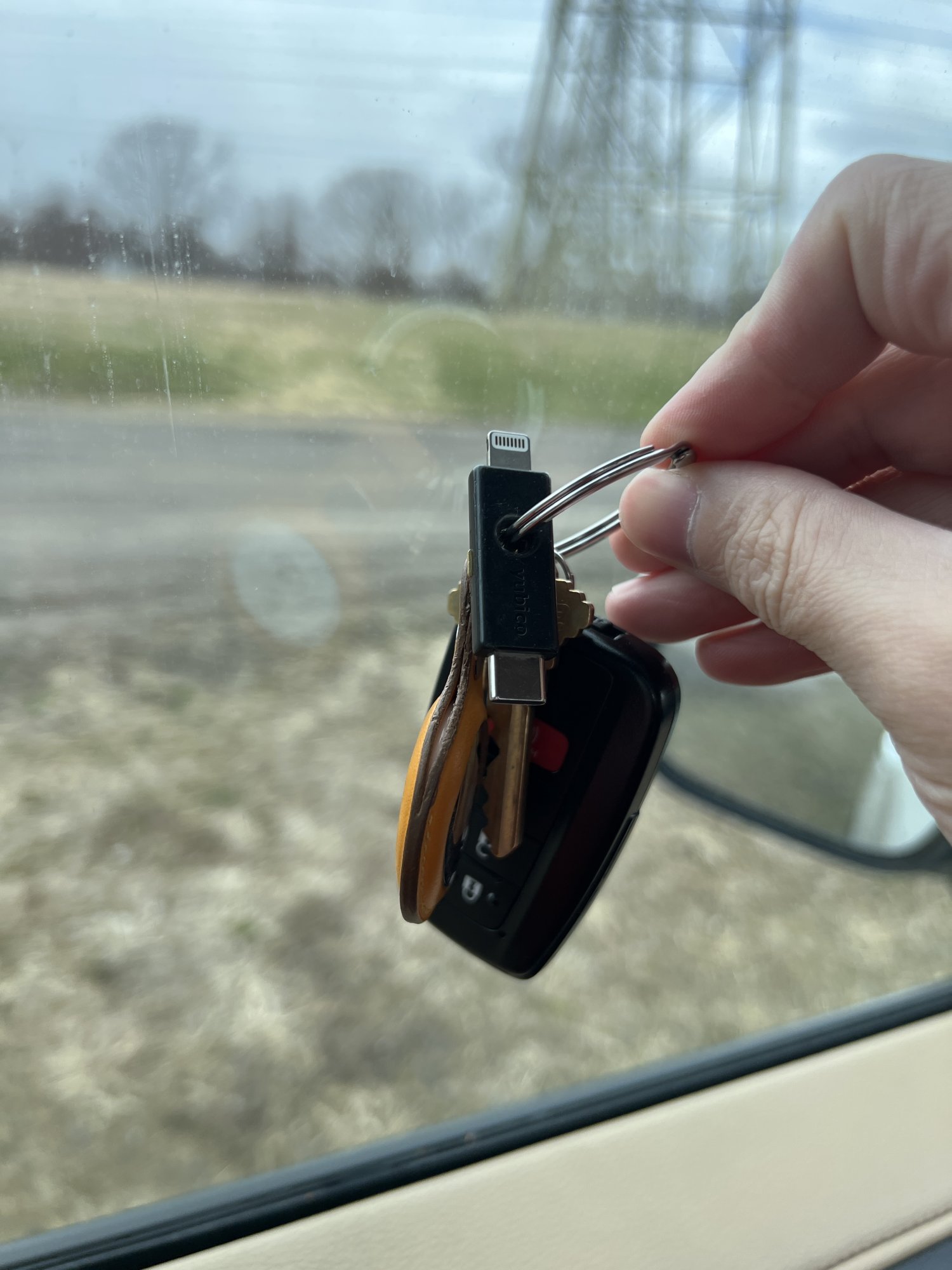

I got three yubikeys, with one on my carkeys, another on a lanyard and the third permanently on my imac
Great experience thus far and looks to cover all possible scenarios that I have come across
