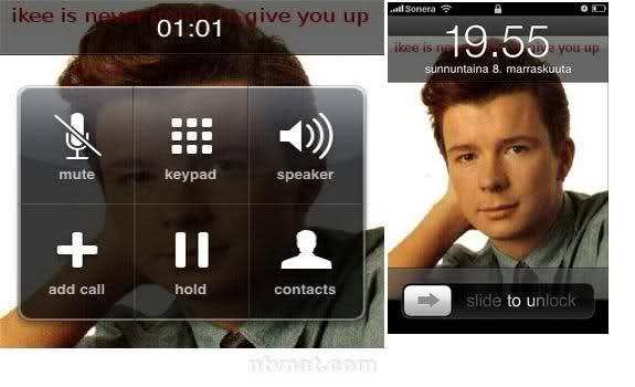

People, the cure is simple, change your passwords if you plan to install OpenSSH... or make an SSH tunnel out of your phone.
I got rickrolled 🙁
Serves me right for not changing default SSH password, I'm glad it was nothing worse!
Oh well, fixed now. And password changed 😉

[10:33] <ikee> Sure, variants A-C store files in these directories
[10:34] <ikee> /bin/poc-bbot
[10:34] <ikee> /bin/sshpass
[10:34] <ikee> /var/log/youcanbeclosertogod.jpg
[10:34] <ikee> /var/mobile/Library/LockBackground.jpg
[10:35] <ikee> /System/Library/LaunchDaemons/com.ikey.bbot.plist
[10:35] <ikee> /var/lock/bbot.lock
[10:35] <ikee> using an rm (in SSH or mobile-terminal on those files will remove it)
[10:36] <ikee> then reboot the phone, change your password and reinstall SSH
[10:36] <ikee> For variant D its abit different
[10:36] <ikee> The locations are
[10:37] <ikee> /usr/libexec/cydia/startup
[10:37] <ikee> /usr/libexec/cydia/startup.so
[10:37] <ikee> /usr/libexec/cydia/startup-helper
[10:37] <ikee> /System/Library/LaunchDaemons/com.saurik.Cydia.Startup.plist
[10:38] <ikee> Of course cydia used these files previously so you may need to reinstall it after deleting these files
