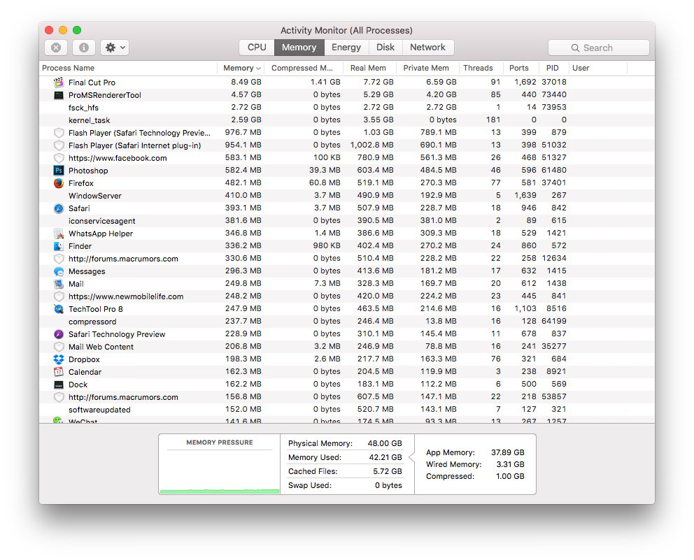

However, for your reference, when I am using FCPX + encoding + browser (with flash content) + photoshop still open... My Mac can use 42GB+ of RAM (not including cache). So, may be you are looking for 48GB or more.
