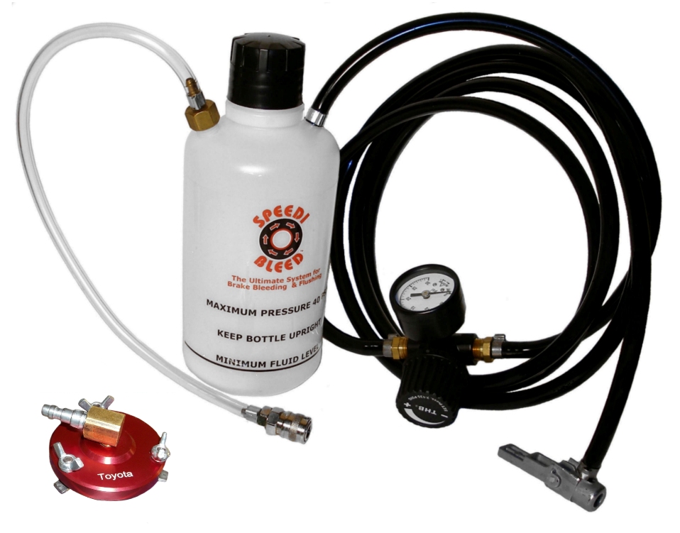

I also found some mention of shops using some pressurized system. Which fits to the reservoir. Then pushes brake fluid into the system. While you pump the brakes.
