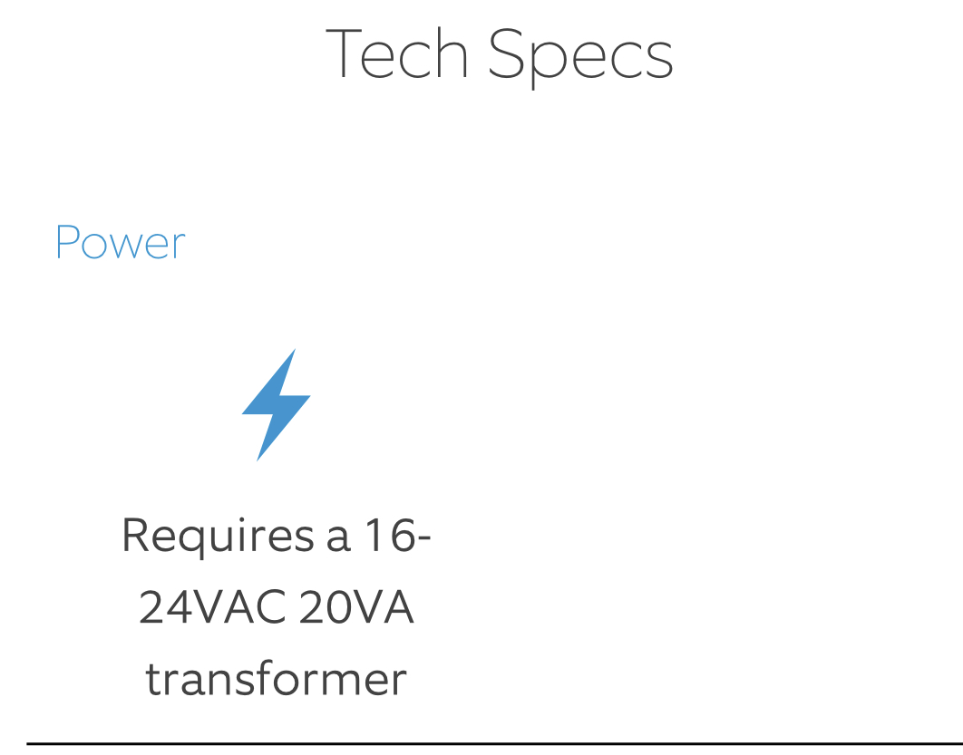

Good to know, thanks for that. The Pro is the more expensive model, right? Is there a way to find out if my current doorbell has enough power to run it beforehand, or do I have to find out once I take it apart?
See tech specs for the Pro.
https://support.ring.com/hc/en-us/a...ent-Power-Issues-with-Ring-Video-Doorbell-Pro
If your existing doorbell transformer is rated at less than 16 volts AC at 20-30 volt-amps, you'll need to upgrade it to a higher voltage to support Ring Pro.

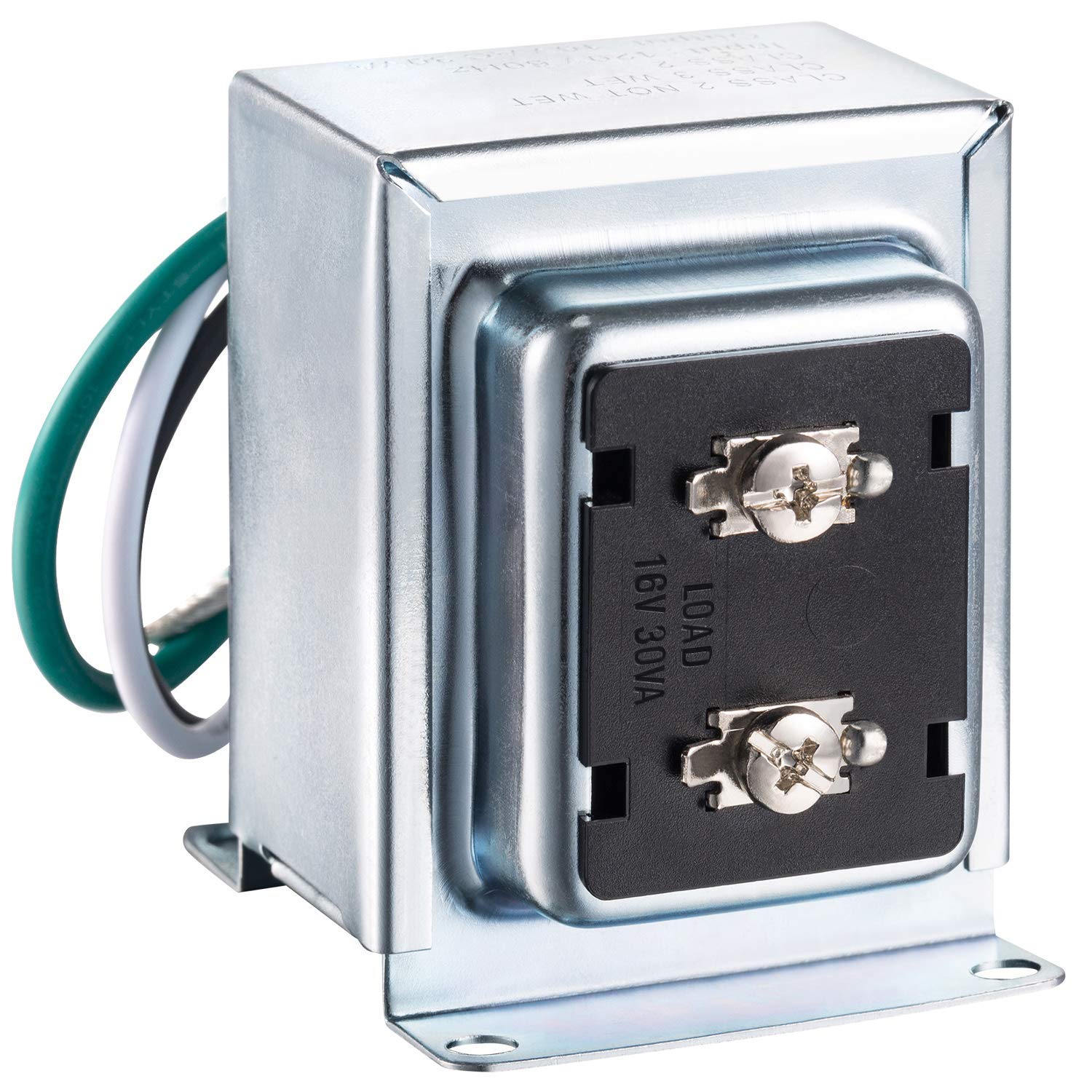

Just look on your transformer and you will see the specs. If you look close on this one you can see 16V 30VA for example.
https://www.amazon.com/NuTone-C907-...227&sr=8-3&keywords=ring+doorbell+transformer
A lot of people use this one from Amazon.
