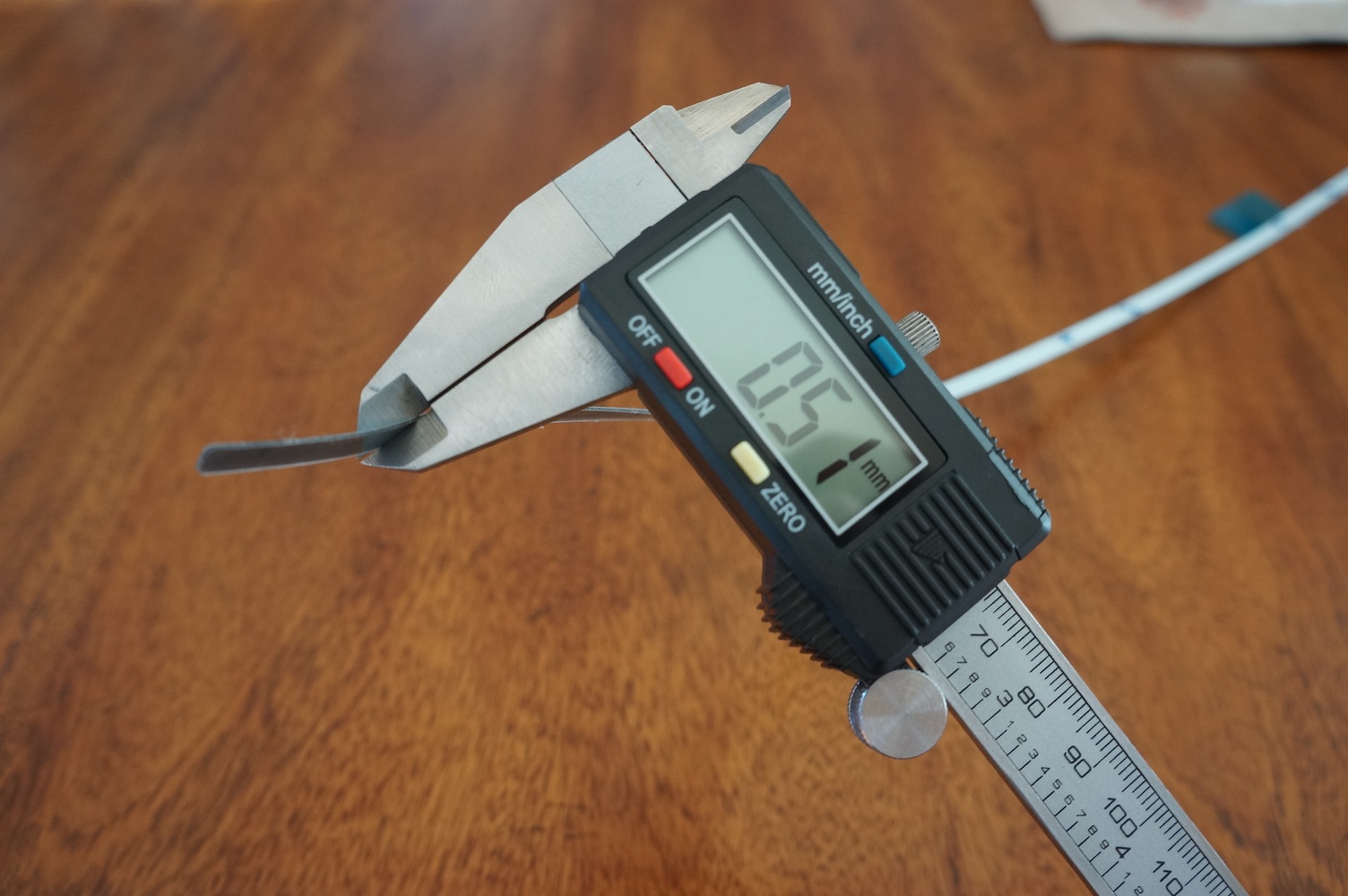

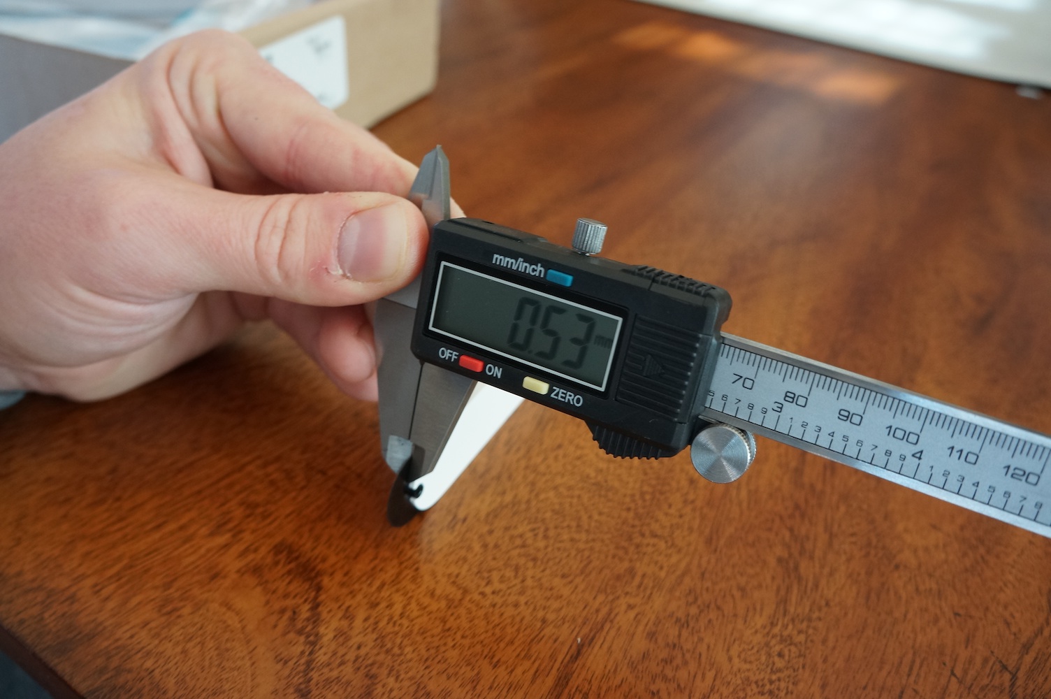

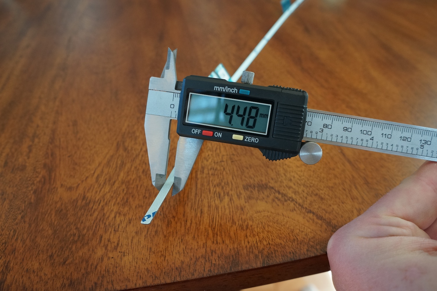

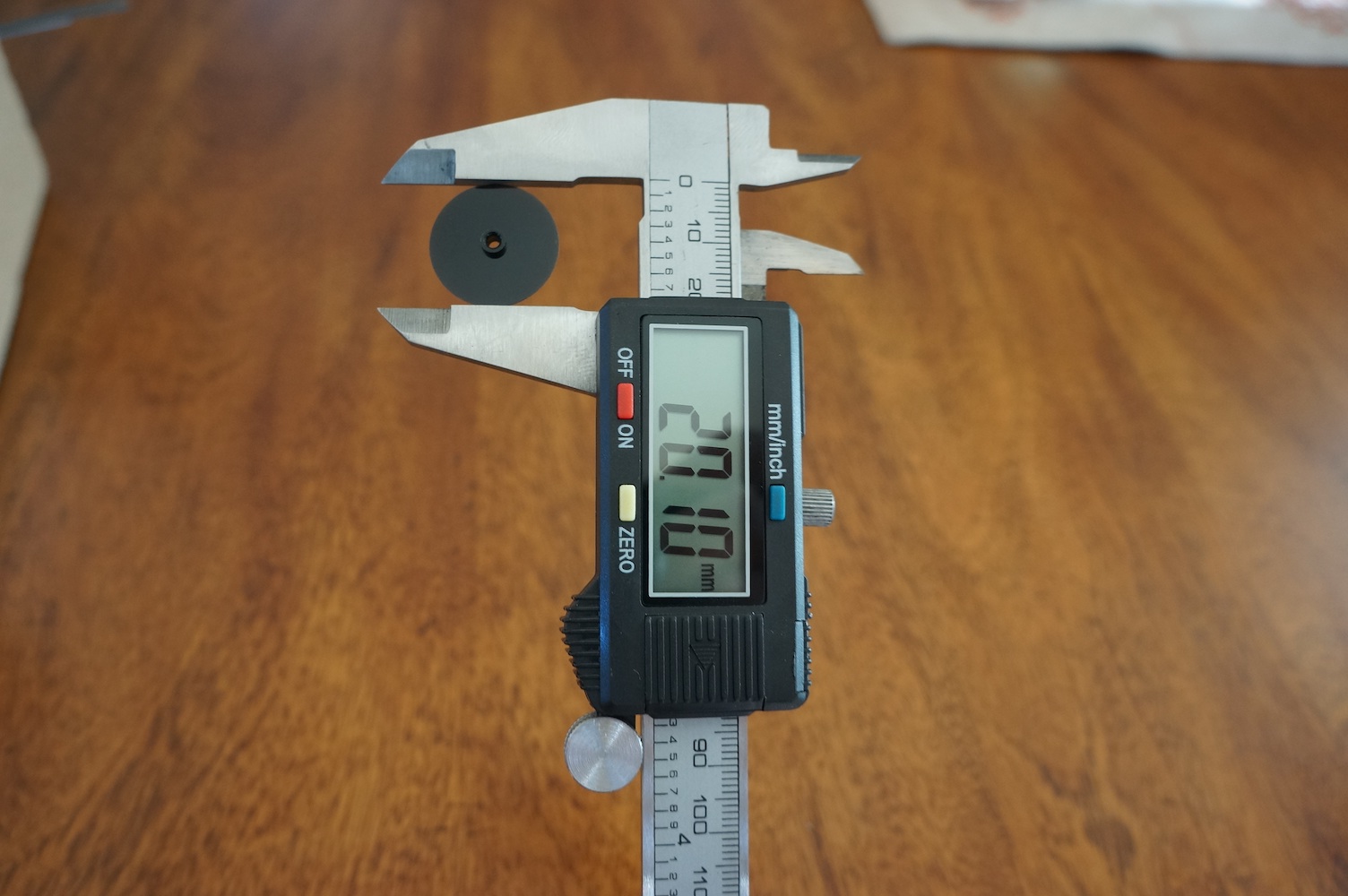

Here are some additional ones that will show the size and thickness of the tape and the cutting wheel.
Another little observation is that the cutting wheel is VERY thin (as you can see in the photo .5mm) so in effect it is slicing through the foam tape. The reason that the instructions tell you to remove the residue from both the screen and chassis is not because you apply tape separately to both, but because when the foam is cut it leaves the residue backing on both.
Also, the cutting wheel has a hole in the middle (probably to aid its removal from the hand tool), it would be pretty trivial to improvise a handle with a coat hanger, paper clip or something similar. You could also simply cut a flimsy "handle" out of strong corrugated cardboard and put a small notch in it to put the wheel in and it would get the job done.
