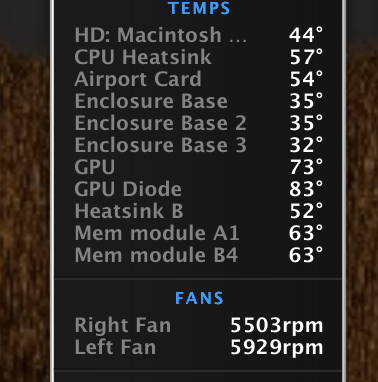

is there a way to fix this? My rMBP gets crazy hot and the fans kick in and go around 5k when I just watch simple 10mins flash video. I understand that flash is not optimised that well on OS X but this is Apple's flagship computer. I mean, just a simple video gets it act crazy. IS that normal?
I'm watching this video for example
http://pixologic.com/zclassroom/homeroom/lesson/fibermesh/
within 2 mins of watching fullscreen I get these stats (pic attachment).
If I pause the video it goes back to normal (fans around 2k)
Is there a way to tweak it? The fans are so loud that the watching is not enjoyable and the computer is very hot.

The only way to keep temps low is to ensure adequate ventilation and cool room temperatures. Ensure no other app is running. if you have two gpus try to use the intel gpu using a software gfxcardstatus. Your fans are going up cause the gpu is getting warm. left fan cools the gpu but both fans can help get temps down faster. CPu temp seems to be fine.

I have the rMBP on a stand that is flat and only covers around 60% of the bottom so the heat on those uncovered sides can get out even better. I also have automatic GPU switching so I don't understand what benefit I would get from the intel gpu?
Could you please try to run the video and let me know if you get similar stats? I mean my room is not hot at all and everything is normal 🙂

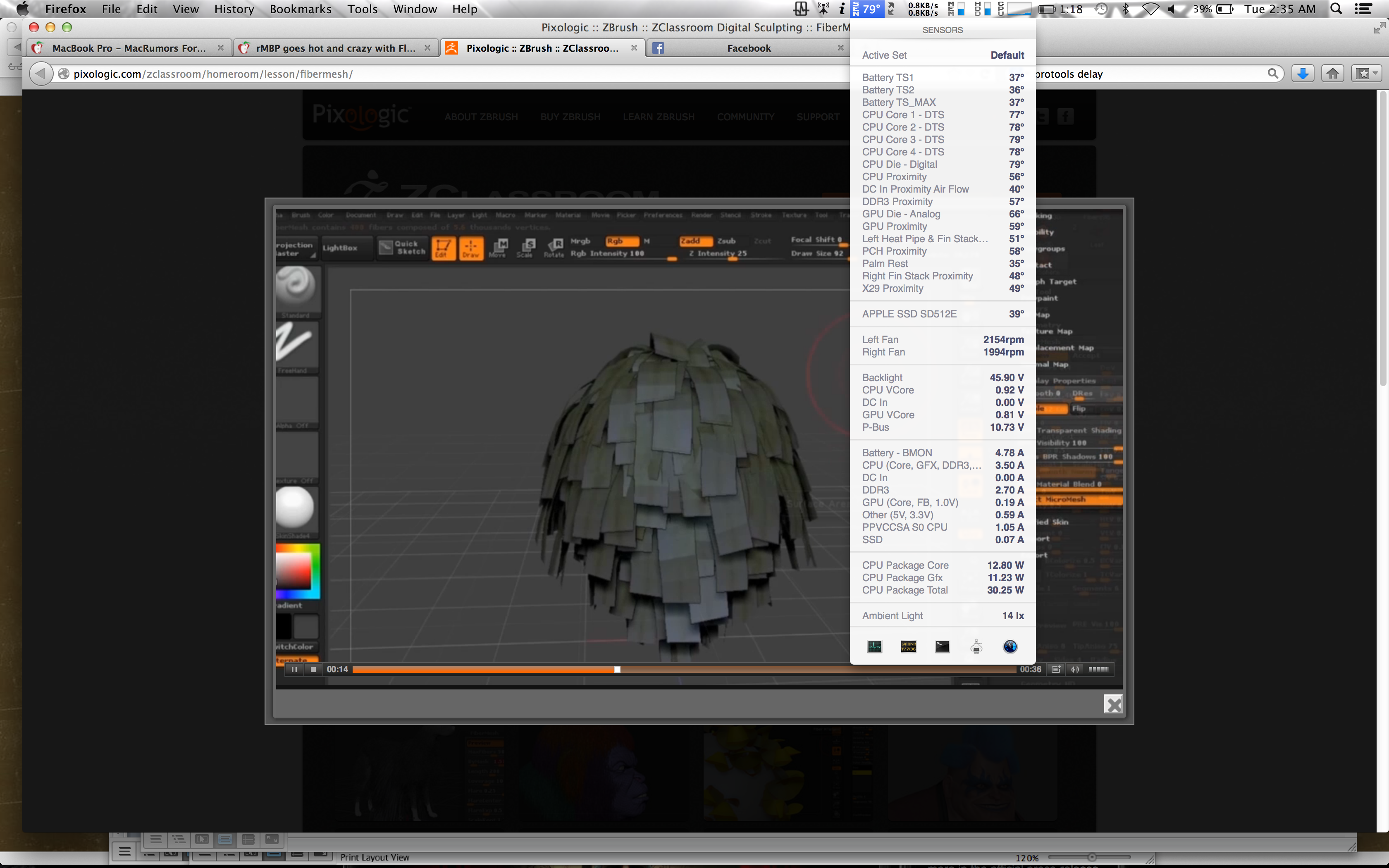

well i have just watched the video on both the intel and Nvidia graphics card shows that the nvidia taxes my cpu a bit more and generates more heat. I played the video 2-3 times on each gpu continuously here's pics of my temps. My room temperature is 26c
The intel Gpu
The nvidia gpu
I must say though my fans shoot up while rendering, i find it much less noisier then the cMbps i had before the fans would be make that silent noise like a jet which was annoying, this one just has a whoosh. I feel apple did a good job with the cooling system but i find the air is pulled in from the ports, you can feel it when the fans are on full blast.

I've actually done some elimination process and found few interesting things + the root of the problem.
1) when i watch it in a window it works fine. Minor temp increase and fan increase but still way below 3k
2) when i watch it in full screen, temp and fan go crazy as on the picture i posted in the first post
3) when I go to my display setting and change the resolution back to "best for retina" then it all works fine. Full screen or window, things are absolutely ok.
So my question is, is there a way to have the resolution 1650x1080 without having this issue or is that scaling something that will always cause trouble?
