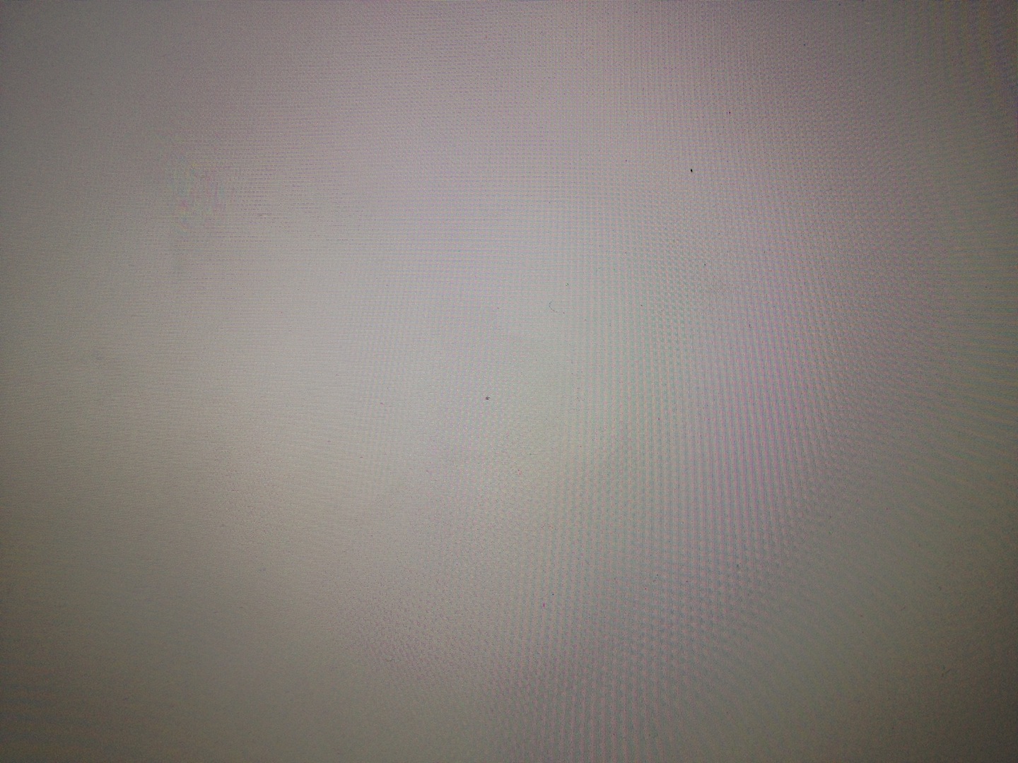

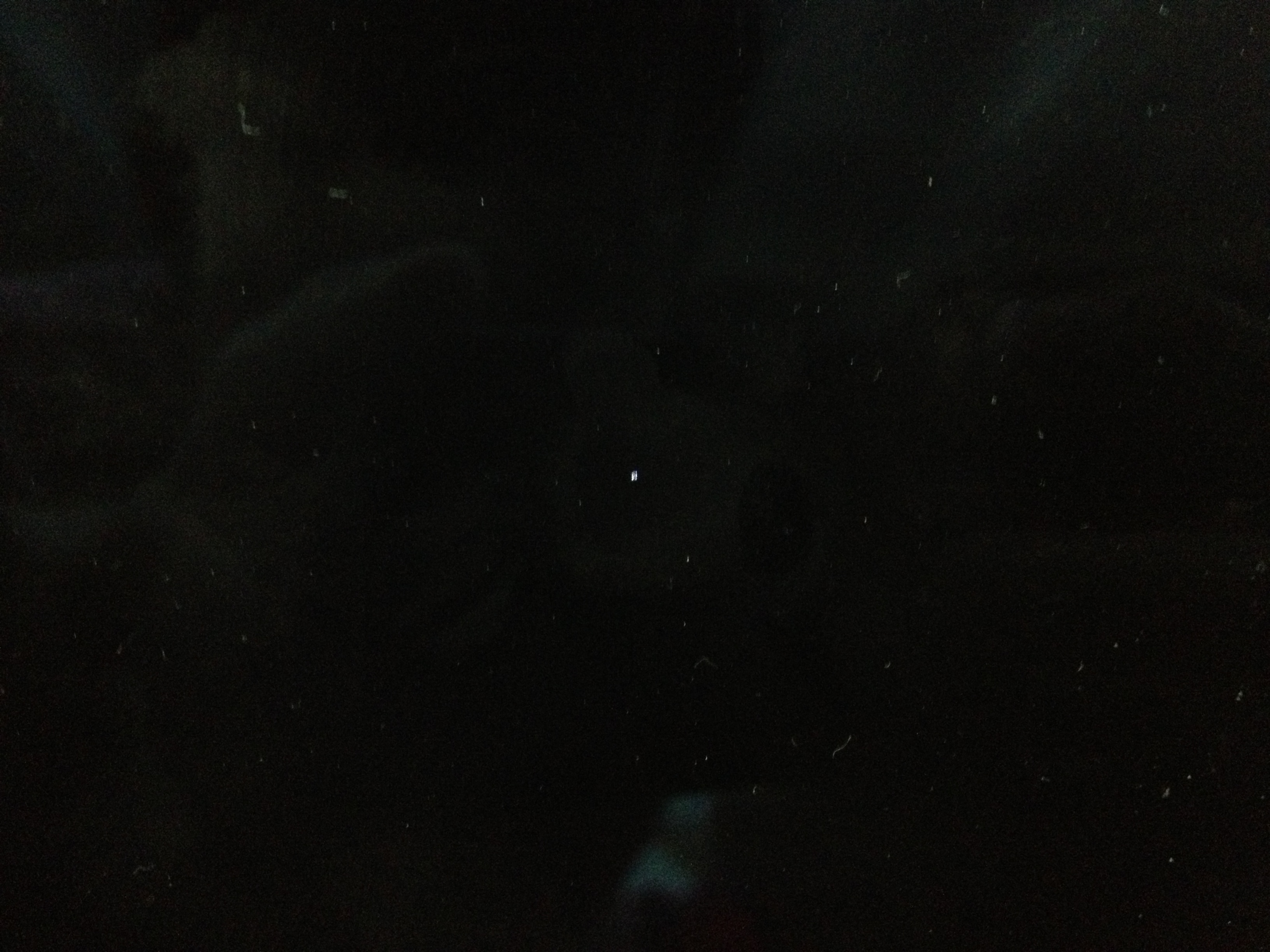

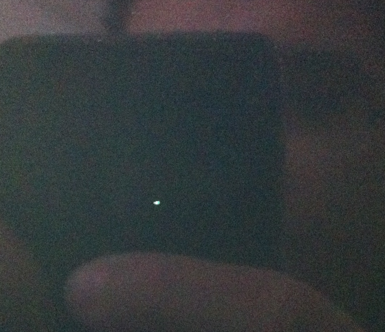

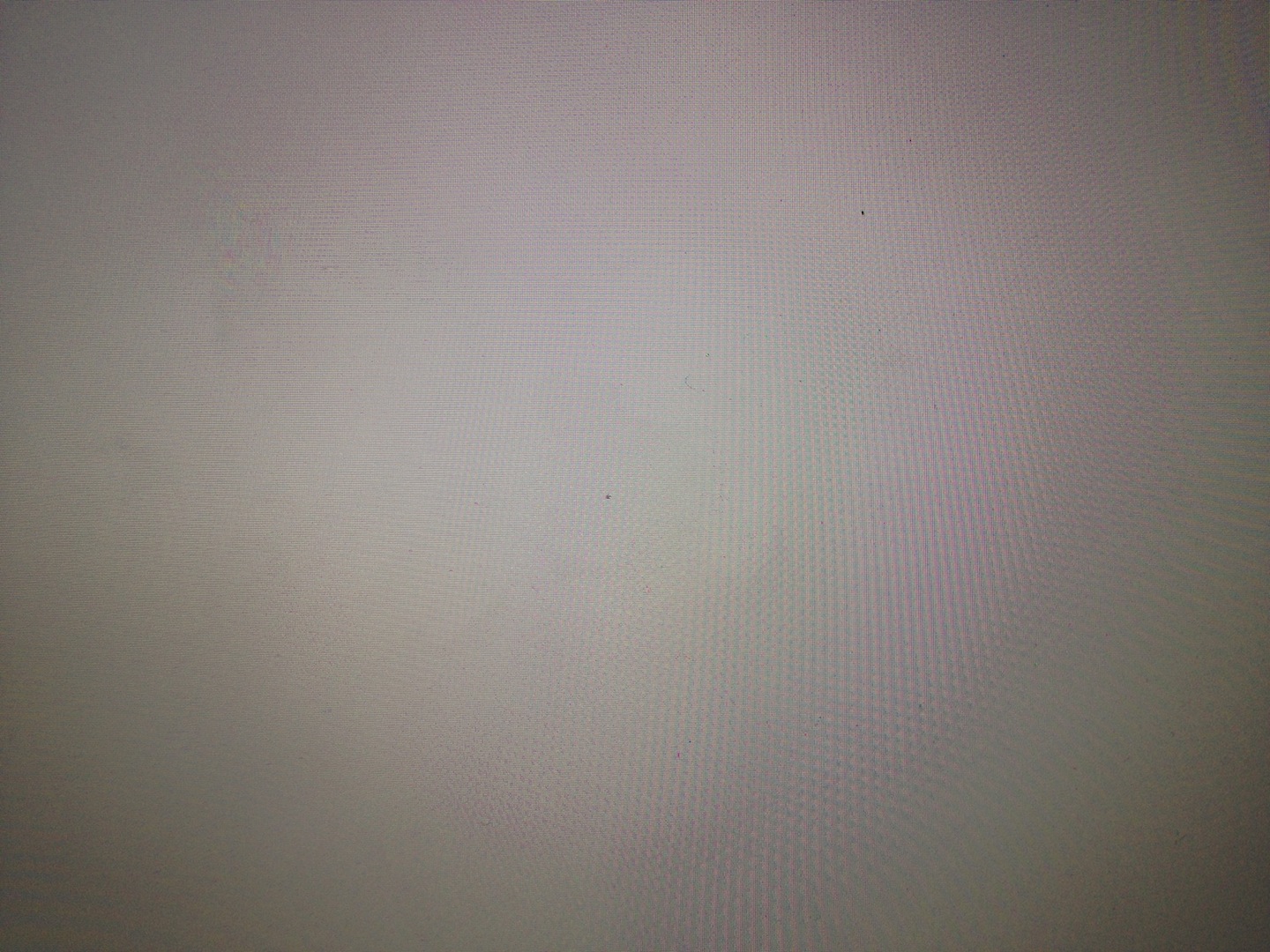

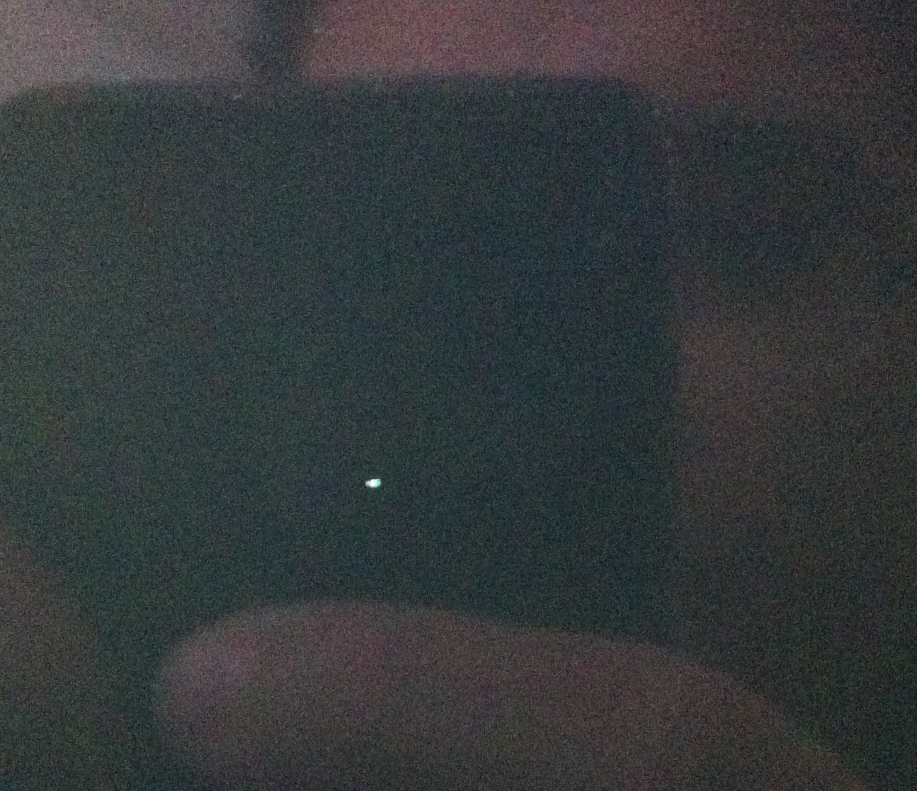

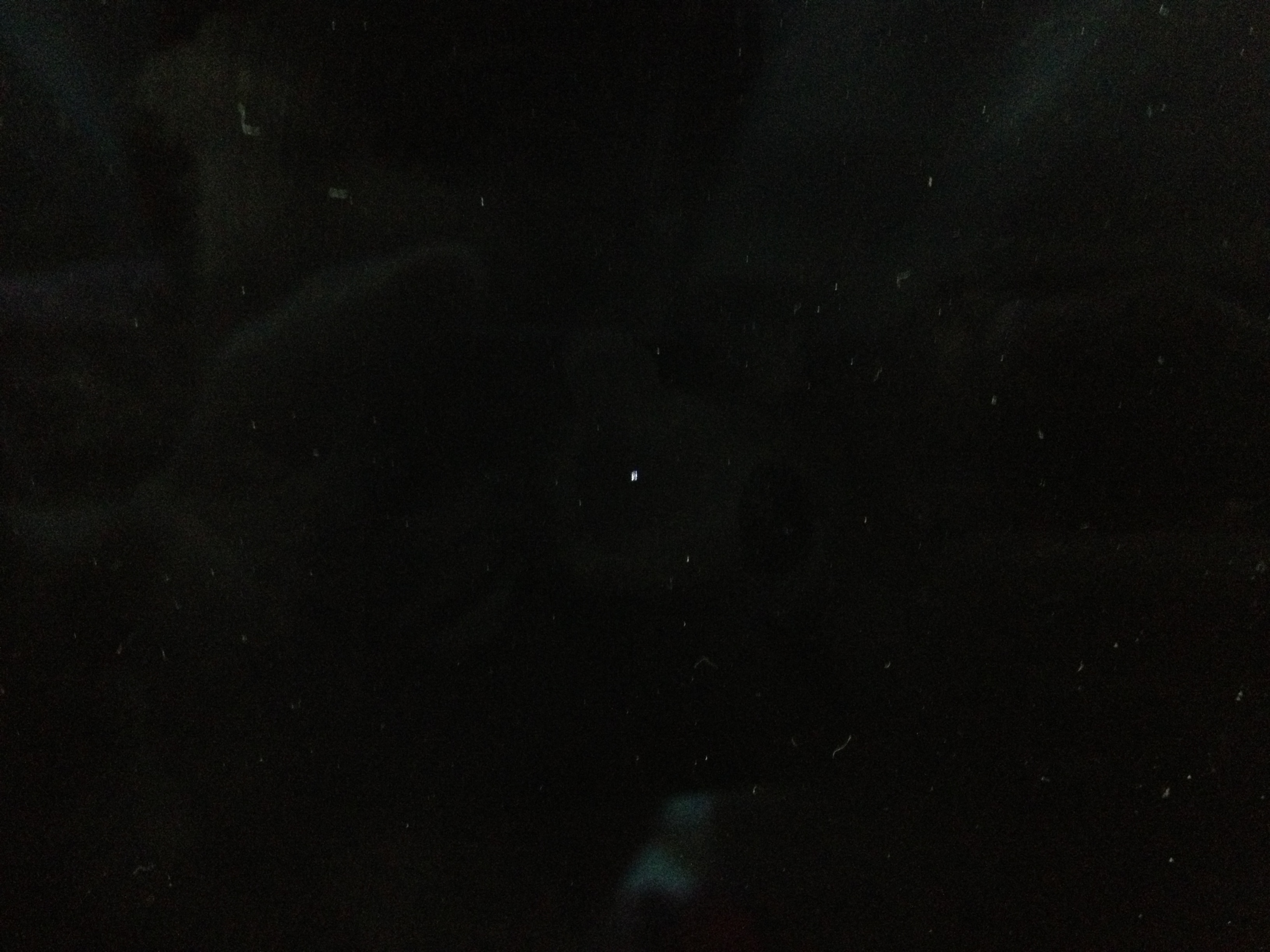

Today when I was studying writing programs. I noticed a small area in my 8 weeks old rMBP, with color dropped. I've seen it with other point of view, thus I noticed that area was a hole. Can anyone tell me how to resolve this case of problem? I remember I have brought a protector plan. Can I send my rMBP to apple to repair it? or change it? advance thanks for information. 🙂
Call apple, they will know if they can help you or not.
Here you are.
another one is too big. = =
I just return to my home after finished the programming studying. I will take my macbook to apple tomorrow.
However, today I have noticed 2 holes more! Can't just believe that these holes is my fault. It's exactly like the first one. What do you think about this? I'm quite worry now. 🙁
