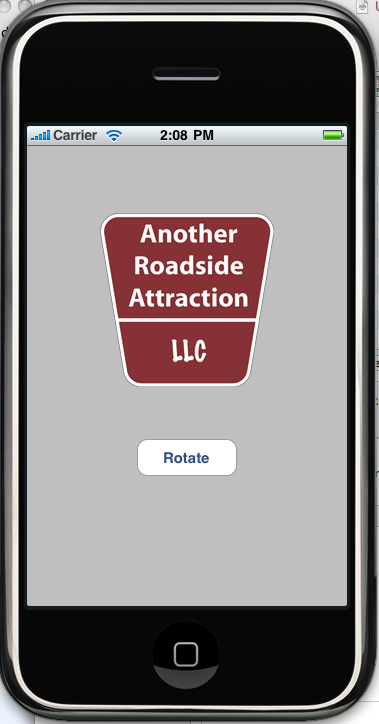

Well, I was able to get a continuously rotating image without the need for a thread or loop. Here's a starting screen shot and few code snippets to demonstrate (apologies for the lack of comments):

(I've left out some of the "logistics" code (IBAction, IBOutlet, static variable declares, etc.)
Basically, I'm rotating 180º till my image is upside-down and then kicking off another rotation to "complete the circle". I'm also changing the title of the button to Stop while rotating and Stopping... (disabled) until the rotation is complete.
