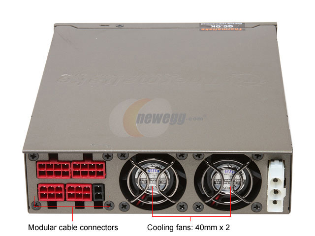

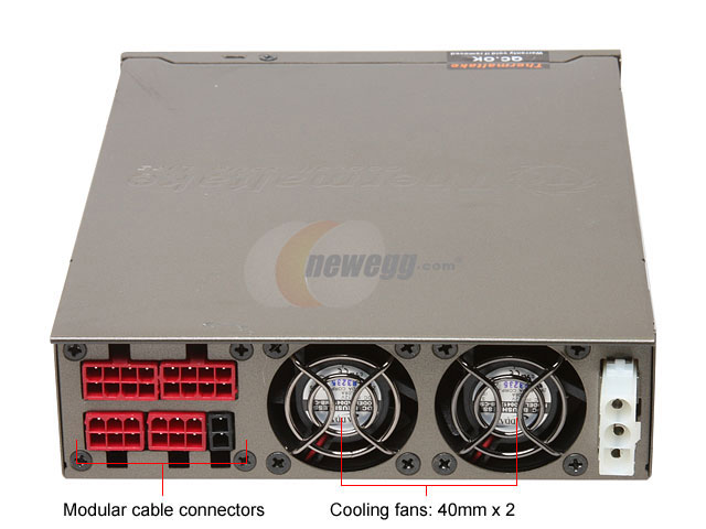

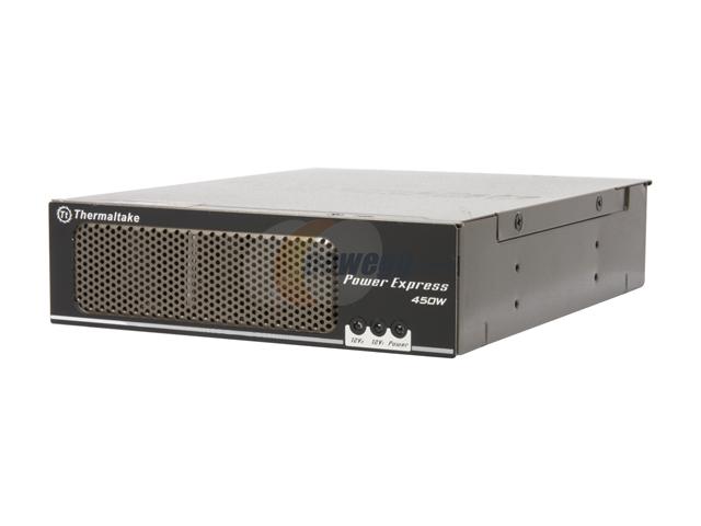

Then I thought about it and is there still Molex up there on the optical drive? Last I looked, it was SATA power and I do not know if you can convert SATA power to PCIe 6-Pin.
If I were to do it, I would use one of these to help me. Put one in an optical drive slot and dont worry about *ucking with the power supply.
That's one way to do it I guess, but that will be a lot a cabling to run to/from the drive bay (there may not be enough space in the case to run all those cables). You would need to run AC power to the drive bay to power this, then run the 6-pin PCIe power back down to the PCIe slots.
