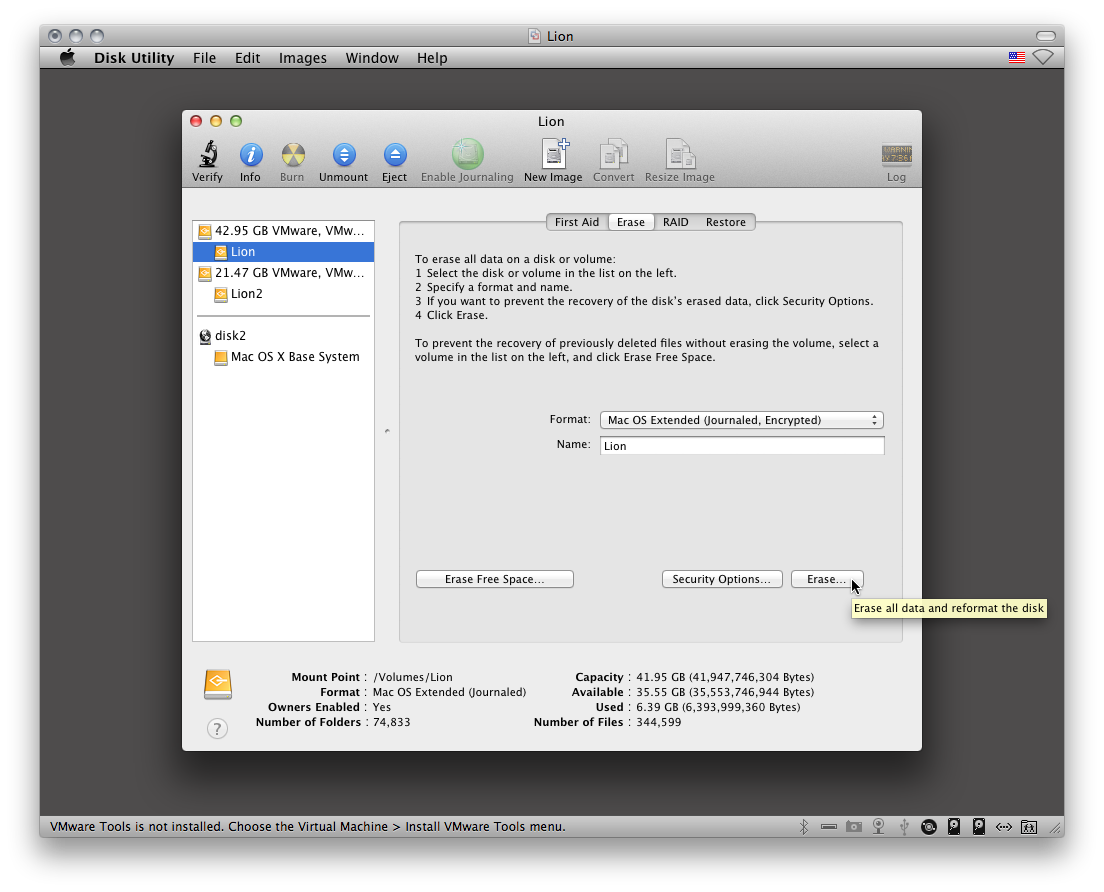

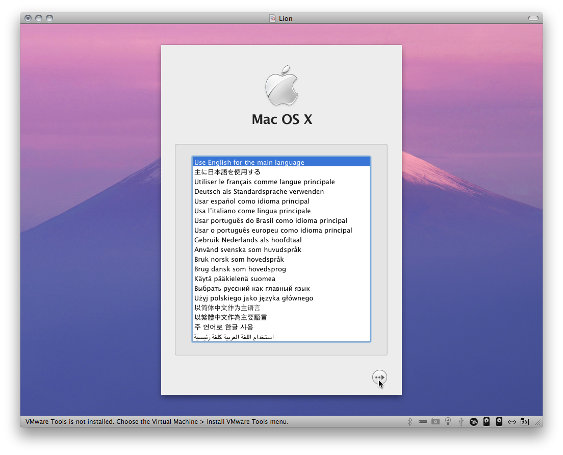

No manual available @ the moment, but some pictures from my experiments. This is the recovery system, and not a full version of Lion. As i explained it in my previous post, the full version can be installed over 10.6.6, but does not boot for various reasons.

Lion runs here in VMware, without obvious problems (yes, the full version).

I've a RL, and have not much time to write manuals. Parallels supports more OS X 10.6 or 10.7 features than Fusion? Great, i will try that if i have the time. My VMware Fusion Lion installation is still *very* experimental, unreliable and pretty "complicated". I need to reduce the necessary steps, before i write a manual.
