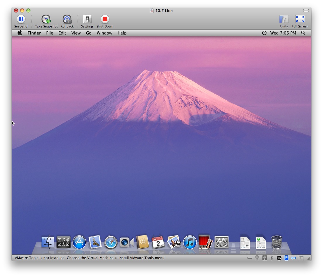

I followed along the instructions as closely as possible, buy my VM is hanging at the Apple logo and spinning gear upon startup. Switching over to verbose mode, I get the following output [see attachment]:
Any ideas?
Yeah, I figured that out...
Apparently my VM works because I originally had Snow Leopard installed and it initialized the nvram. I have an nvram file for download ... give me a second to upload it and I'll post the link here.
Okay, I updated my instructions on my site and provided a download link... http://www.obviouslogic.com:8080/solutions/lion-vmware
There will be another problem after the installation process is completed.. I'm working on the instructions for that as we speak.
UPDATE: Okay, instructions are done, hopefully it works for you all? 🙂

wow thanks mjtomlin that worked! i can now try out Lion 😀 this is my first attempt installing OS X in a VM.
i had already made the old style installer on an external to try on my hack and so just needed to restore that to a disk image. after the next steps i added mjtomlin's NVRAM file, rebooted and the installer loaded fine.
something to note was i thought the \ for the kernel cache location shouldve been a /, but wasnt and worked fine and the Hard Drive and CD settings were already set properly for me. after installing i rebooted and Lion loaded fine.
i installed VMware Tools to allow a larger resolution, but i see it doesn't support quartz extreme (note: to get VMware Tools to mount you might need to restart after VMware tells you to disconnect the loaded CD)
