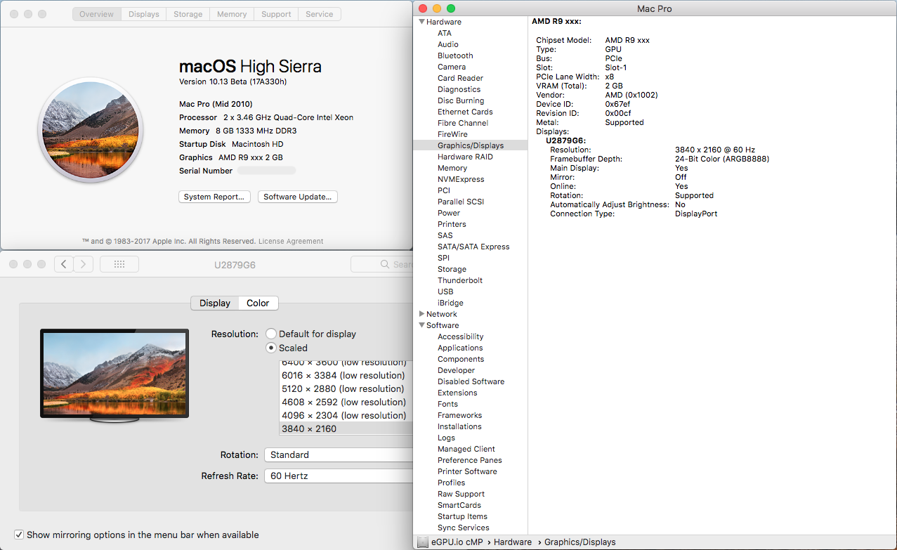

@nekton1 I believe it's unique to your setup. I swapped a Sapphire RX 460 2GB into my 5,1 and it booted right up. Full native support and works at 4K@60Hz. Scaling at lower resolutions is also working well.
Thanks theitsage. This is weird. A number of people (Rominator among them) have reported the RX 460 not booting in the 5,1 so I wonder what the delta is. The only difference I immediately see is that you are using a Sapphire 2 GB card while I and others are generally using the Sapphire 4 GB model. Could this be the problem? Whatever is stopping the 460 is minor because a Safe boot allows it to reach an unaccelerated desktop.

Totally possible, just like the 7970 3GB works fine in cMP, but 7970 6GB never work.

So if Apple does not fix the driver, perhaps flashing the RX 460 4 GB ROM with a 2 GB ROM would fix it! Or sell and buy the 2 GB! Can someone else with a RX 460 2 GB version of any brand confirm that their unit is working too?

High Sierra beta 6 booted fine, so maybe the problem is your card....?
