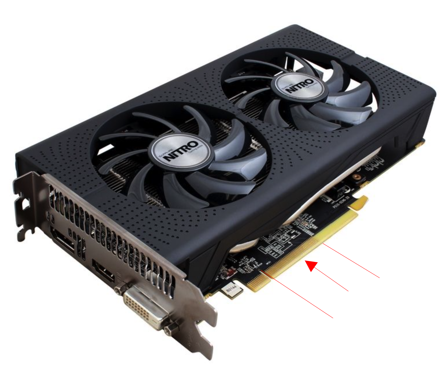

Also, System Info is showing PCIe Lane Width: x8. Card is in slot 1, nothing in slot 2, and its the only gfx card in there at the moment. That normal?
Synchro3
macrumors 68000
Jan 12, 2014
1,987
850
[doublepost=1489352880][/doublepost]
It's not a bug it's a feature: The RX460 has only 8 lanes:
