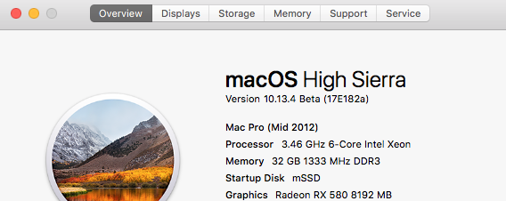

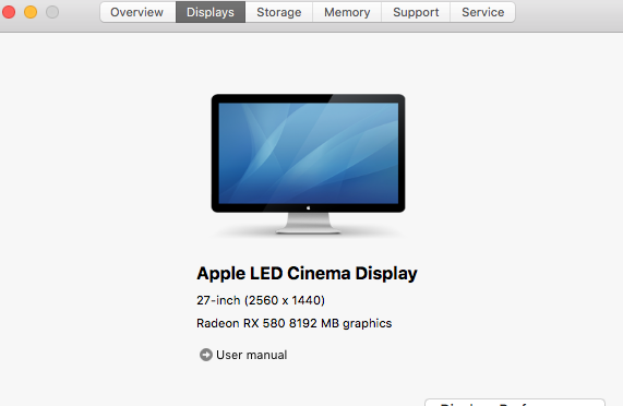

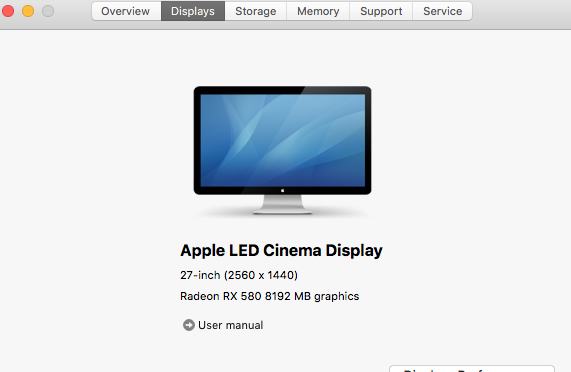

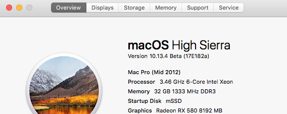

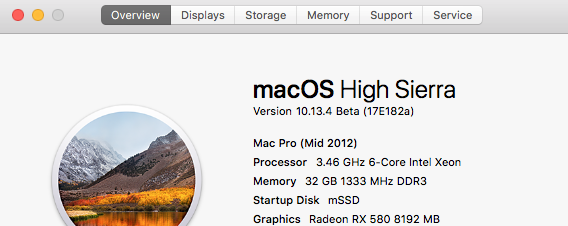

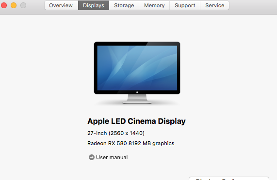

I'm beta testing High Sierra right now for both my eGPU setup and a RX580 in my cMP. If you can be a little more patient, the cosmetic name (and long running apple display icon bug) should be fixed in the next public release of High Sierra, along with some other enhancements. Not entirely sure on your 470, maybe someone else can chime in.
Regarding PCIe 1, no one has played around with bricking their cards to figure out what resistor will allow the Mac to see at 2.0 speed, if it's even possible. With the cost and availability of cards right now, I wouldn't advise anyone start trying. That said, I thought it was pretty well known that the real world speed difference between the two was negligible.
