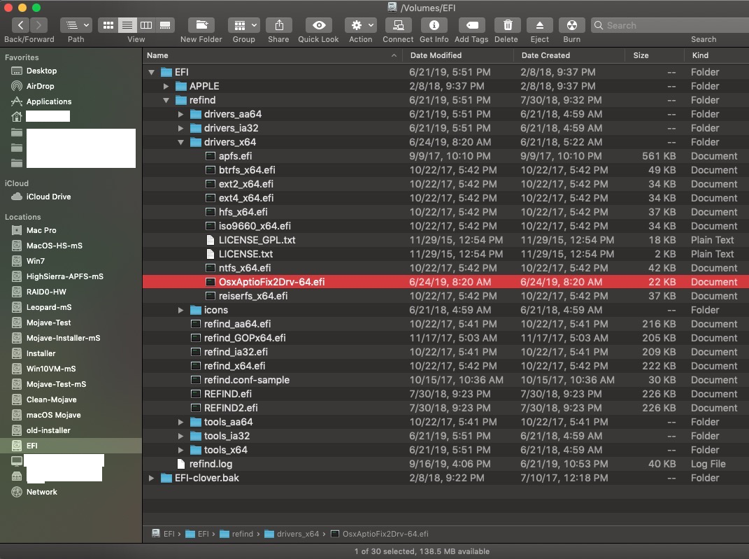

Mac-Pro:~ ludacrisvp$ sudo mkdir /Volumes/EFI
Mac-Pro:~ ludacrisvp$ sudo mount -t msdos /dev/disk5s1 /Volumes/EFI
Installed rEFInd with GOP support and added the highlighted driver for display support between the rEFInd boot picker and the OS splash screen (this gives things like verbose boot support / single user mode)
Get this version of rEFInd from here:
https://drive.google.com/open?id=1qrXbRiFIfqeqaxgmZ8tPGQn4PIdLL_Hh
Then add the OsxAptioFix2Drv-64.efi to the drivers_x64 folder.
I grabbed mine from here:
