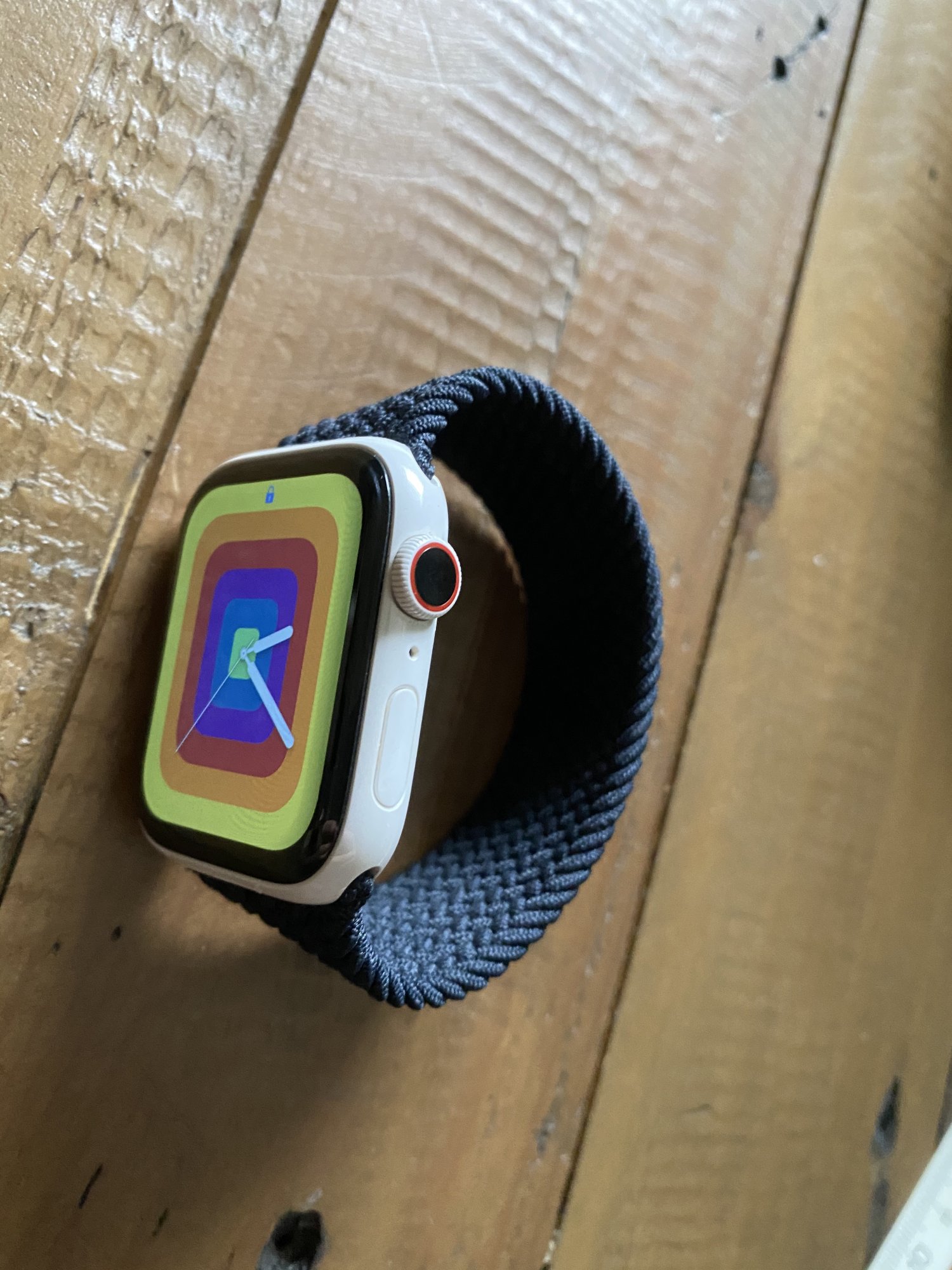

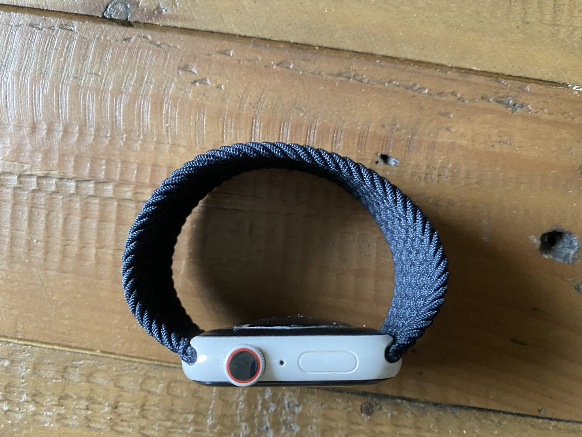

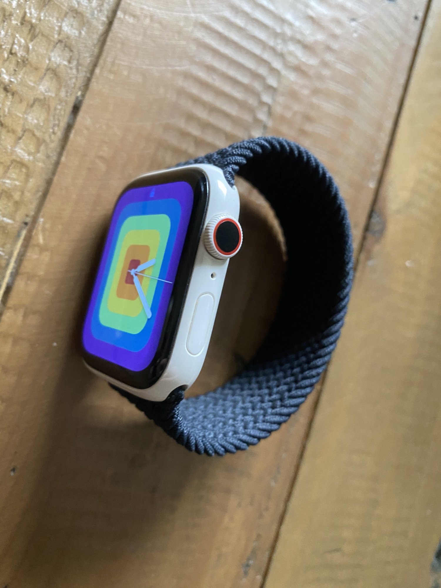

Looks too good with the pink braided loop. ♥️♥️

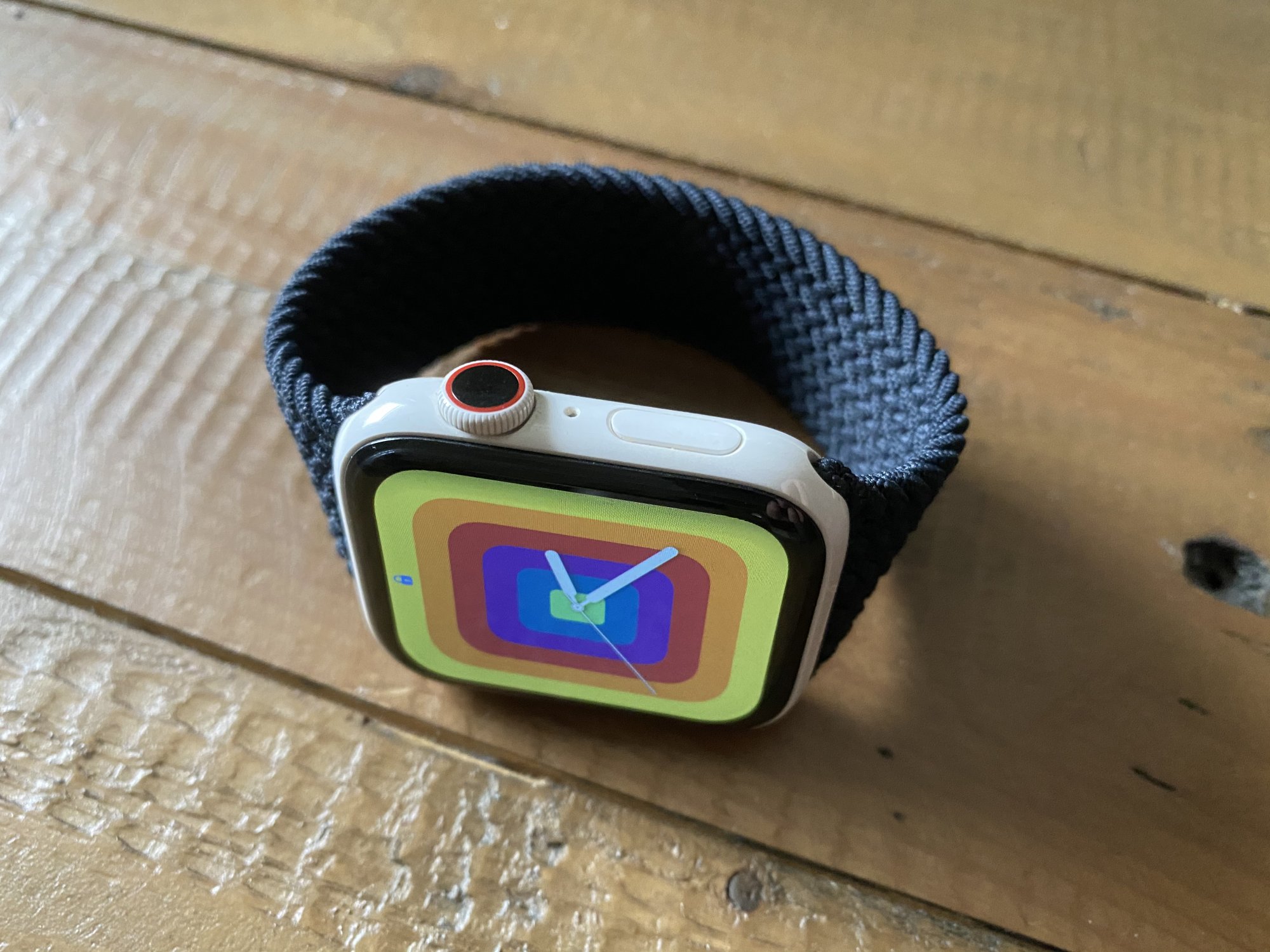

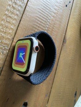

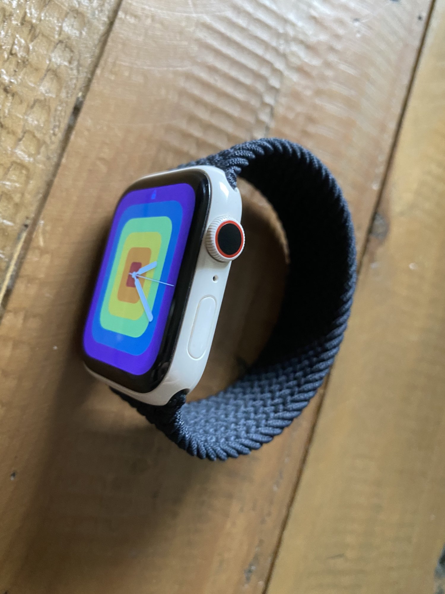

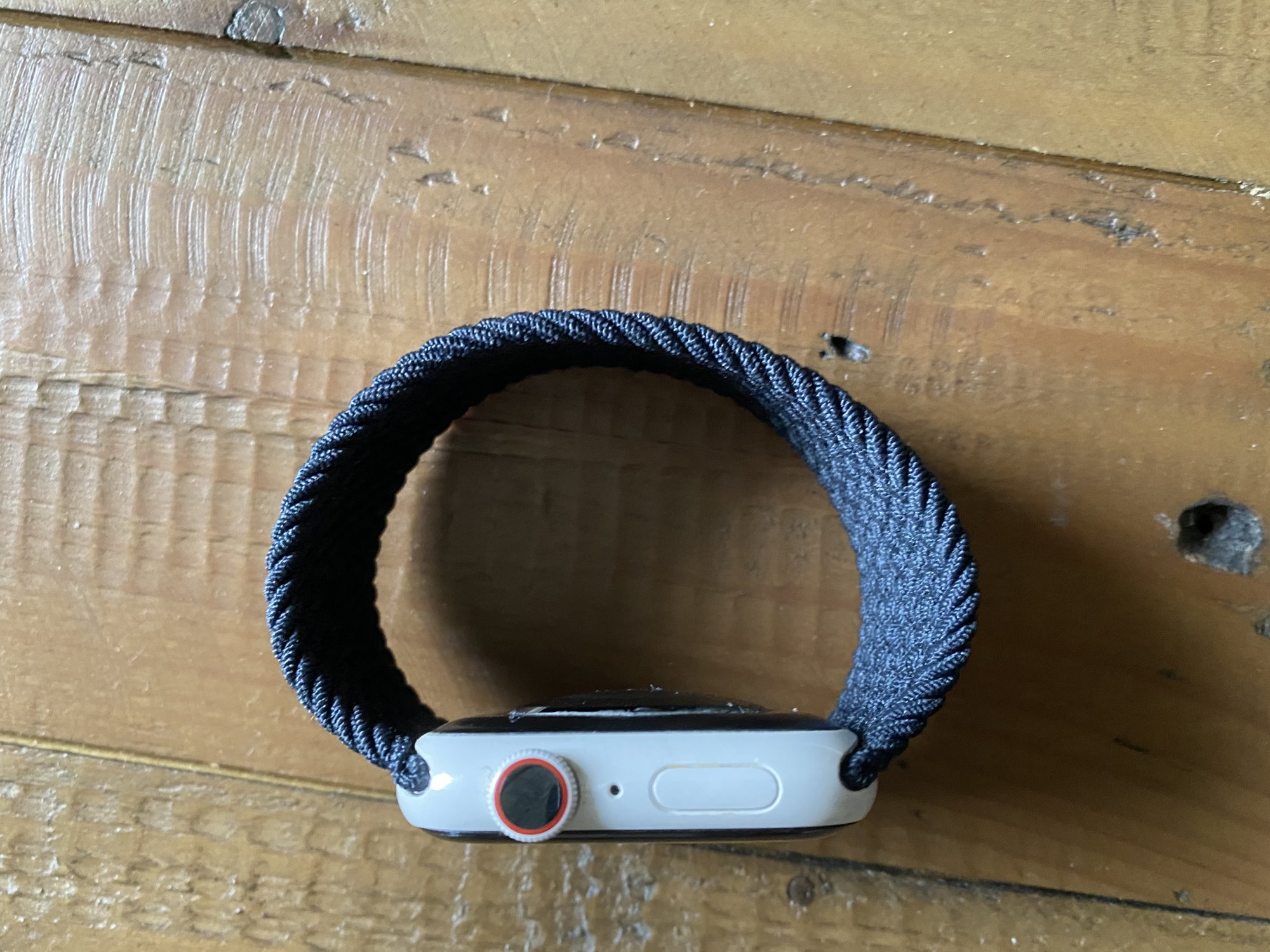

Just got the Braided Solo Loop in Charcoal from Apple today. Im Loving this combination, but i think i will get the same Braided Solo Loop Band in Inverness Green as well soon. This Band feels Amazing!

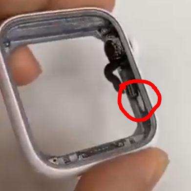

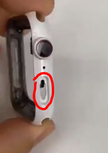

Does anyone know whether the ceramic case's pure ceramic or whether it's a ceramic-metal sandwich hybrid? Someone on Twitter gutted the ceramic watch and it looks metallic inside 🤯
That's actually disapointing. I thought it was a milled out piece of solid ceramic.

No metal insert is mentioned, and the included pictures show a ceramic internal- no metal components added for strength.
In other words... it's likely just a thin support there to screw junk in to. You can see in the button cutout that it's actually really thin. The ceramic is the majority of the thickness, and goes all the way to the bottom side of the button! Not to mention, Series 5 models still have that fat bezel, which points to an overly thick ceramic layer.
(Or maybe it's a coating... based on that book on the manufacturing process, it sounds like it would be pretty hard to stick a steel frame in there with such tight tolerances.)
