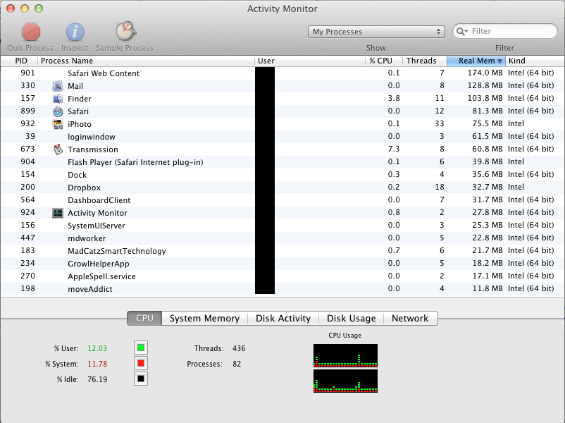

I've not noticed any memory leaks with Safari. With quite a few tabs open and having had the program open for a while, things are staying relatively constant. Sorry to hear some are having problems. =/
