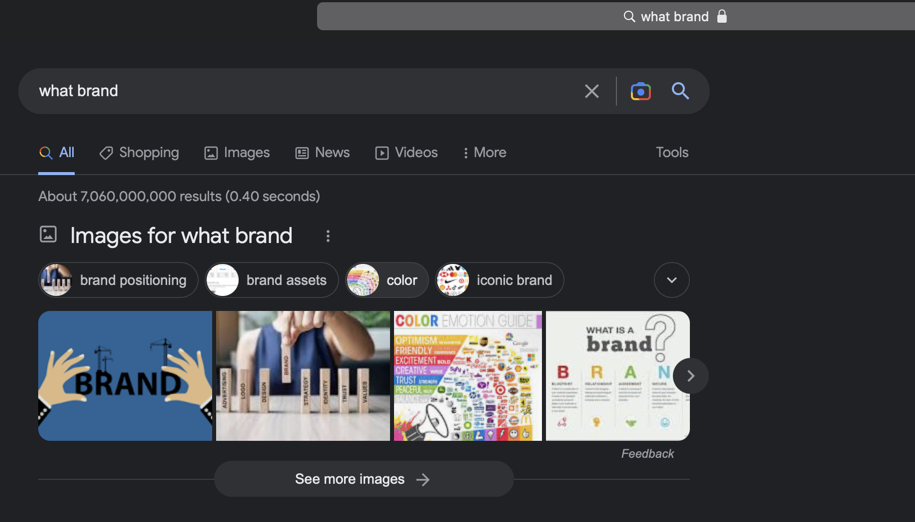

I just want to make sure you understand what I am doing when it crashes. In the address/URL box if you were to try and just type in "what brand" Safari will crash before you can type the n in brand.
I still get the same behavior with 1Password disabled.
macOS: 13.4 Beta (22F5037d)
Safari: Version 16.5 (18615.2.5.11.2)

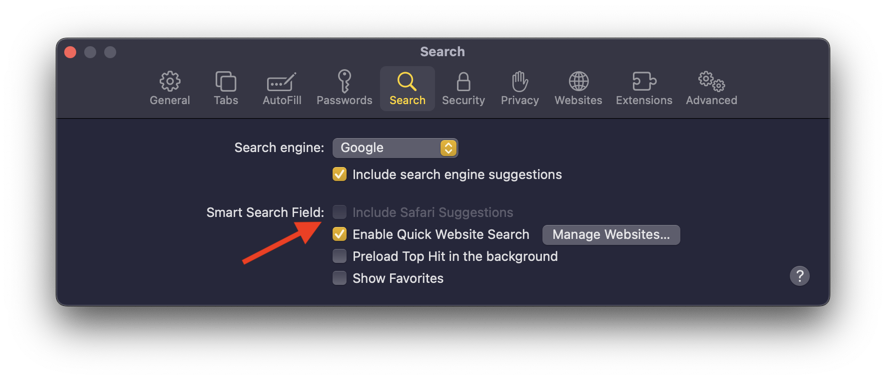

Turn off Include Siri Safari Suggestions under Settings->Search tab and it goes away. Not sure why Siri Safari suggestions is crashing on that phrase but it clearly does.

perhaps because i don't have siri enabled on my mac, i don't have a 'siri suggestions' option (just the 'include safari suggestions, which, interestingly, is unchecked and greyed out here...)
ok, but i was responding to the OP.
i don't have Siri enabled on my Mac either yet ALL the boxes are checked and active. Will disable siri suggestions and report back.
Edit: like you no Siri suggestions even available to check or uncheck. So, it appears the "include safari suggestions" is the culprit. I unchecked that and no crash when searching for "what bra".
hmmm, def greyed out here. i couldn't turn it on if i wanted to...
edit: this is on my M2 air. on my M2 mini, i can turn it on, but doing so still doesn't cause a crash when i type 'what brand....".... both macs are on the same OS. odd stuff

Include Safari Suggestions can be checked/unchecked if Siri is on.
"Include Safari Suggestions
Get Safari Suggestions as you type in the Smart Search field. Safari search includes suggestions from the internet, Music, the App Store, movie showtimes, locations nearby, and more. To learn more, choose Apple menu > System Settings, click Siri & Spotlight in the sidebar, then click Spotlight Privacy on the right. (You may need to scroll down.)"
https://support.apple.com/guide/safari/search-sfria1042d31/mac
