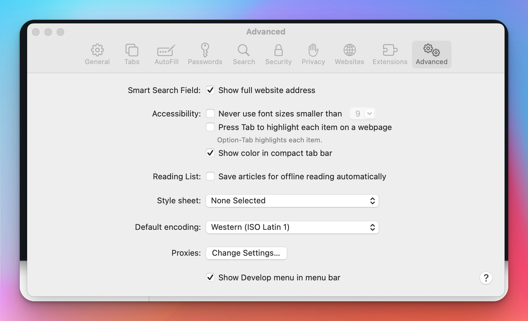

This started happening to me when I upgraded to Safari 15.5. I found a thread on the Apple forums from around the same time as the 15.5 was released which suggested turning off Dev Tools. A couple of people had noticed when they opened it that all their logins were getting reset.
Since turning it off I haven't been logged out.
Obvs, not a full solution as a wed dev I kind of need dev tools to do my job....
This was absolutely my problem. Since turning off the Develop menu, it no longer occurs. Thank you!
But as you say, it makes it a bit difficult to do debugging! For now, I've resorted to using Chrome for development stuff.
Absolutely 100% fixed by disabling the "Develop Menu" in Safari Preferences. Only problem is, as a developer, I now find myself having to toggle this on an almost daily basis. So annoying. I want the develop menu enabled, and I want my cookies/sessions to not be messed with Apple, please 🙂 pretty please 🙂

The "thing" that fixes the loss of cookies and sessions is the "Show develop menu in menu bar" setting on the Advanced page of Safari.
When that checkbox is off, the cookies/sessions are never lost
When that checkbox is on, the cookies/sessions are lost within a few hours.

I confirm the problem with cookies/sessions disappearing with a Develop menu enabled.
Moreover, I have had this problem at my Intel Macbook since I bought it more than a year ago. Actually I thought I broke something... So after buying a new M1 Pro Macbook I haven't copied any settings. Instead, I set up the system from scratch (mostly because of a different architecture tho).
M1 macbook started losing cookies right after I enabled the Develop menu today. I have not changed any options in developer menu yet, was using a Console only.
There's a solution: use Safari Technology Preview. This is the browser I was using for the whole past year (solely because of missing cookies in a regular Safari). I hope to get a fix without Technology Preview.

I have the exact same issue. It's been bugging me for at least 3 months now.
If I make the "mistake" to turn the developer mode on, I will randomly loose cookies on most of the sites I've logged in.
It's definitely a bug since when you turn off develop mode, it won't loose any cookies.
