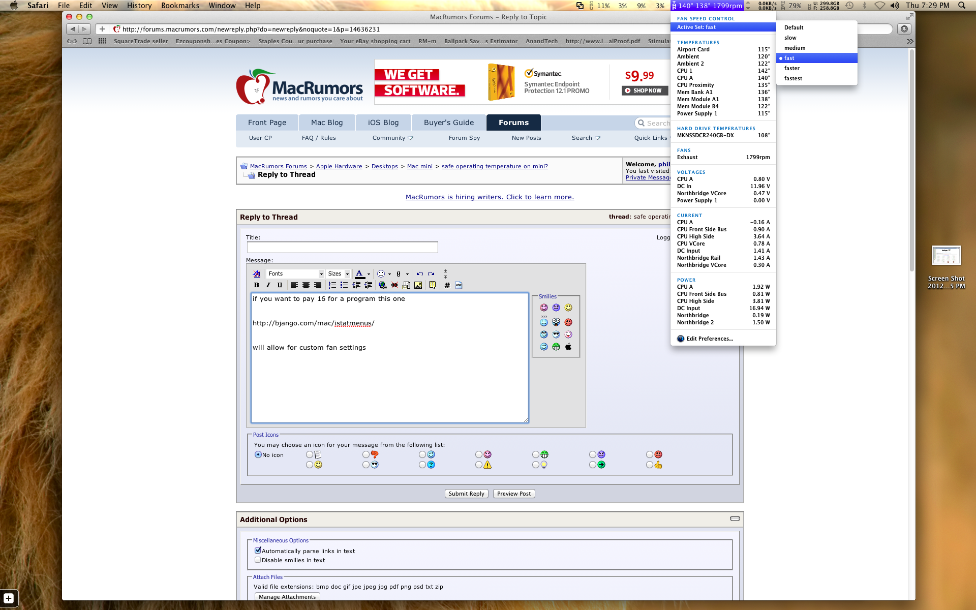

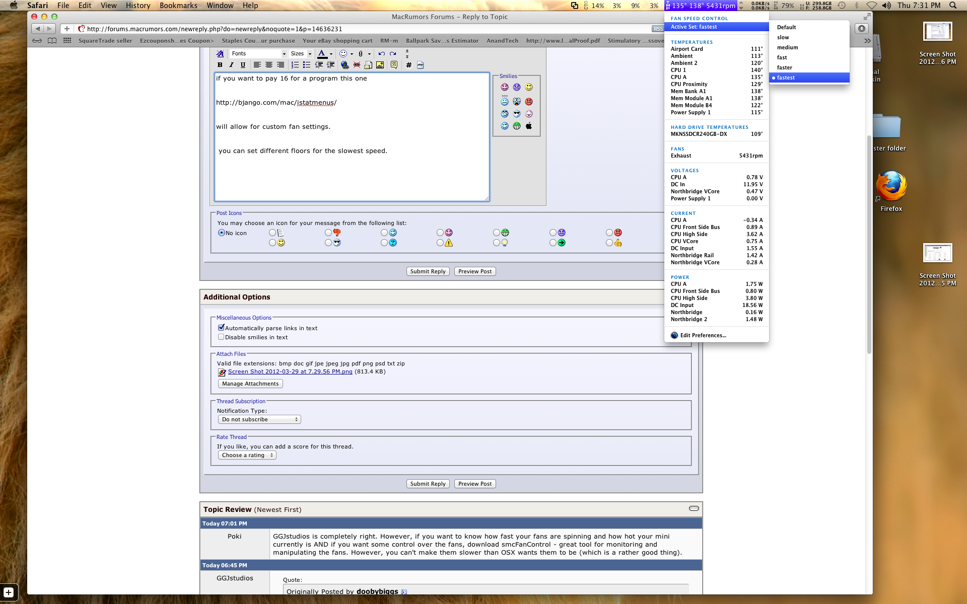

if you want to pay 16 for a program this one
http://bjango.com/mac/istatmenus/
will allow for custom fan settings.
you can set different floors for the slowest speed. look carefully at the screen shots and you can see i set 1800 to 5000 plus in under 2 minutes actually in under 30 seconds. there are a lot of free programs but the one I linked does more and does it quicker then any progam.
I don't recommend it to most users of mac minis. If you want to spend the money sometimes it is on for half price. at 8 bucks >
at 90c you are nearing the safe temp limit. 105c will shut it down in 15 to 25 minutes
