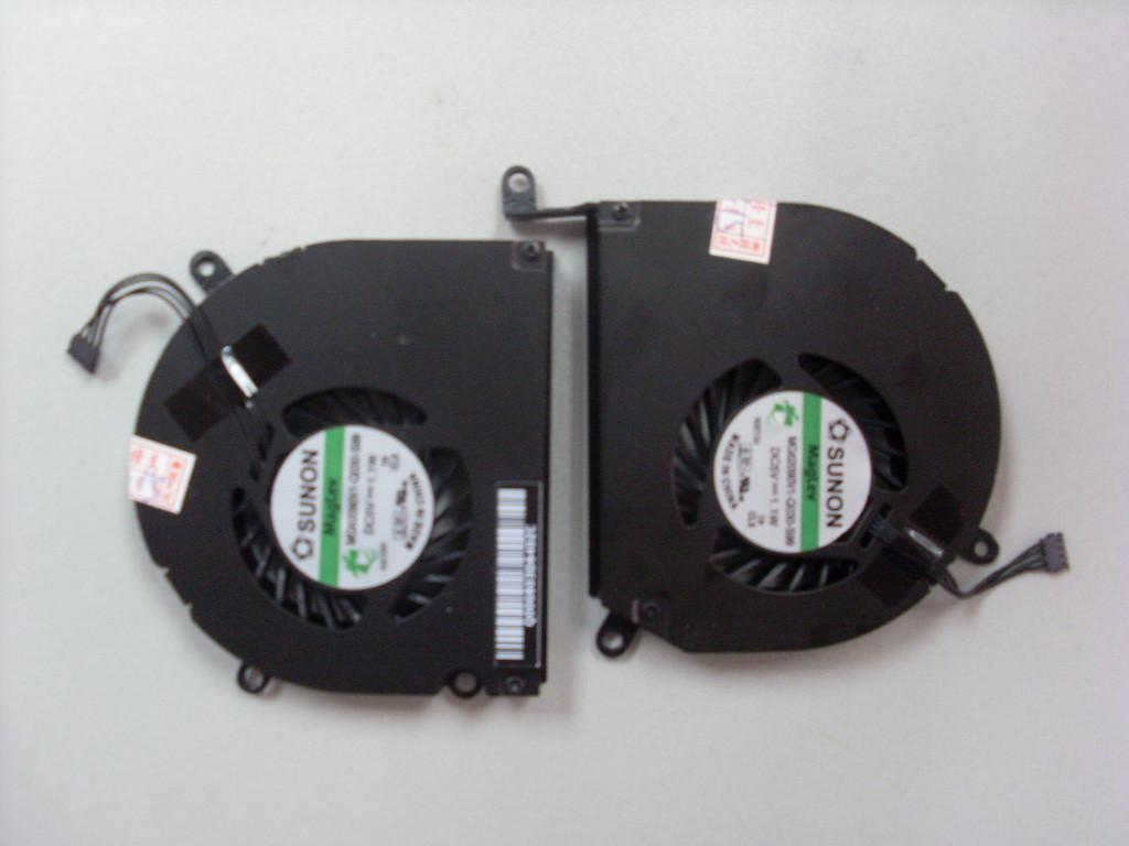

Alternately
under the sticker is the bearing you could probably lube it with a syringe and some oil.

I believe those fans are of the same lineage as the ones I had in my Early 2009 UB 17" MBP and use magnetic bearings. They don't require any lubricstion and trying to add any will result in a mess. The lubricant will attract dust like, well, a magnet.
I would just try and carefully blow off any dust that's collected on the blades and make sure the vents are clean (through the heat exchangers too). Removing the bottom cover will give you good access to the fans, etc.

Looking closely at the label, you'll notice the "MAGLEV" branding. That's Sunon's name for their magnetic bearing tech. Nothing to lubricste.
I've opened up some of those Sunon maglev blowers (not this exact model) - and they still had a shaft with a sleeve-type bearing that was actually lubed. My guess is to keep it in place during abrupt movement - so the blades will not collide with housing - and/or serve as a parking spot for when the fan is not running. It definitely did have oil on it, though.
I also have a high-pressure fan (also a Sunon blower type) - had 2 ball bearings on either end - but the data sheet also claimed this unit employed maglev technology. I chalked it up to blower using magnets to provide most of it's alignment - but not all of it.
