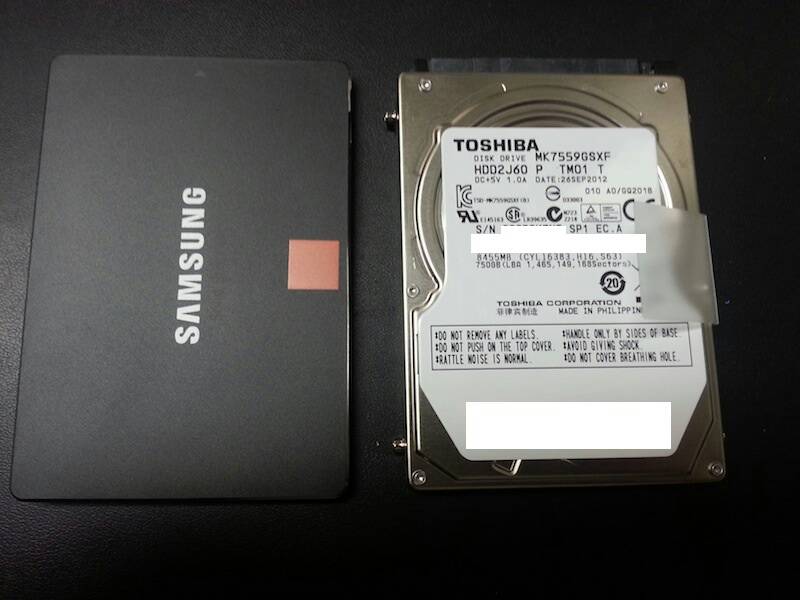

Just purchased a 256Gb Samsung 840 Pro SSD, and relegated the old mechanical drive to the superbay slot.
Best move I ever did.

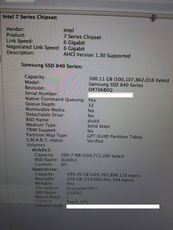

No matter what I couldn't get the firmware checked or updated
Both of my windows machines would not read the drives with magician
Wish the was a way to check the firmware at least. U would think it would have been on the box the drive came in
My best guess is it would need to open up my pc and use an adaptor for ssd to the ssd
I'm guessing it has the newest firmware. Hopefully

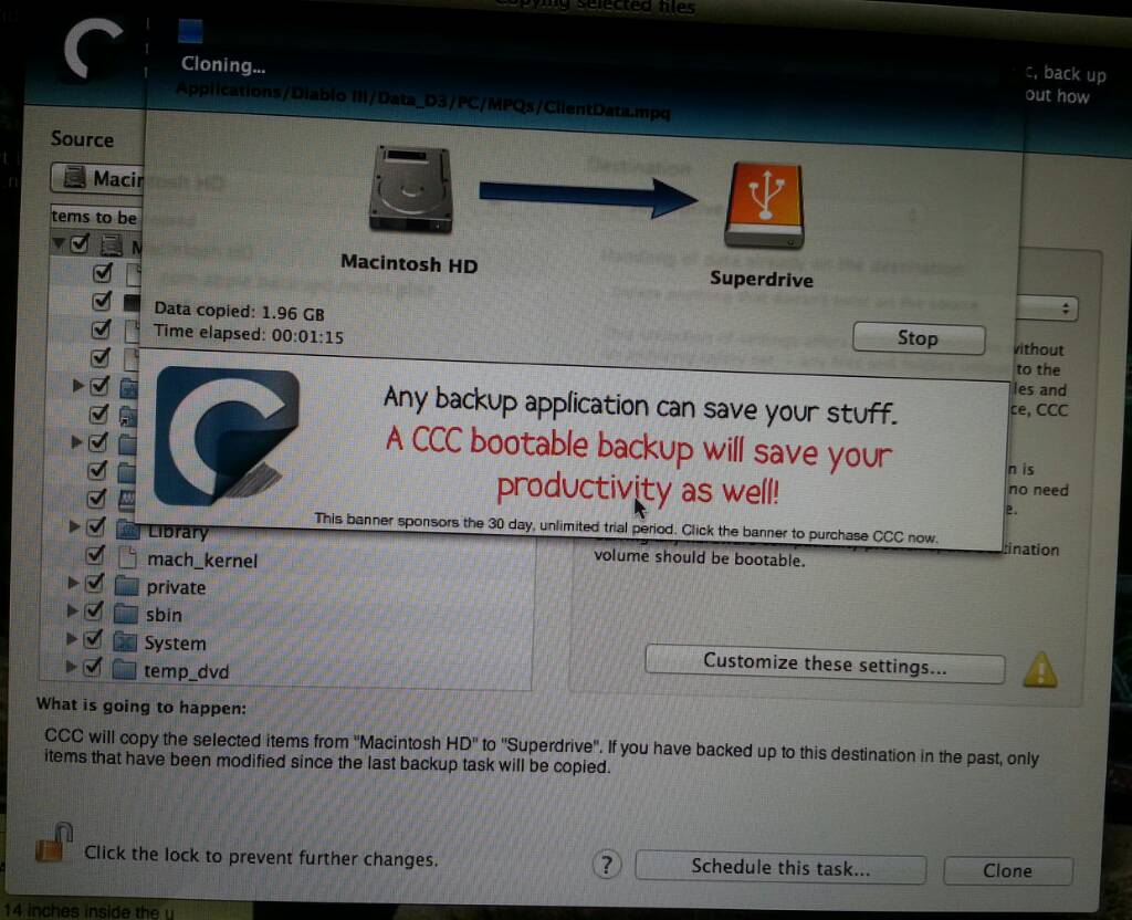

Started cloning

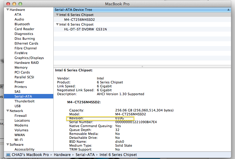

Once you install the drive go to "About This MAC" and check here....

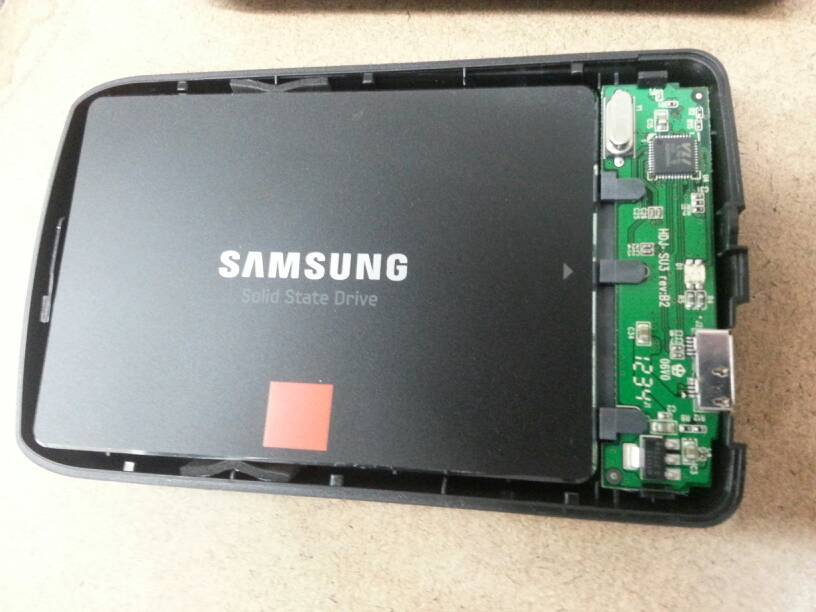

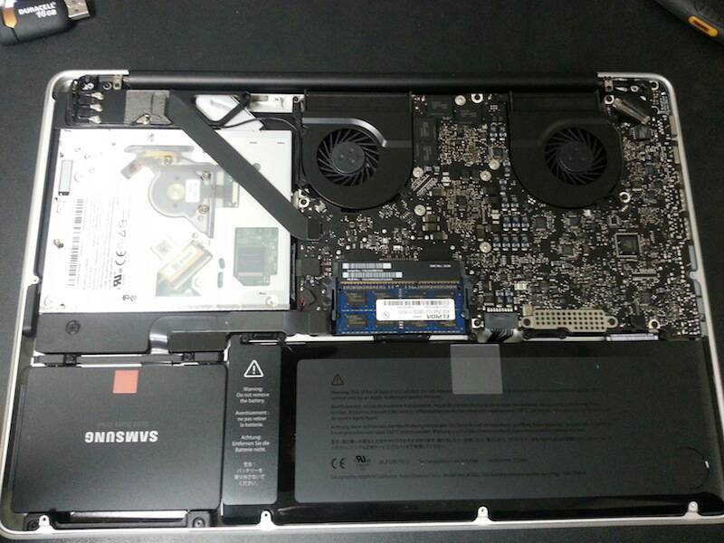

Pretty simple job
Cloned to ssd in usb3 enclosure
Swap drives out
Started it up

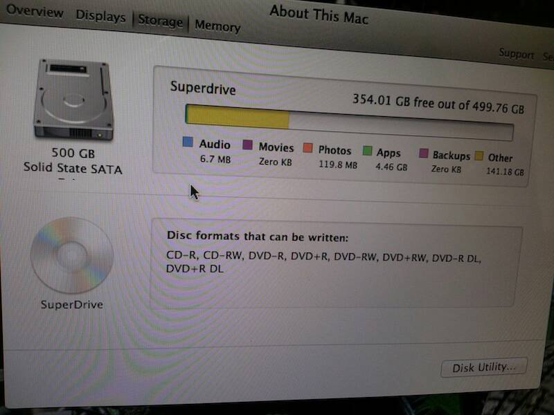

Whole thing with cloning took about 20min
All u need is a T7 torx and PH00 Phillips
Its like nothing happened. Computer wise. Clone worked perfectly. Only thing I had to do was set the desktop picture I had before.
Same thing happened when I restored whole computer with time machine. Just never kept the desktop pic on. Weird
Anyways it way faster and no noise.

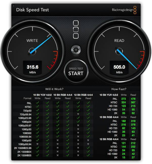

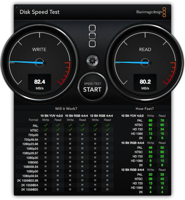

Before and after. This is not the pro model so the write isn't as fast
Now I have no idea if that's the newest firmware. Probably
i just put the original drive away. incase i need warranty or something. swap it back in so they can't refuse warranty

Cool numbers!
Next thing to do is enable TRIM and you might be able to squeeze a little more speed out of it 🙂
