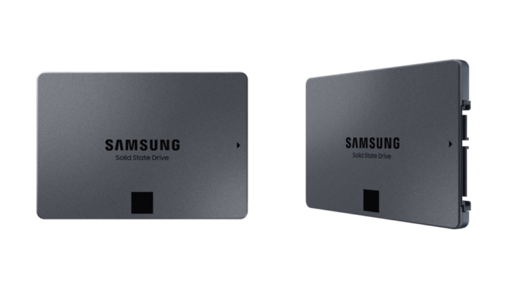

Samsung's first 8TB SSD for mainstream PCs is the 870 QVO
Samsung Electronics Debuts Industry-Leading 8TB Consumer SSD, the 870 QVO

I thought the T portables were based on the 860 EVO SSDs not 860 (now 870) QVO ones?
The T9, as of now, is an imaginary product. Samsung has trademarked the name, but the T7 was just released.
I know that, but that's not really the point I was making either.
Would Samsung trade performance for capacity in this imaginary product? I'm doubtful.
