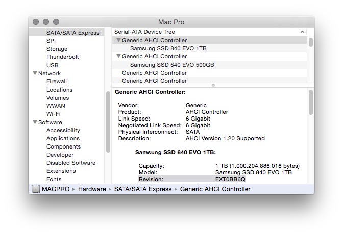

1. How can I find out which firmware version my SSD is?
2. Is the firmware update really necessary for "regular day to day use"?
3. Where to get the correct version?
^^ Apple logo > About this Mac > System Report > click on SATA. There you'll find all info's about your SSD! If you don't have the latest firmware, read this thread for information about the update and how to update yours.
