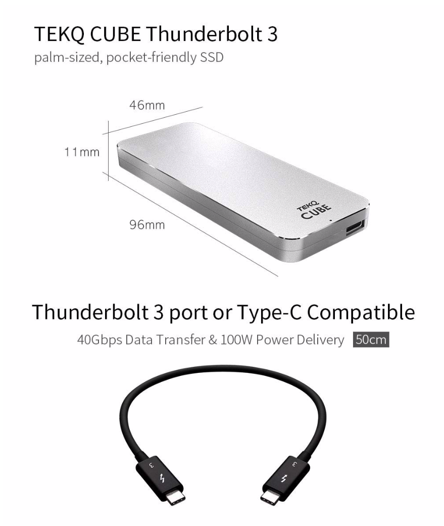

I just ordered TEKQ’s new Cube Thunderbolt 3 enclosure, space gray, which Amazon says will be delivered tomorrow.
I chose this over Samsung’s X5 SSD/enclosure because I believe that it will do a better job of dissipating heat, which is a consideration given how I plan to use the drive. Because the Cube is made of aluminium rather than magnesium, I will have to be more careful about scratches and dents, unless, of course, I go for the hipster weathered look (see post #74).
I’ll be using Samsung’s new 970 Evo Plus SSD. One reason is that there are multiple, uniformly positive reports on using Samsung’s 970 series SSDs with TEKQ’s Rapide enclosure.
I’ll know tomorrow whether the Rapide enclosure has been redesigned for the Cube to make installation and removal of an SSD easier. I don’t mean to suggest that the Rapide is particularly difficult, but if the Cube is like TEKQ’s new USB-C Gen. 2 enclosure (see post #70 videos) it’s going to be very easy. This has a bearing on how I use the enclosure going forward.
I still think that the price will come down $20 to $50, but I’m ready to make a decision, and everything that I’ve read about TEKQ enclosures suggests that they are of excellent quality. Also, TEKQ specialises in Apple hardware, and its enclosures have a reputation for playing very well with macOS.
I’ll admit that part of my thinking is that if I’m going to purchase a computer with a bunch of Thunderbolt 3 ports, I should use them. It doesn’t make sense to me to purchase a wickedly fast NVMe SSD, only to put it in an enclosure that guts its performance. That would grate on me every single time that I use the drive 🙂

Further to post #81, I've received TEKQ's Cube Thunderbolt 3 enclosure. The Rapide enclosure has indeed been redesigned. It looks like installation is just a matter of plugging in the SSD, adding a bit of thermal pad and joining the top and bottom of the case with four Phillips screws.
The design is very similar to the design of TEKQ's new USB-C Gen. 2 enclosure, the 583 SuperFast, which is shown in the videos linked in post #70.
As with the Rapide and the SuperFast, the whole enclosure is an aluminium heat sink. Like a Samsung T5, it fits in a shirt pocket with lots of room to spare. It's longer than a T5 (9.6cm/3.8"), but narrower (4.6cm/1.8"), and a bit thicker (1.1cm/0.4").
Unless I'm missing something, it will be extremely easy to change out SSDs.
Included in the box, in addition to the two halves of the enclosure:
Phillips screwdriver
Four Phillips screws
Thermal pad (6cm x 2.5cm / 2.4" x 1")
Thunderbolt 3 cable (firm fit at both mini and Cube ends, 50cm/20")
Drawstring pouch to hold the Cube and cable
I'll be using my own screwdriver and picking up some spare screws and thermal pad.

Following on the post above (#83), I've installed a 1TB Samsung 970 EVO Plus in the TEKQ Cube.
As a first test, I copied 171GB of audio and video, consisting of a few hundred files, from my 512GB internal drive to a Samsung 500GB T5 and to the Cube/Samsung 970.
With the T5, the copy took 8 minutes.
With the Cube/970, it took 2.5 minutes.
I'm planning to do more rigorous testing (I didn't even have the Cube screwed together when I ran the test), but this is very encouraging. There are a number of people on this forum who suggest repeatedly that there is no real-life speed difference between, for example, a T5 and an X5. I can only assume that these people have not actually tested that proposition. Some will conclude that differences of this magnitude don't matter to them, but that is a different question. If one holds that view, a T5 or similar is certainly less expensive.
Personally, I do want this performance, and so far I think that the Cube is worth what I paid for it. The enclosure is very well made. The Thunderbolt 3 cable is a useful length (50cm/20”) and also appears to be well made. The cable alone is worth US$40, and it is clearly better quality than the TB3 cable that came with my fairly pricey Asus graphics card enclosure.
In other words, while I have said twice, without having seen the Cube, that I think that the price will come down by $20 - $50, I'm not holding my breath on $50.
