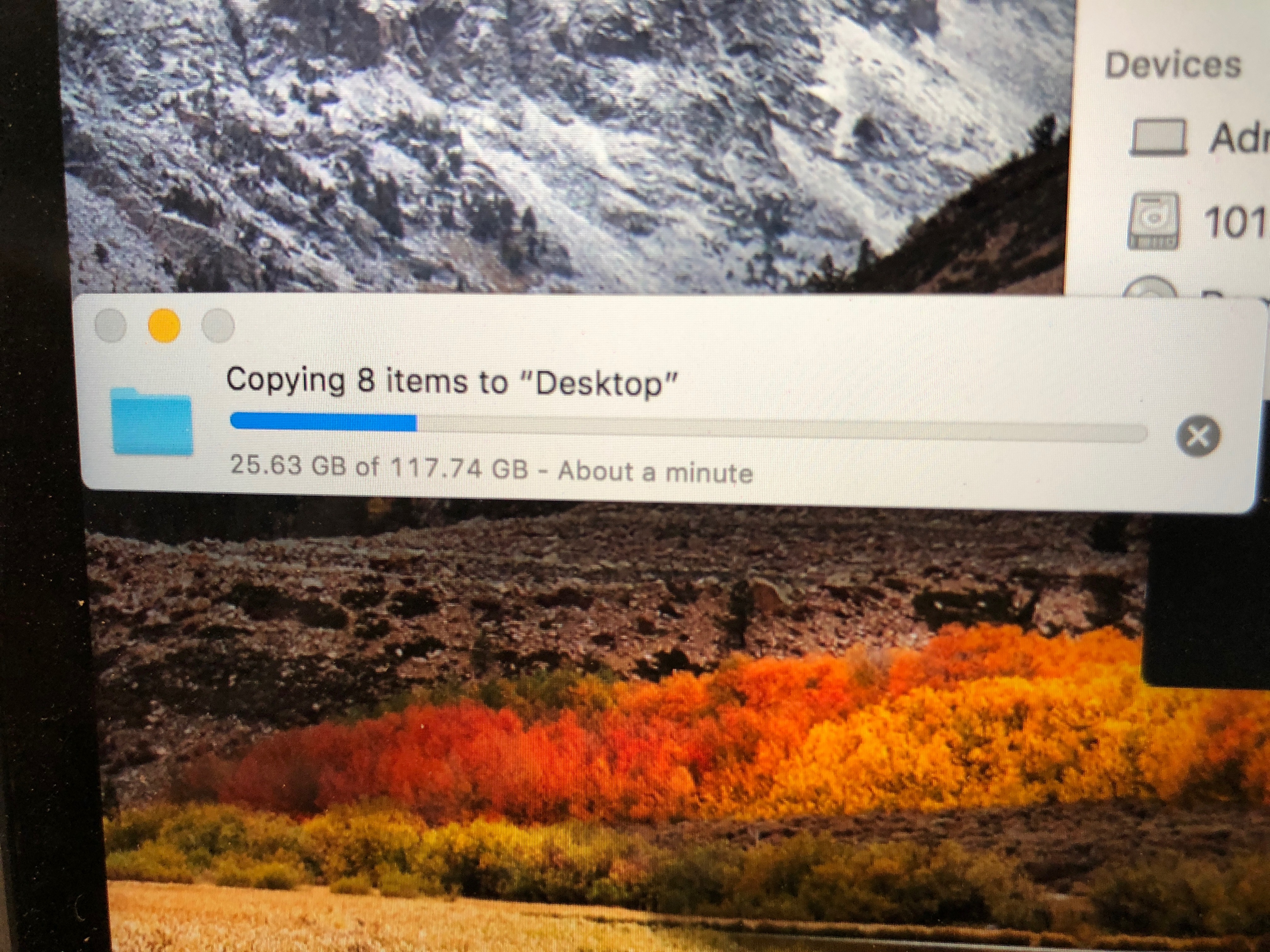

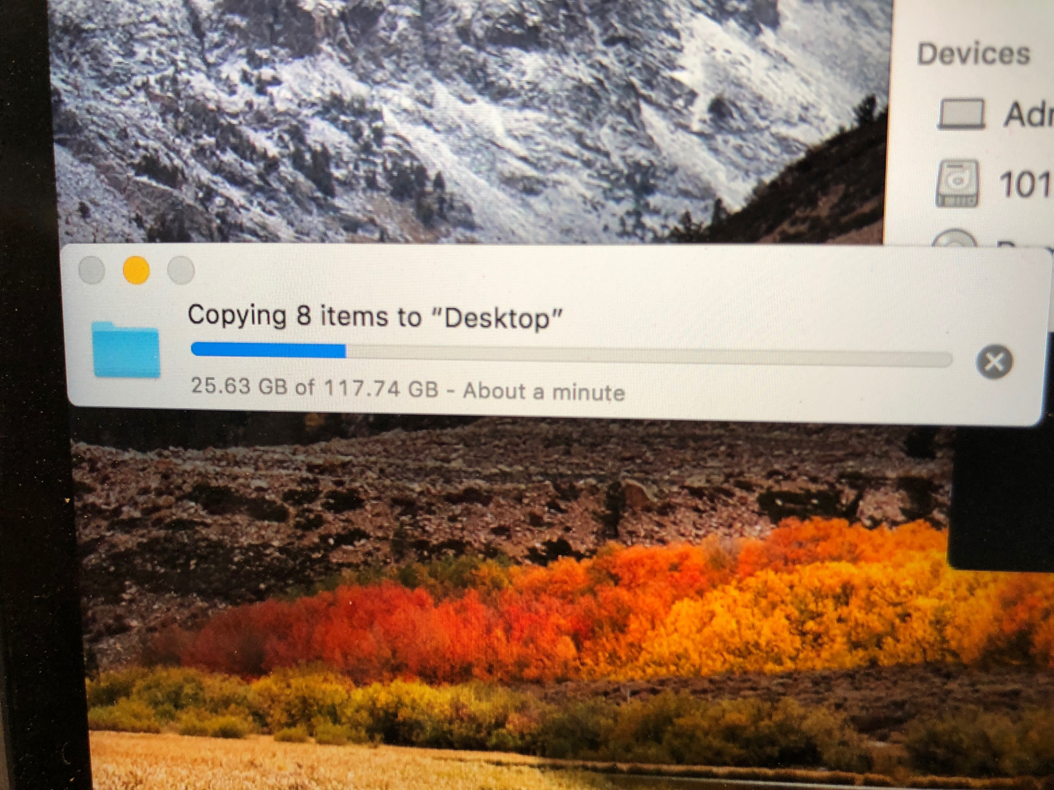

The fastest test of any of my devices:
- NetStor
- Requires AC adapter
- Supports RAID 0 / 1
- The following results however are with a single drive to a 15in MBPr 2017 ...
I've seen no problem with reliability.

PS
The transfer took ~ 45 seconds. Not a minute. DEFINITELY not over.
Under 50 seconds.
