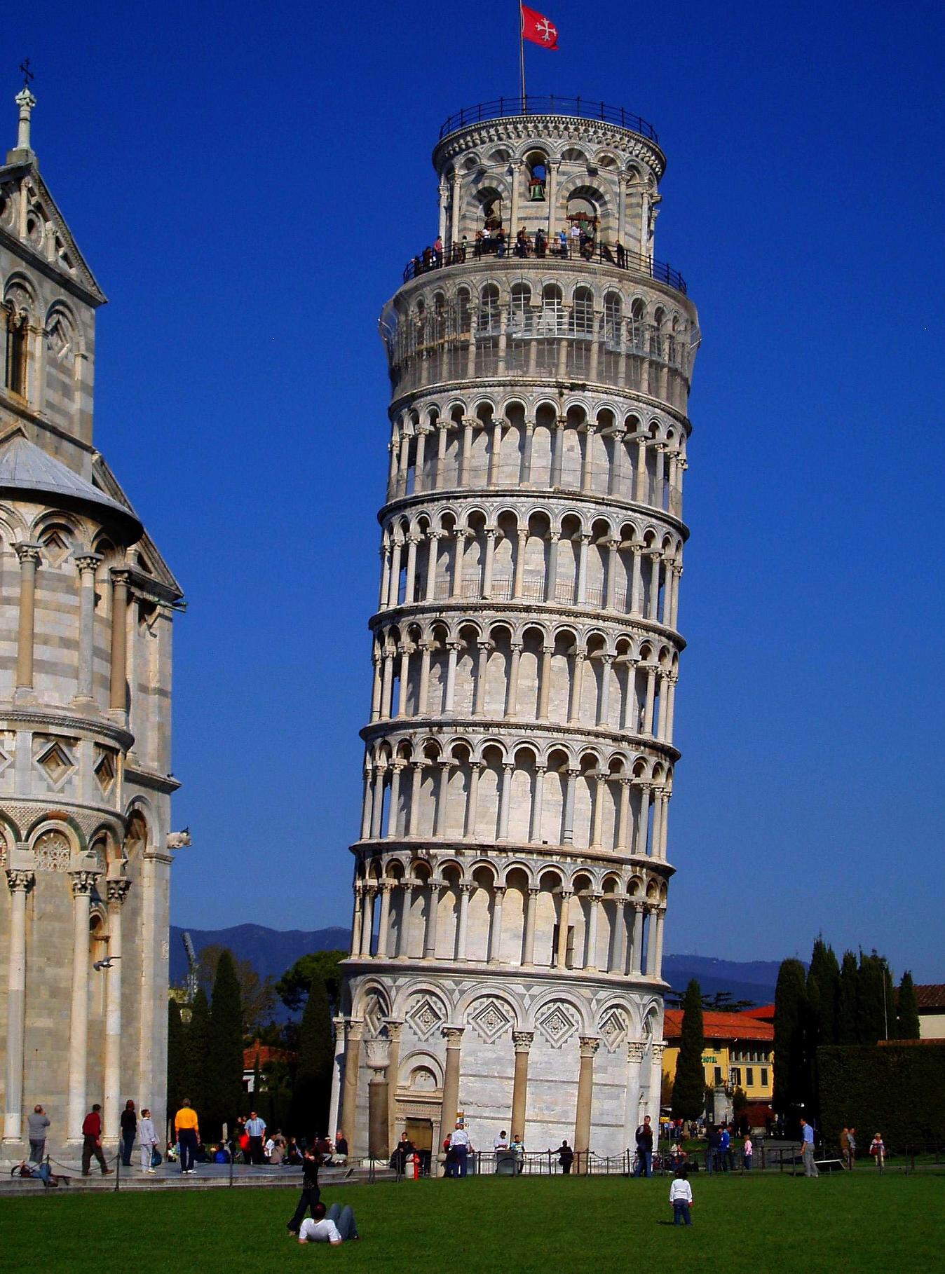

My guess as a non-engineer is that it might be correctable if they spend a boat load of money on driving down support to the bedrock if there is a technical capability. For all the work that was done on the Leaning Tower of Pisa, it is teeny in comparison, maybe 12 stories with a small foot print.

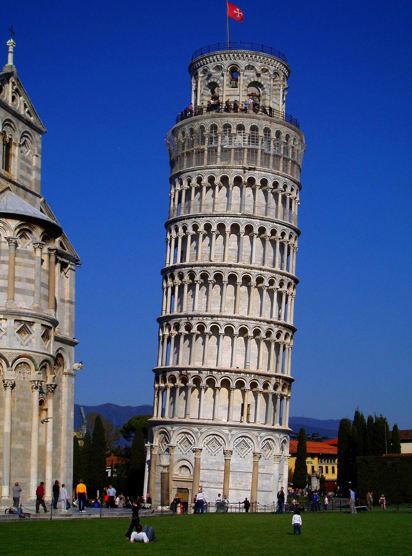

I think it's the same deal for Pisa, it was built on dirt, not on a solid foundation. I imagine this is a disaster for the buildings owners and financiers.
I should imagine it worked out well for Pisa in the long run!
