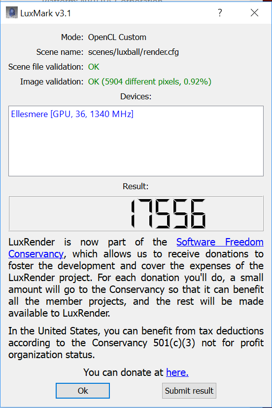

next iv been playing with mhz/voltage a bit
tests done in win 7 with heaven benchmark (my card is 68% asic may be worse for power use)
-no changes in wattman 1340mhz core i see 1.15-1.16v 160-180w
-wattman set to 1340mhz i see 1.15v 130-160w
-wattmam set to 1330mhz i see 1.137v 120-150w
-wattman set to 1320mhz i see 1.125v 120-150w
-wattman set to 1300mhz i see 1.05-1.06v 110-130w
in windows iv got wattman set to 1300mhz and it seems to load on restart & for me is much nicer (fans are much slower) so next weekend i may just re flash the bios with 1300mhz and see how it go's
maybe also try pointer 65284 at 1340mhz first to see if there's any change but im fairly happy and dont know if i want to spend ages playing around with this.
looks like i may be able to underclock better like i can in wattman if i spend more time but not shore it's worth it 😀
still looks like i cant push my vram past 2000mhz without errors but maybe that's linked to my card being used to mine before i got it 😕 or Samsung mem or idk

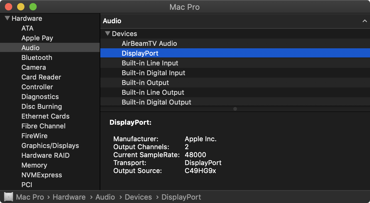

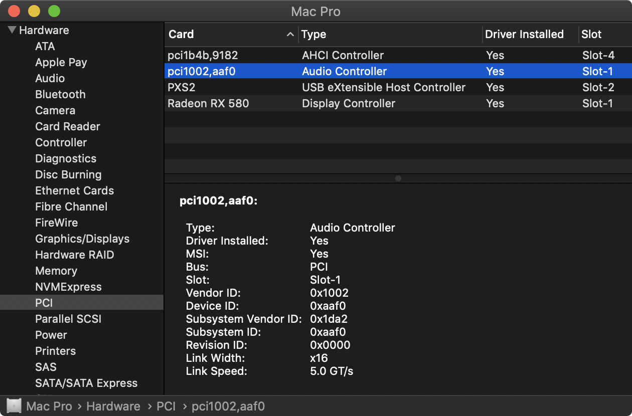

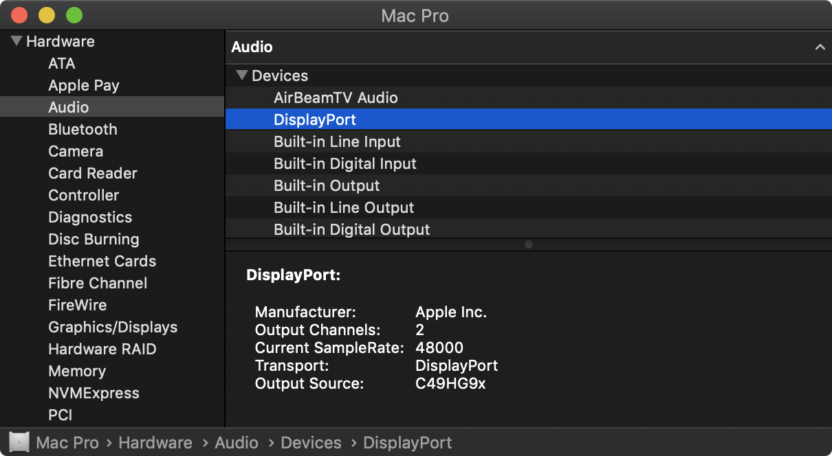

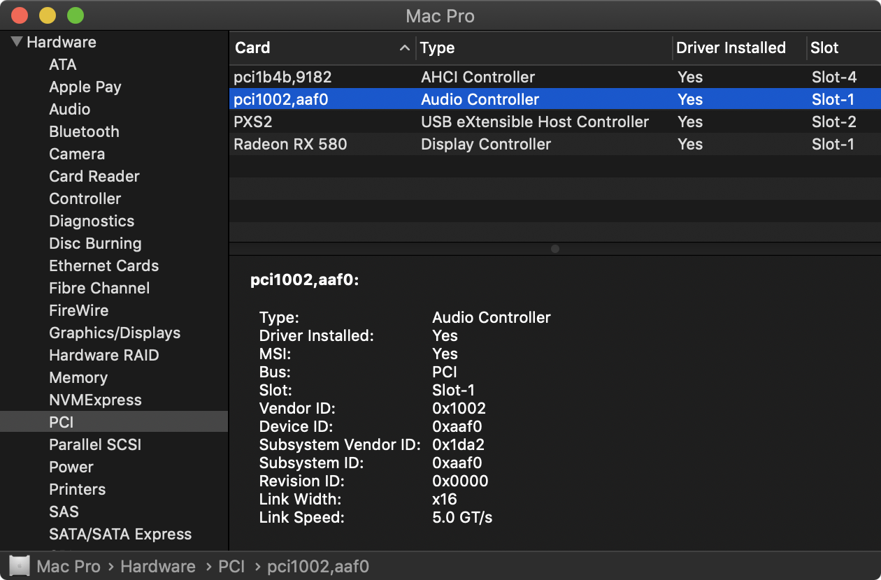

OK, so
Lilu.kext Version 1.2.7
and
AppleALC.kext Version 1.3.2
Will test it now
Update: Confirmed can work.
So, the procedure is
1) Disable SIP (in my case, I disabled Gatekeeper as well, not sure if make any difference)
2) Make sure HDMIAudio.kext is NOT installed. If it's installed, REMOVE it from the System/Library/Extension folder.
3) Make sure the AppleHDA.kext is NOT patched. If not, revert it (you should always make a backup of the original kext before patch it)
4) Download AppleALC.kext V1.3.2 (Link)
5) Download Lilu.kext V1.2.7 (Link)
6) Download KextUtility V2.6.6 (Link)
7) Unzip everything
8) Open Kext Utility (enter your admin password as required), it will auto perform some maintenance job, let it finish. You will see something like this
9) Drag Lilu.kext into the Kext Utility window. Again, enter password as required, and let it finish its job.
10) Drag AppleALC.kext into Kext Utility windows, enter password as required, and let it finish its job
11) Reboot
