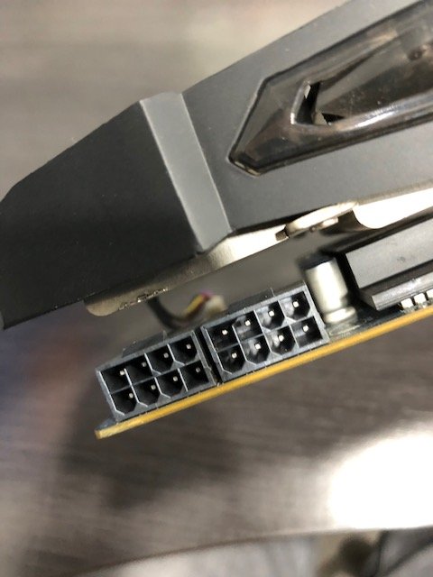

Hiall. I have just bought a radeon 7950 vapor x but I can´t see the way to supply all the power this card needs, with the 2 6-pin connections available in the motherboard. If I use an 6-8 pin adapter, as the card has two 8-pin power inputs, it won´t get enough power to run. I think this model has a power consumption of 500w.
I would appreciate if you could send me some information.
Thanks in advance.
Thanks in advance.
There are several ways to skin the cat. One of them is reducing the power :
https://forums.macrumors.com/thread...0s-with-internal-power-bios-provided.1733650/
The other is to use the 2 mini 6 ports to 8 port cable for powering the 8 pin on the card and the 2 sata power adapters to power the 6 pin on the card.
the 3rd way is Pixlas mod
https://forums.macrumors.com/threads/pixlas-4-1-mac-pro-mod.1859652/
Reactions: MIKX
ok thanks a lot. I think I will go for the second option, the easy one. Would these two cables be ok?:
https://www.amazon.es/gp/product/B07GPBRWDX/ref=oh_aui_detailpage_o00_s00?ie=UTF8&psc=1
The dual 6-pin to 8-pin plugged into the motherboard and to the first 8-pin connector in the card; and on the other hand the dual sata plugged to the sata connectors, normally used for the cd-drive and the extra sata port, and then to the second 8-pin connector in the video card. I don´t mind to sacrifice these 2 sata ports.
Would this configuration work?.
Sure. That one plus this:
https://www.amazon.com/gp/product/B06XKWSBPY/ref=oh_aui_detailpage_o01_s00?ie=UTF8&psc=1
Look, this is the card (pic of the power inputs attached):
https://www.pccomponentes.com/sapphire-radeon-hd-7950-oc-boost-vapor-x-3gb-gddr5
At the end in the specs, it says that two 8-PIN to 4 PIN Power Cables are included (adapters for PC I assume). If the original card is feeded in PC using this 2 adapters, it means that in all, the card only uses 8 pins (4 per each input power), doesn´t it?.
If you say that with the two 6-pin to 8-pin of the motherboard, plus the 2 satas, the card is over powered, then I could only used the sata of the cd-drive to feed the other 8-pin input of the card, instead of the 2 satas?. Would it be better?.

Hi.
I have flashed exactly that model of AMD HD7950 Vapor X. Now using in My MP 5,1and Mojave
I bought TWO 6 pin to 8 pin cables via EBay. Very cheap. ( about 7 euros both )
https://www.ebay.com/itm/Mini-6pin-...h=item466e51bad5:g:wqMAAOSw9gRZ7gq~:rk:1:pf:1
https://www.ebay.es/itm/Mini-6-Pines-a-8pin-Pci-E-Tarjeta-de-V%C3%ADdeo-Cable-Alimentación-para-Mac-Apple-Pro/253859023948?ssPageName=STRK%3AMEBIDX%3AIT&_trksid=p2057872.m2749.l2649
Use this procedure to install both cables:

Thanks a lot Enricote. Sorry, but I am consufed now. We were discusing about the amount of power the card needed to give the exact amount of power, anda I have been told to use also the sata power supply cables. How these 2 cables plugged in to the motherboard can supply enough power? both connectors on the motherboard only have 175w. I think the card consumption is higher, isn´t it?
[doublepost=1546093740][/doublepost]
In my experience as an user ( I have no technical knowledge) I have no issues using my MP and my flashed H7950 VaporX powered by Two 6 pin to 8 pin from motherboard. I use Lightroom, photoshop, Acrobat and Office in both Mojave and Windows 10.
I have no experience overclocking or using games or applications over stressing the GPU.
I simply followed instructions inside this forum to upgrade my MP to Mojave and flashing the GPU 7950
MacPro (early 2009). 4,1>> 5,1 - 2 x 3,33 Ghz 6-core Intel Xeon - 32 Gb 1333 DDR - AMD Radeon HD7950 VaporX 3072 MB - NVMe Samsung EVO 970 1Tb- AHCI SSD 250 GB - MacOs Mojave 10.14.2 - Windows 10
ok perfect then. I have just ordered the two cables to see if my card works as well as yours. Thanks a lot for your feedback.
