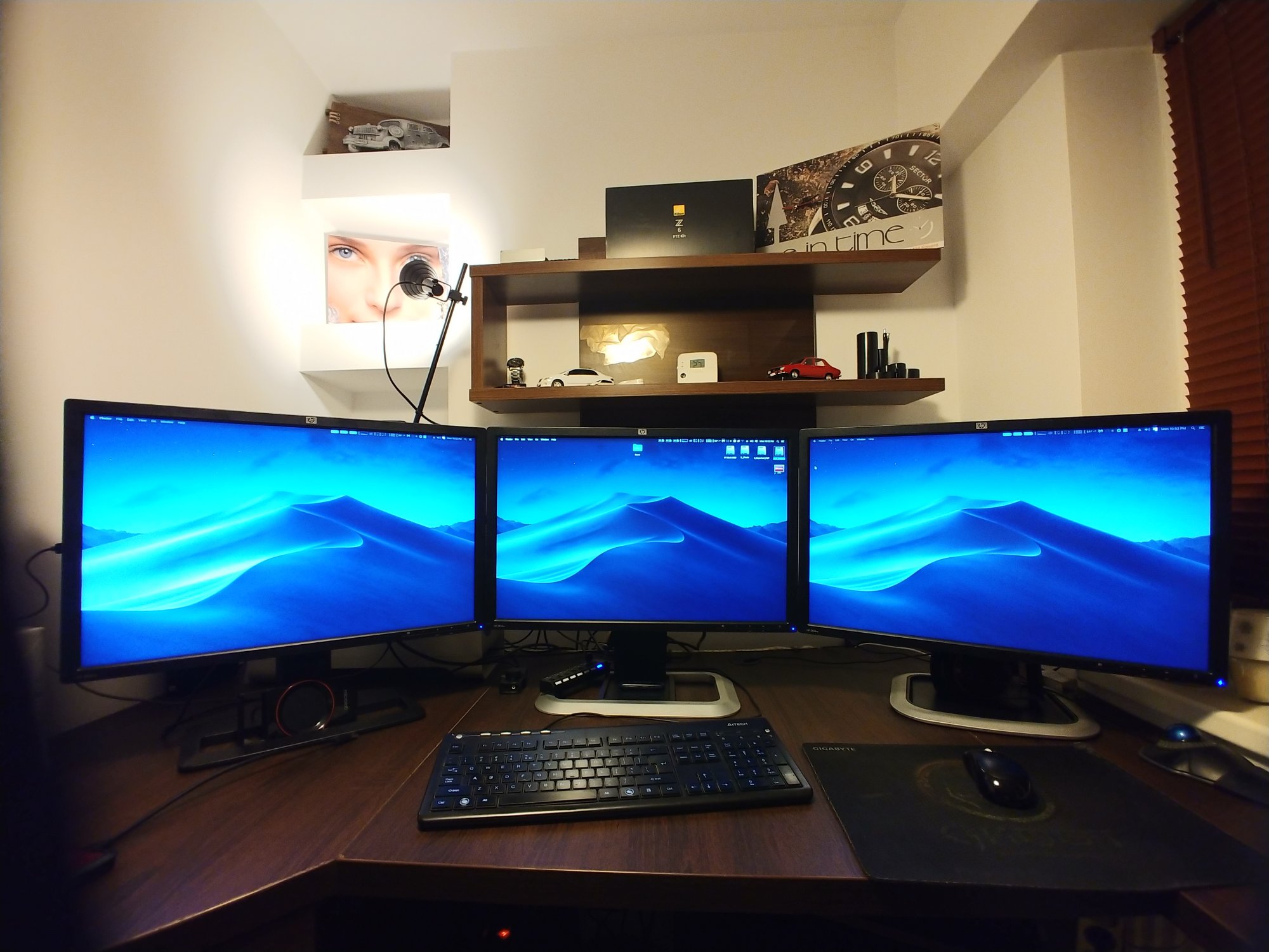

Guys, i never gona THANKYOU enough!!! Work perfect after i mahe a clone with Disk Utility! Look at this beauty... Again, Thankyou!

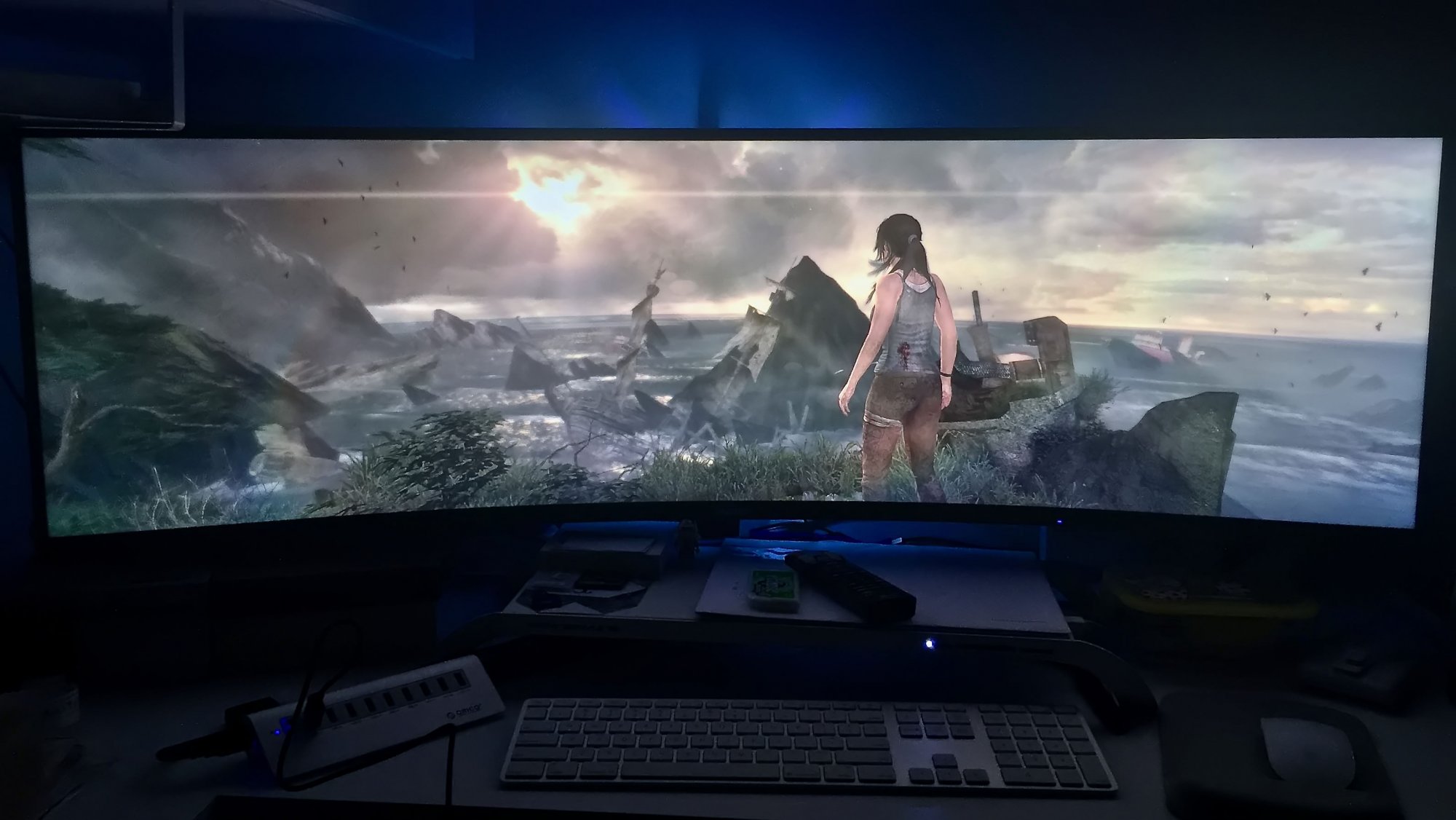

It should only be temporary as like h9826790 I want to run a single 5120x1440 display (hence the need to upgrade from the HD7950), but until I can afford that, I need to run my existing 3 monitors and just trying to establish how I will be best able to achieve that.
