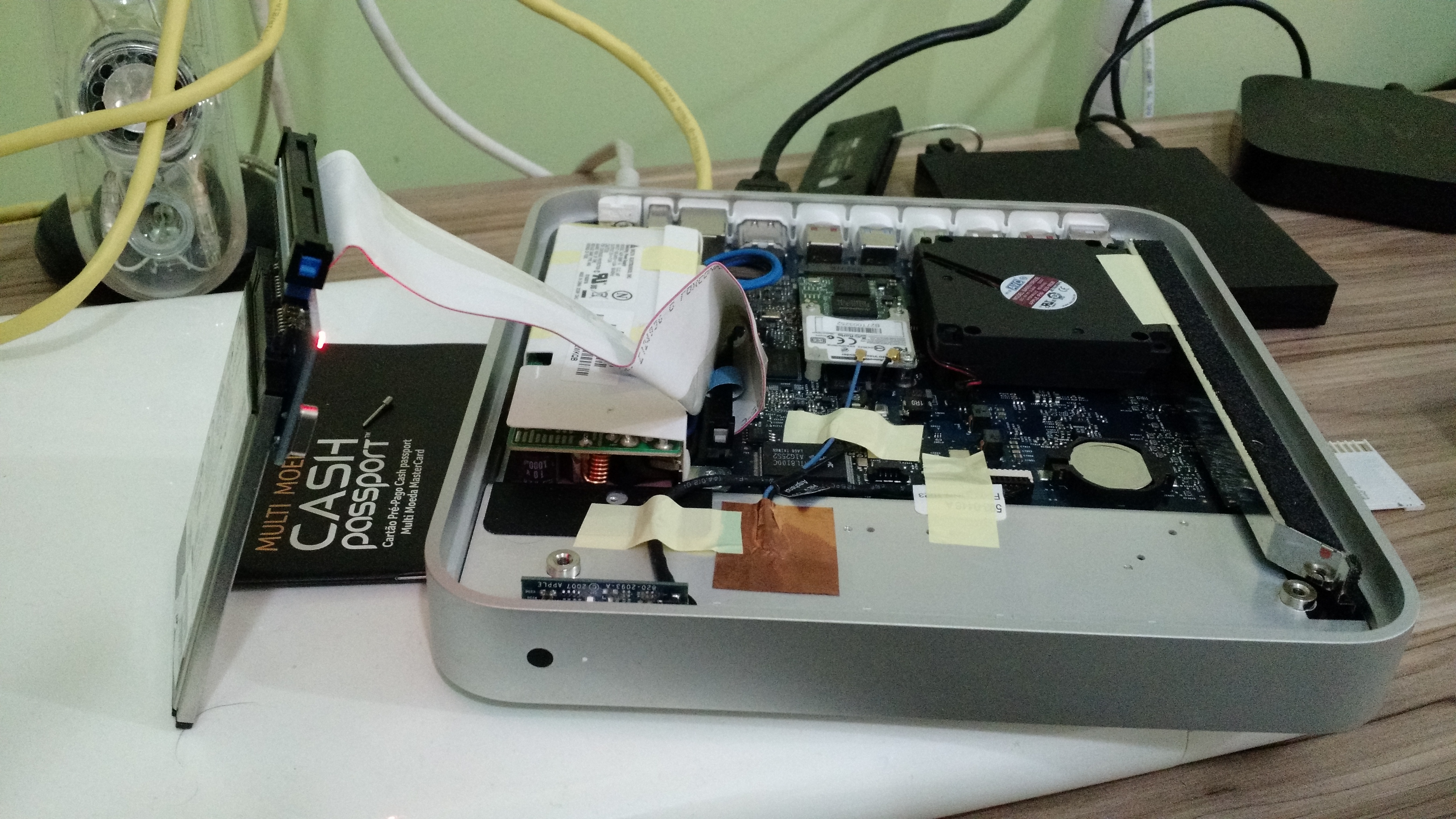

Hi Everybody. I'm new here but have been following this thread for some time. I managed to install a 1.8 SSD disk in my old Apple TV 1st gen and is is working without a problem.
Tested with the original Apple TV OS version 3.0.2 and with OpenELEC. Bot worked blazing fast and reliable.
The adapter I used was the some one posted a while back: http://www.amazon.com/IDE-Pin-Micro-SATA-Adapter/dp/B004FD5BNE/ref=sr_1_10
The main advantage of using this adapter and the 1.8" drive is that I didn't have to do any modification at all to fit the new drive inside the AppleTV. Is was small enough to place all in the same position as the previous drive.
While running OpenELEC I could do some benchmarking and the results are pretty impressive:

Attached are some images of the disk connected and a comparison of how small everything got.
To secure it in place I just used some tape and a hot glue gun on the corners.
Hope I could help others in bringing our beloved Apple TV to a more modern status.
