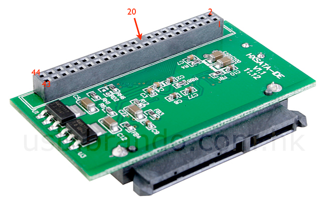

OK, if I've got this straight, pin 20 should be blocked. Since the 2.5" drive connector is 44 pins and the 3.5" drive connector is 40 pins, this gives us an asymmetric connection for the 44-pin connector, such that we can easily identify pin 20 on this adapter. That means we can locate all the other pins, and in the attached image pins 1, 2, 43 and 44 are noted. If this is correct, then when this adapter is seated on the ATV it should be pointed in the "right" direction so as not to interfere with the power supply. Pins 41 and 42 carry the 5V lines for the hard drive and controller and as you can see from this post (other attached photo) that should put those two pins in the right place.
So, I think this adapter will seat; however, it does not necessarily mean it will support booting of the ATV as these adapters have a history of being iffy. Everyone study this hard to make sure I didn't screw up the logic...😎

Sure! That logic sounds good to me! I've placed an order for one of the right-angled adapters. I'll give it a try when it arrives and then post my findings. 🙂

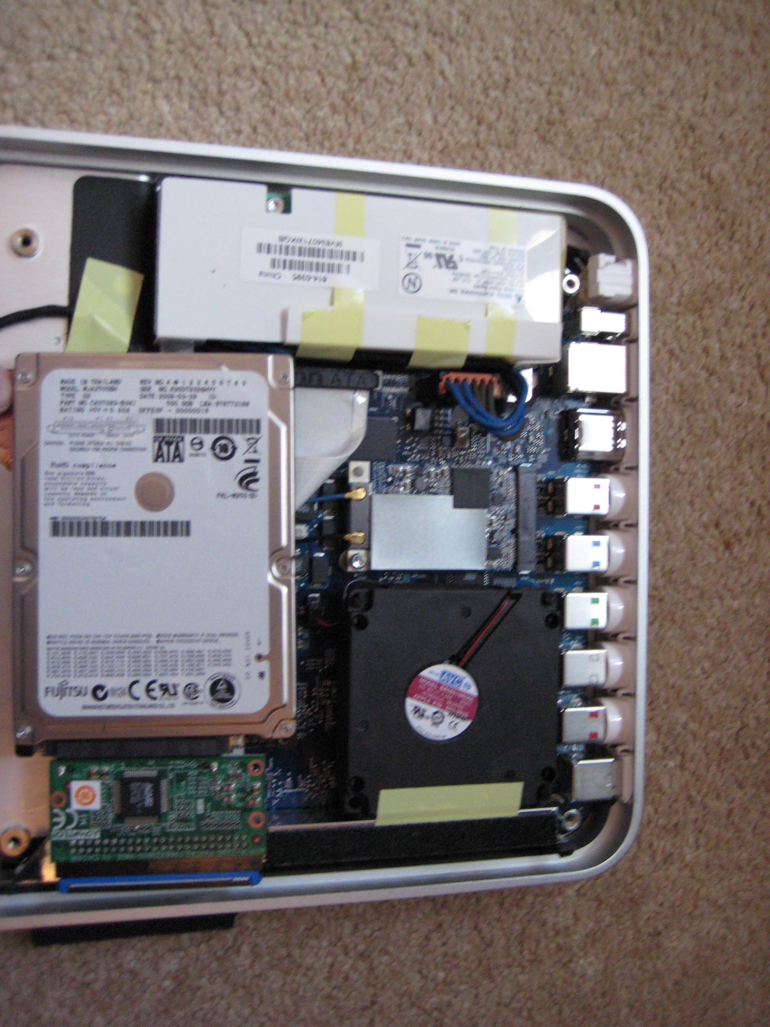

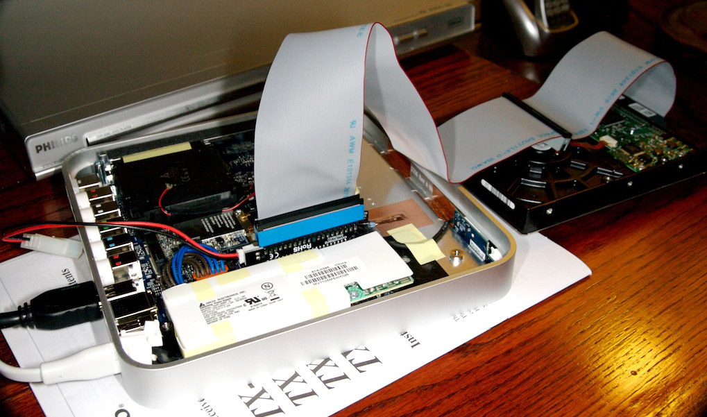

I'm trying to figure out how to close this bad boy up...it's a pretty tight fit in there and when I tried the first time, I got the blinking HD on my display. Opening it up seemed to get things back on track, but I'm going to have to figure out a way to make it work with RichyScot1's setup. Any tips?

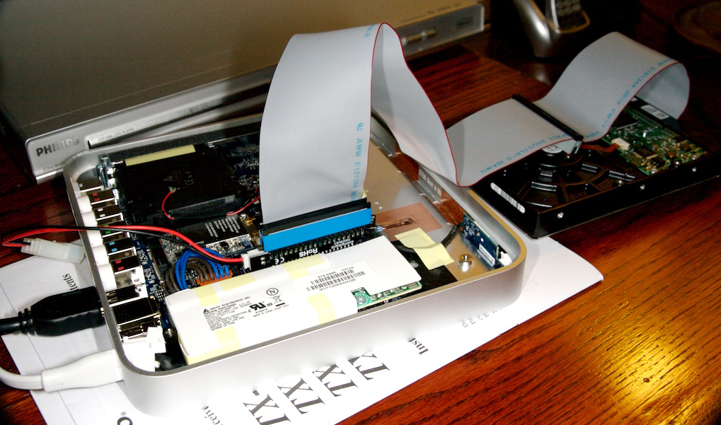

Hey there! I've actually given it a try and hacked into my AppleTV's brace. It's pretty flimsy and I was able to remove it from the ATV completely and chop it up with nothing more than a good pair of scissors. I thought about removing the brace completely, but I decided against it.
I think the problem that I'm running into is that the Brando adapter that I have is slightly longer than the Advantech one, so it makes the positioning of the whole thing a little more difficult. It's not MUCH longer, but within the confines of the ATV, it makes a difference.
Richy, I searched back a bit and found your pictures, which were very helpful. Is the image below how you had it set up before closing the top? It looks like the drive is resting on top of the IDE cable and also on part of the plastic tab. Did you screw the drive back into the bottom half of the case, or just let it sit free this way? I'm thinking that it might not be necessary to remount the drive since the ATV will just be sitting still anyway.
That's exactly what I did. My drive is effectively upside down in the enclosure. The threaded mounting holes on the drive now point towards the middle of Apple TV, instead of towards the outer casing to allow you to secure the drive. I found that if I got it the right way around the cable twisted way too much and it became difficult to close the case.
It's worth noting that the drive does fit in mine...i.e. it doesn't touch the power stuff, under the white plastic flap.
As far as I'm concerned as long as you don't have a habit of mounting your Apple TV to your bicycle or anything stupid like that, once you've closed it up, everything sits pretty snuggly in there anyway.

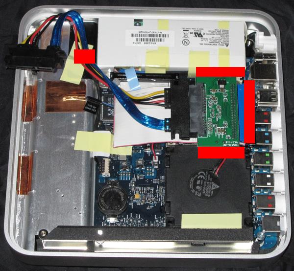

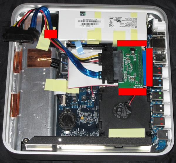

Oh! And be sure to place something between the PATA/SATA adapter and the aluminum base of the AppleTV so that it doesn't short out. I used three half-inch x four-inch strips of nylon electrical tape rated for high heat (running from the power supply to the CPU fan). Not only did the tape insulate the adapter, but it also helped to hold it in place while running the SATA cable and putting things back together.
So...I had everything set up and working, but when I closed it up, I got the alternating yellow and white lights. I assume something is getting shorted out, but I'm not sure what it is. When I open up the ATV, everything works fine again. I'll try more tape and see what happens...but it's very odd.
I was getting the exact same alternating amber/white light until I taped down the PATA/SATA adapter as I described. Don't get discouraged. There is a way to make it work. I fiddled with it for a couple of hours before finding the right placement.
Please pardon the terribly basic graphic I've attached. I'm at work with no access to my AppleTV or Photoshop. But I wanted to give you an idea of the electrical tape placement (red) and cabling path (blue/green) I used to get it up and running. Again...I used an electrical tape that's white and made out of nylon that apparently withstands higher heats than the black tape I ordinarily use.
Hope this helps.
Nathan
Thanks for the pic and the advice! I tried something similar to your setup, although for some reason, every time I put the tape across the top of adapter, it wouldn't work. To get around that, I lined the bottom of the case with the electrical tape, so when it made contact, it wouldn't hit the metal. I'm using the black tape that's rated to 200 degrees F, so I figure that should be enough.
I pretty much taped around everything else that had the potential to touch the adapter. Here's my crude illustration! Tape locations are in red. For the IDE cable, I taped the bottom since it touched the metal of the cable ports. I know it's plastic and probably wouldn't cause problems, but I figured why not just be safe? I also taped under the adapter on that little set of wires next to the power source, as well as on the white plastic. I didn't screw the HD back in since I felt like that was causing problems too. That final piece of tape near the SATA cable just helped me keep it in place while I connected everything, so I left it when I closed it back up. So far, it seems to be working.

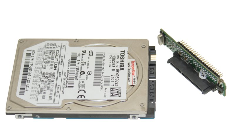

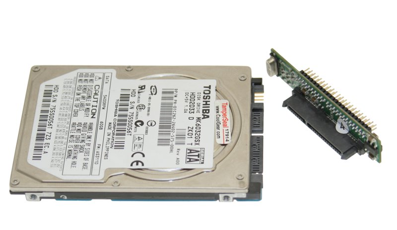

Cooldrive 2.5 "SATA Hard Drive IDE a 44 pin adapter
Good day to all, are new, but I would ask you if someone has tested this product and if you know you tell me if this works with the Apple TV.
Thank you all for the answer and any advice
I tested that product. It did not work. Sorry!
