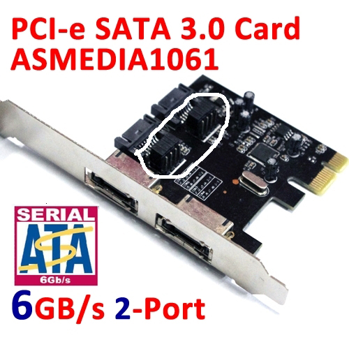

What are those cards?
They are Sata controller chipsets for Sata cards.
Is it true they will work? I assumed a cheap controller would work for secondary drives, not sure about booting though.

I tried to use some random sata card and it just caused kernel panics
Will absolutely any card that uses those controllers be compatible with Leopard PowerPC (as long as it is the correct PCI-X with PCI-X macs, -e, with PCI-e Macs)?
99% probability. However, if the card is a "PC-only" item, it would need to reflashed with a firmware update of a similar card from http://www.wiebetech.com. Just track down a Wiebe Tech card with same number of SATA ports and running the same PCI/e/X interface as the generic one you bought off ebay (count ESATA and internal SATA are of no difference) and - obviously - using the same chipset, double-check System Profiler if you have anything listed in PCI section (you'd have an "unknown device" or similar listed) and flash it with the terminal app provided with Wiebe Tech update.
I have been running 2x SATA PCI RAID in my G4, now I have a very fast 2x SATA PCI-E RAID in my G5, all done with this very procedure.
I've run both at the same time on my quad..Boot SSD of the AS media, storage drive and SATA Blu-Ray off the native SATA ports and eSATA back up's on the SIL card. The SIL card needs a driver from the website to work.
http://www.siliconimage.com/support/searchresults.aspx?pid=32&cat=3&os=3
SiI 3132 32-bit universal Mac OS X 10.4.9, 10.4.10, & 10.5.1 BASE Driver 12/26/2006 1.1.9 154 kb Use this universal driver with Mac OS X 10.4.9, 10.4.10, & 10.5.1 on PowerMac G5, PowerBook G4, and MacBook Pro.

What specifically did you do? Was it difficult. I really need one of these, as you can see i my signature, a 1 tb hdd, and a ssd is just for looks without a controller card.
I had a syba card and it caused repeated kernel panics.
