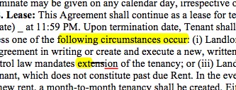

I just tried it, using both the "Save as.." and "Print" methods. It worked perfectly fine. I was able to select one word, part of a word, or a few words and highlight, strikethrough or underline. Zero problems.
Okay, now I'm stumped. Do you run Leopard or Tiger? I would now be curious to know what configuration drlunanerd and I share, which you do not.

I didn't check earlier, but I get the same effect. The resulting pdf file from Word, when opened in preview cannot have text selectable as you would normally use it.
I don't what program ggjstudios is using, but my preview select is in blue, not yellow.
Looks like marking the text using either Skitch or Adobe Acrobat (not reader).
I thought this was normal behaviour, but I'm relieved to know its not (although other people have the same issue).
if you try reading posts:
Leopard. 10.5.6. MS Office 2008. All updates current. No customization or add-ons to Office.
The markup was done on the pdf file from Preview.
"I was able to select one word, part of a word, or a few words and highlight, strikethrough or underline."
The yellow is not a selection; it's a highlight, done with Preview on the .pdf file I created from the Word document. In this image, which is a screen capture from the .pdf file as viewed in Preview, the purple is a selection. The yellow is a highlight (Tools > Markup > Highlight). The other two are obvious.

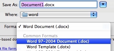

You won't be able to open the .docx document properly in Windows, but on your Mac, you can save the document as a Word 97-2004 file, with a .doc extension, so it's readable on Windows.
