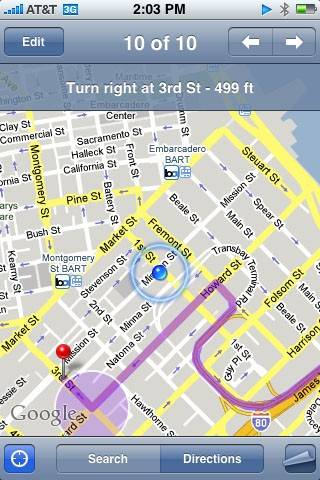

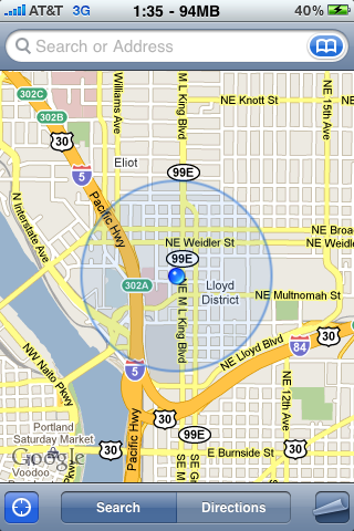

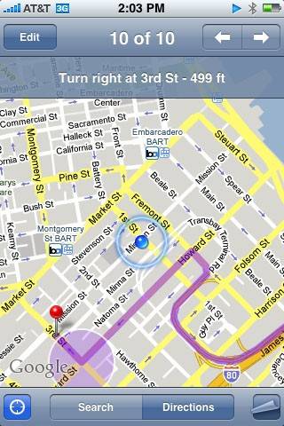

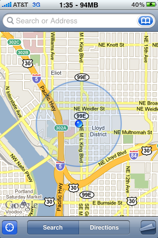

Just to be clear, my GPS works in that it triangulates my approximate position. It doesn't however, lock onto my exact position and "follow" me. Are you able to get it to follow you? Thats also indicated by the pulsing/blinking blue circle that emanates from the center of the blue dot.
In my case, it gets to this "approximate" point, and then stops, without attempting to improve to the GPS locked status.
See the first image with the blue "shading" indicating that its an approximated triangulated position based on cell towers.
The second image shows the clear blue pulsing circle radiating from the blue dot, as opposed to being a fixed, shaded circle.

fjk: I got the "thrumming" circle around the blue dot (2nd image). My iPhone does get the larger "cell-tower-resolved" circle (first image), but it resolves itself to the smaller one shortly thereafter.
