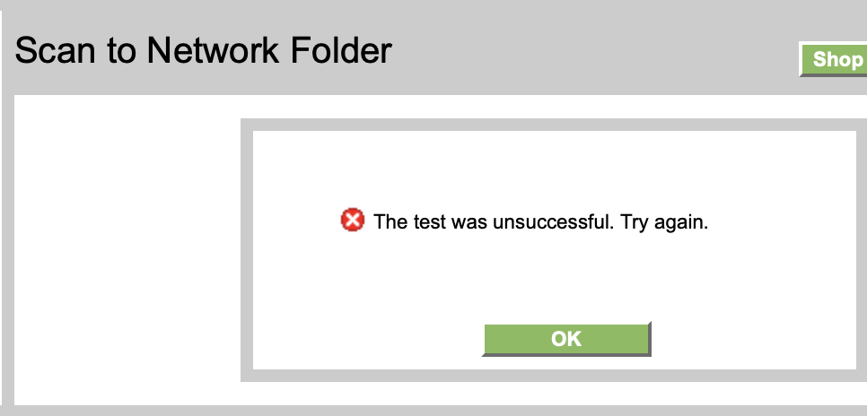

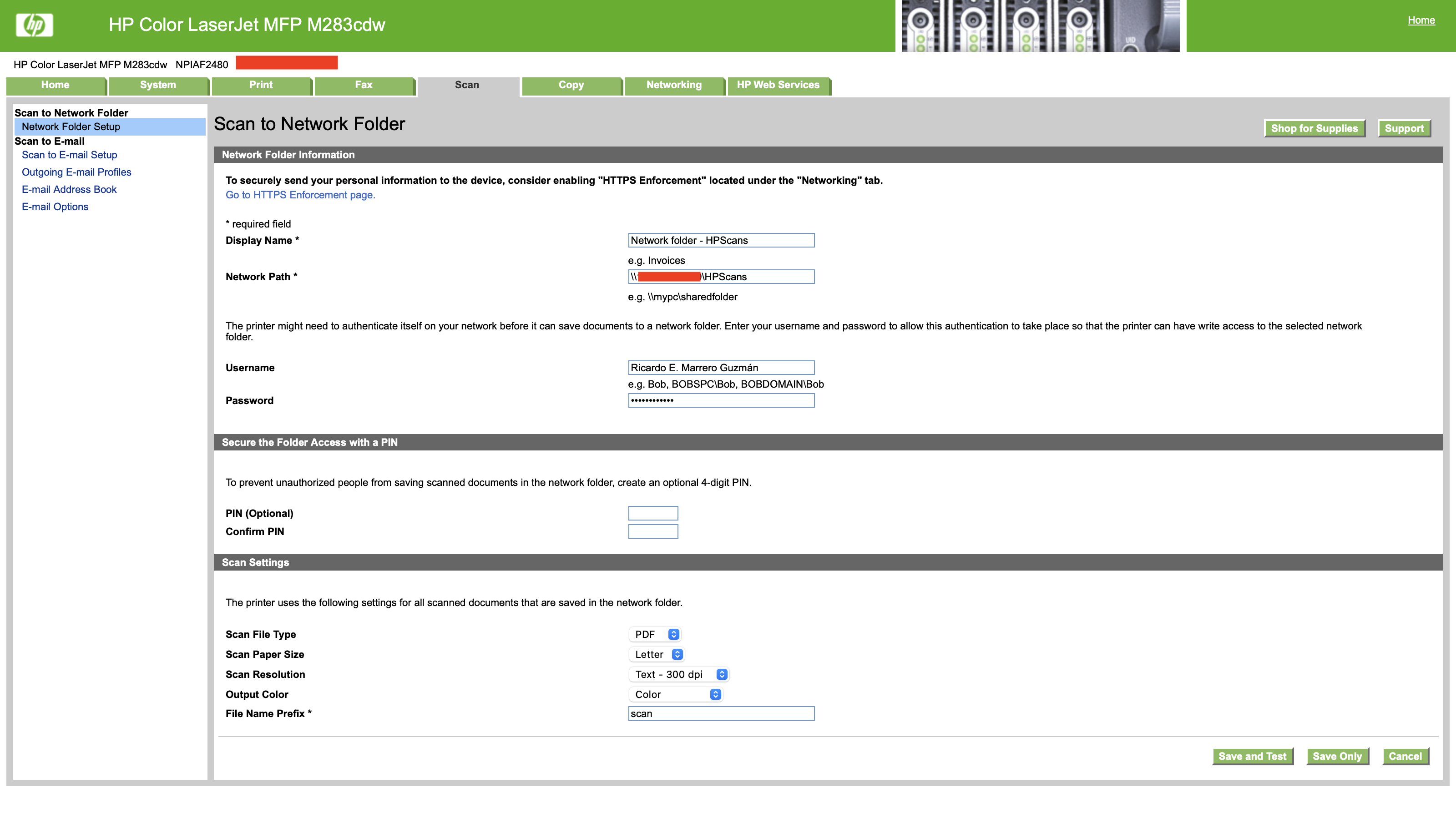

What I want to do is set up a network folder on my Mac so that I can scan documents from my printer to that folder. My connection is wireless. The printer sees the shared folder, named HPScans, but it can't connect to it. The EWS error is "The test was unsuccessful. Try again."

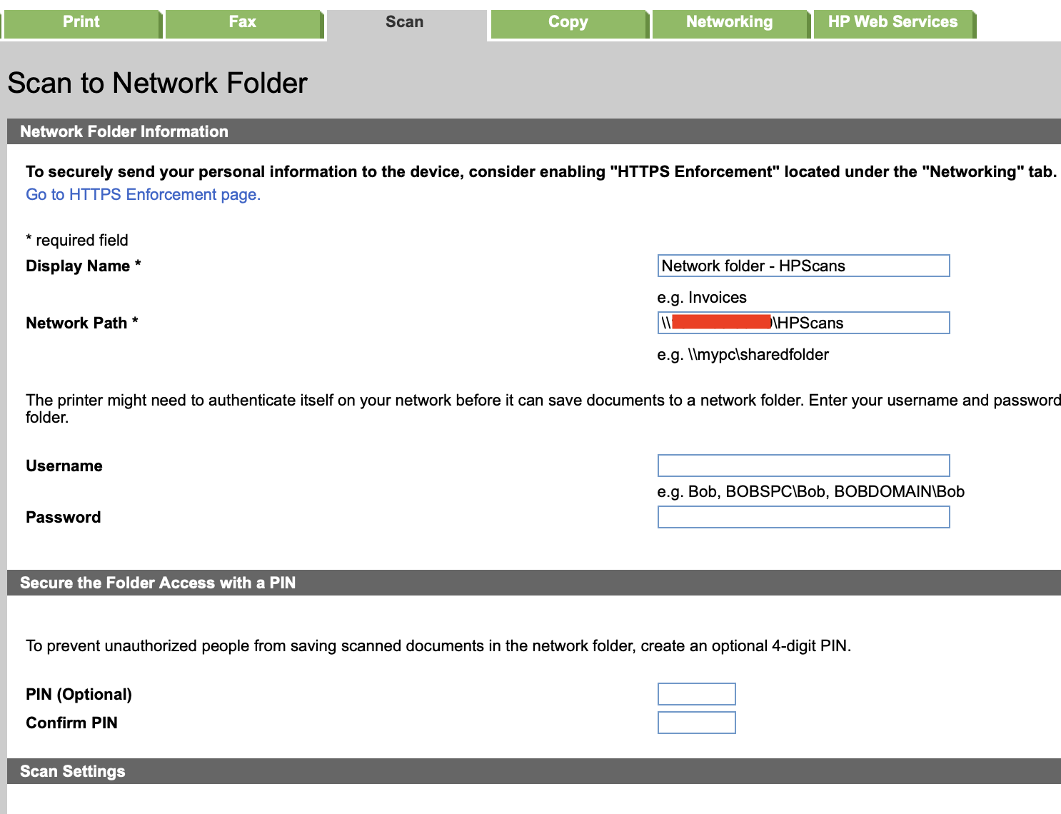

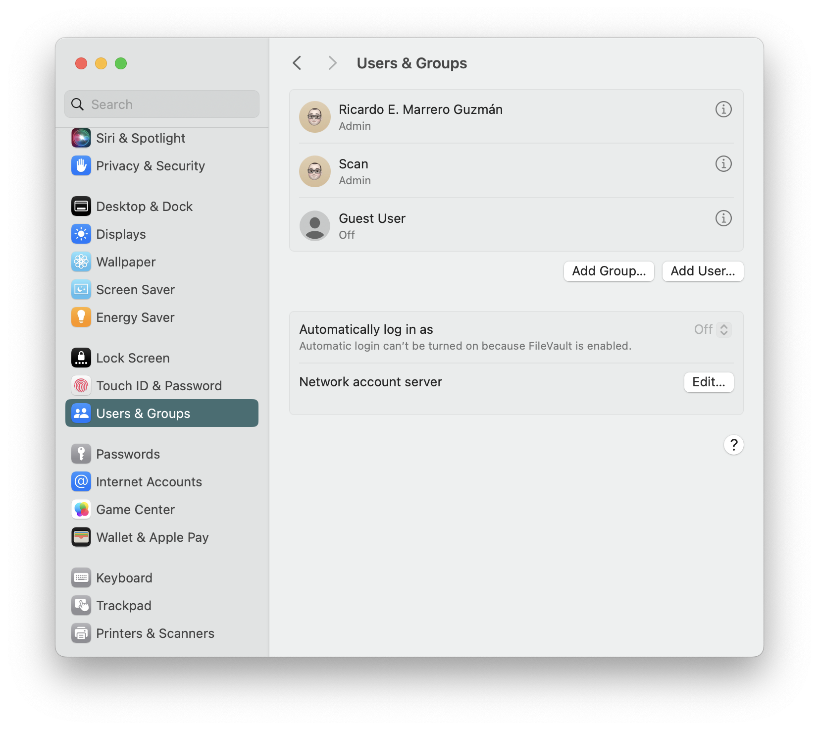

I understand that in the EWS (setting up the Network folder with my printer's IP), my username is correct, as I got it from: Finder >> Users & Groups. I have admin privileges and I have read and write permissions in the shared folder "HPScans". My password is the same as the one I use to log in to my computer with my username.
Username: Ricardo E. Marrero Guzmán
Password: ************** (my Mac login password)

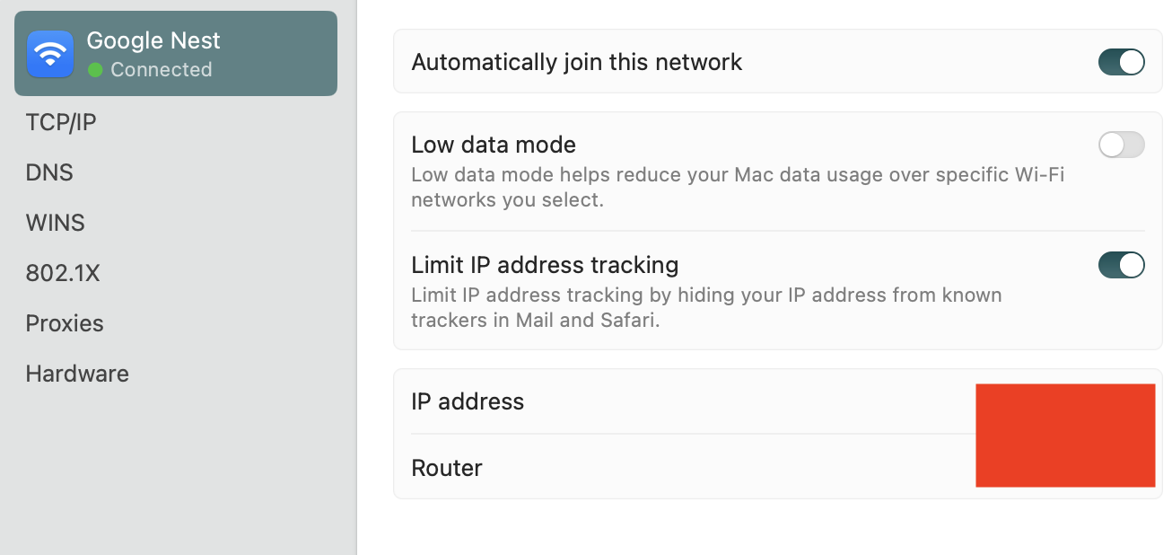

To write the "path," I obtained my IP address from System Setting... >> Network >> Wi-Fi >> Details. Both my Mac and my printer are connected to the same network, and it's working fine.
\\#.#.#.#\HPScans

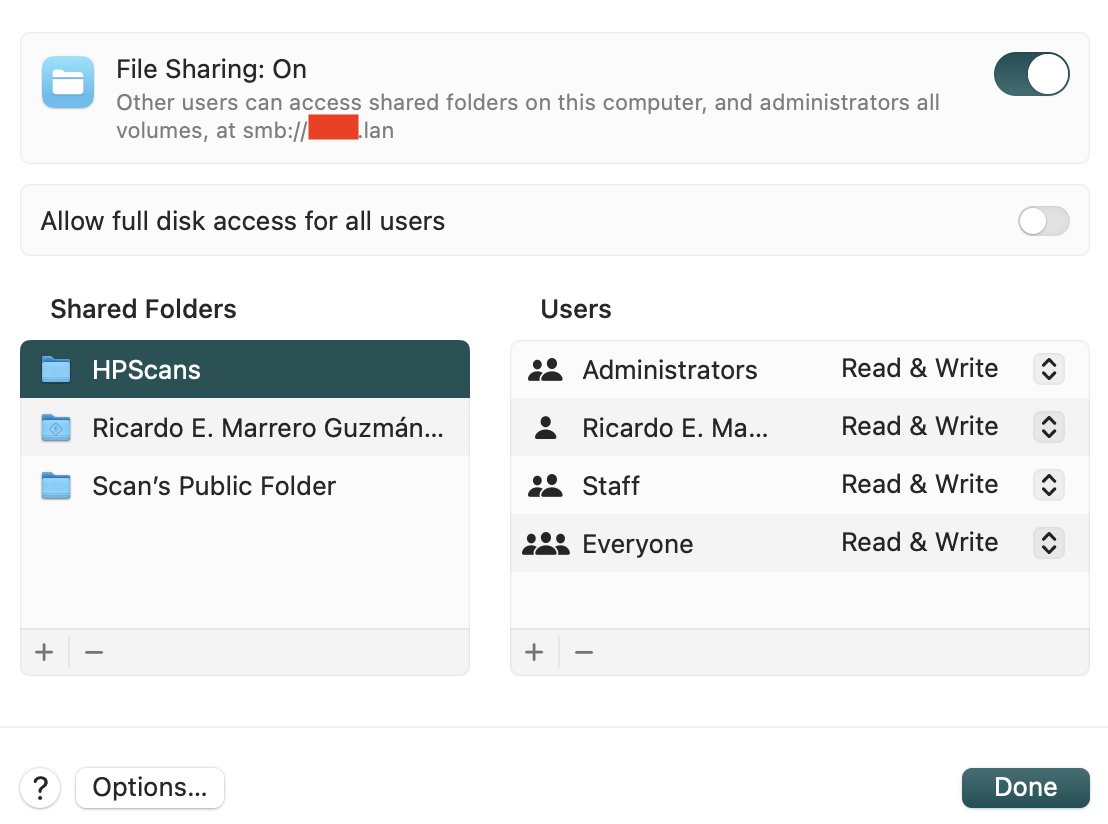

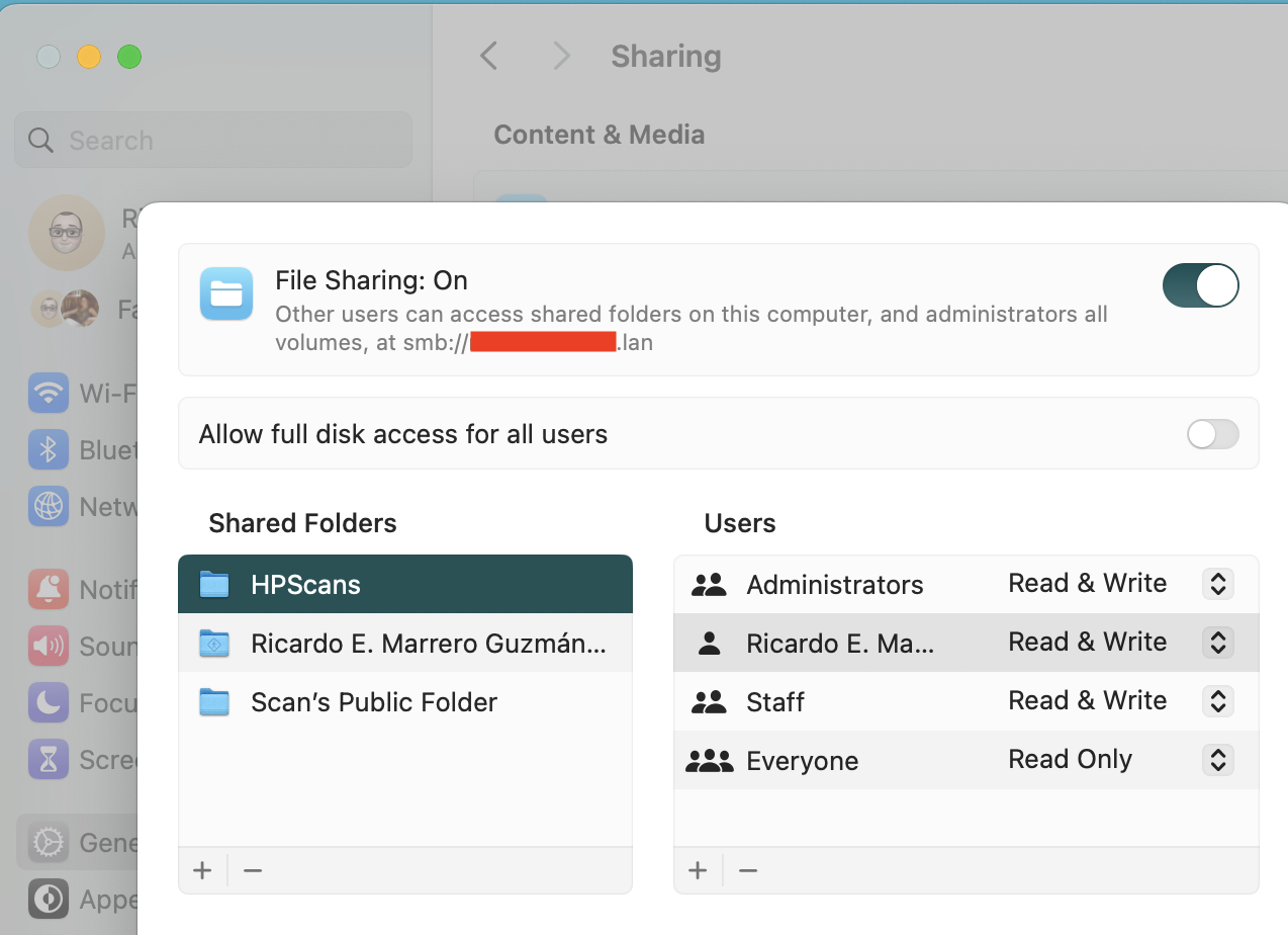

"File Sharing" is active in System Settings... >> General >> File Sharing. In "File Sharing Information," the Share Folder HPScans was added, and my username has read and write permissions.

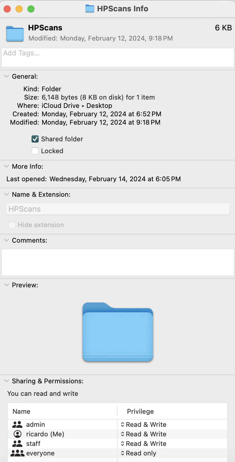

In Finder >> Desktop >> HP Scans (Get Info), the Shared folder is checked. Below it says "You can read and write."

Printer EWS configuration:

In the EWS configuration, try changing your user name to “ricardo” (lower case). I think the full name is only for the Mac.
If that doesn’t work, for troubleshooting purposes give “Everyone” read & write access in file sharing, and remove the credentials from the EWS configuration to see if the problem is the authentication or simply accessing the folder.
Thank you for this recommendation, but doesn't work. Let me try your other recommendations.
I give "Everyone" read & write access and remove username and password from EWS and the error message is "The test was unsuccessful. Try again.

It worked! This is the solution. Thank you very much to MikeDr206 and everyone for their recommendations.
What I did, based on MikeDr206's recommendation, was the following:
System Settings... >> General >> File Sharing off
Restart...
System Settings... >> General >> File Sharing on
Important: The username was ricardo instead of "Ricardo E. Marrero Guzmán".
