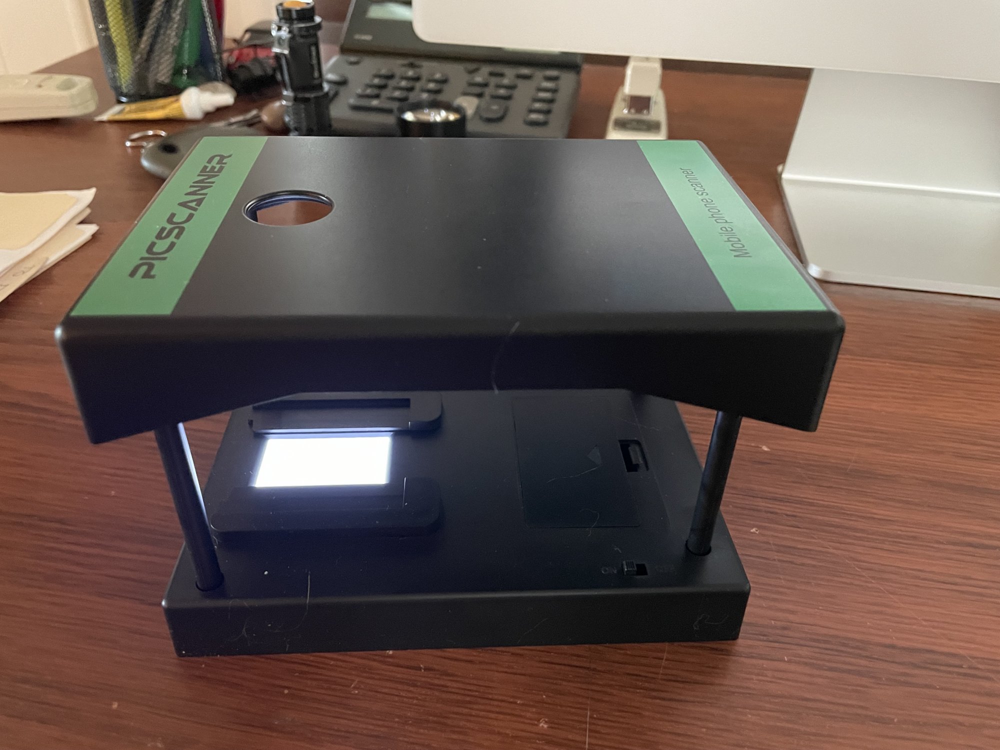

Flatbed scanner for high quality serious work for sure, but for quick digital copy of old slides this cheap device holds the iPhone perfectly and has a LED light source built in.
See 'Photo of the Day #353' for example.
