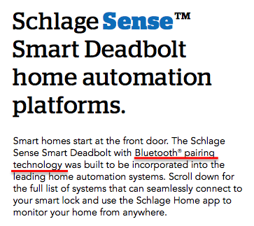

I've had a Schlage Sense lock for several years. Its only radio is Bluetooth (BLE), so initially, without a hub, I could only operate while my iPhone was within Bluetooth range. There is always a long delay to operate on arrival, as it takes time for the lock to re-connect via Bluetooth.

I tried to look at the instructions for that lock and it wasn't very clear. I believe the lock must be connected via Bluetooth for the Schlage app to work. To my knowledge, apps can't connect to devices without those devices showing up in Settings. Maybe I'm wrong.
This is not something you can access or will be able to see via Bluetooth settings. Everything is handled transparently via the Schlage app and/or HomeKit, AFAIK. I believe it's leveraging BLE.
I also wasn't aware that a Home hub can control Bluetooth devices.

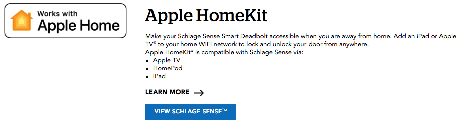

See: https://www.schlage.com/en/home/smart-locks/schlage-sense-works-with.html
As far as the current problem, it's like the Home Hub is no longer able to maintain its connection to the lock beyond the first 15 minutes. Before the tvOS and iOS updates last week, I've had zero issues monitoring and using this lock remotely.

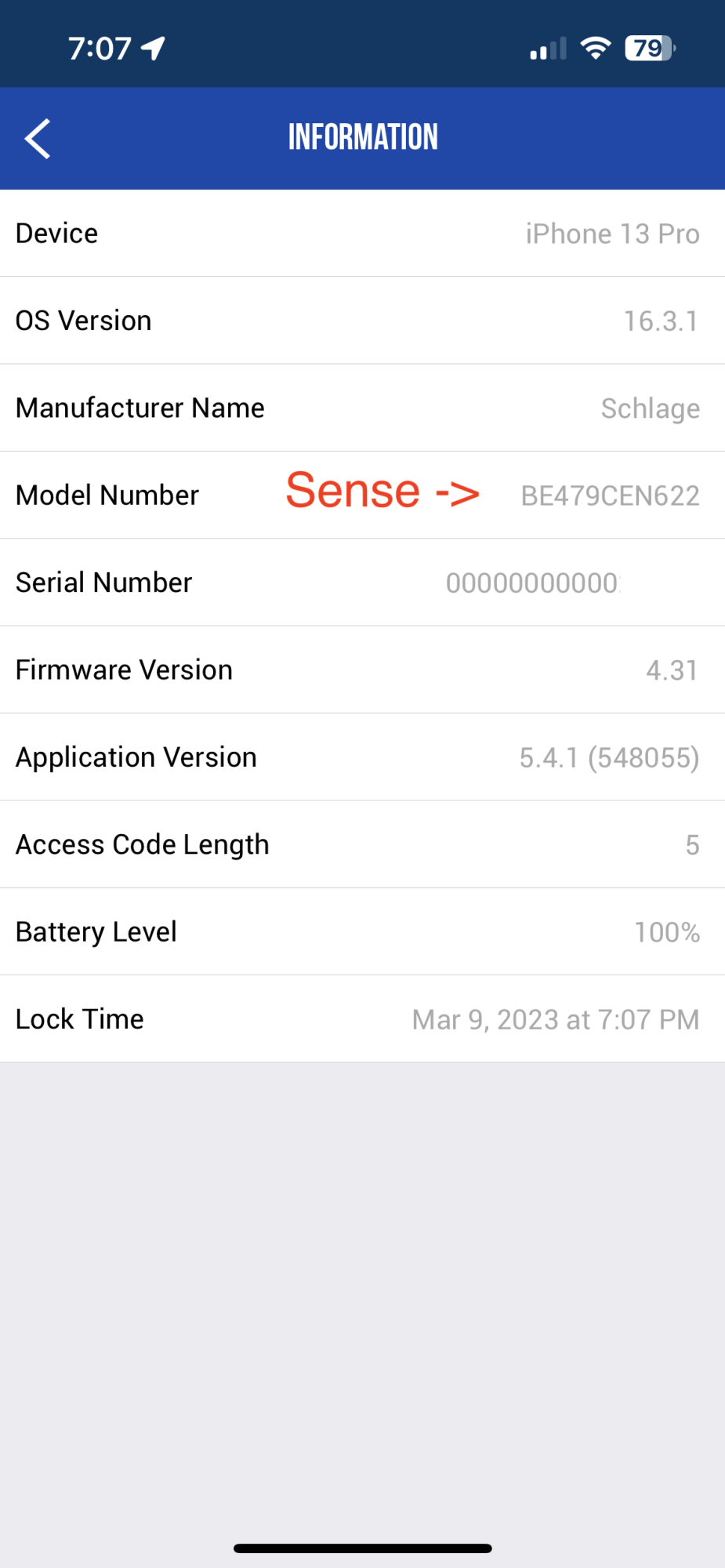

  • Verified Schlage firmware up to date - v4.31, no change.
  • Verified Schlage battery - 100%

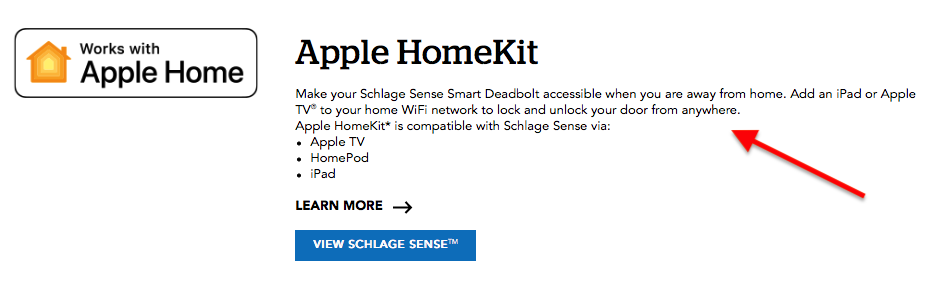

I think Schlage dropped the Sense from their HomeKit supported list.
I don't think so. It's still the third product on their smart-locks page:
https://www.schlage.com/en/home/products/products-smart-locks.html
And the Schlage website is still showing the Sense as HomeKit compatible:

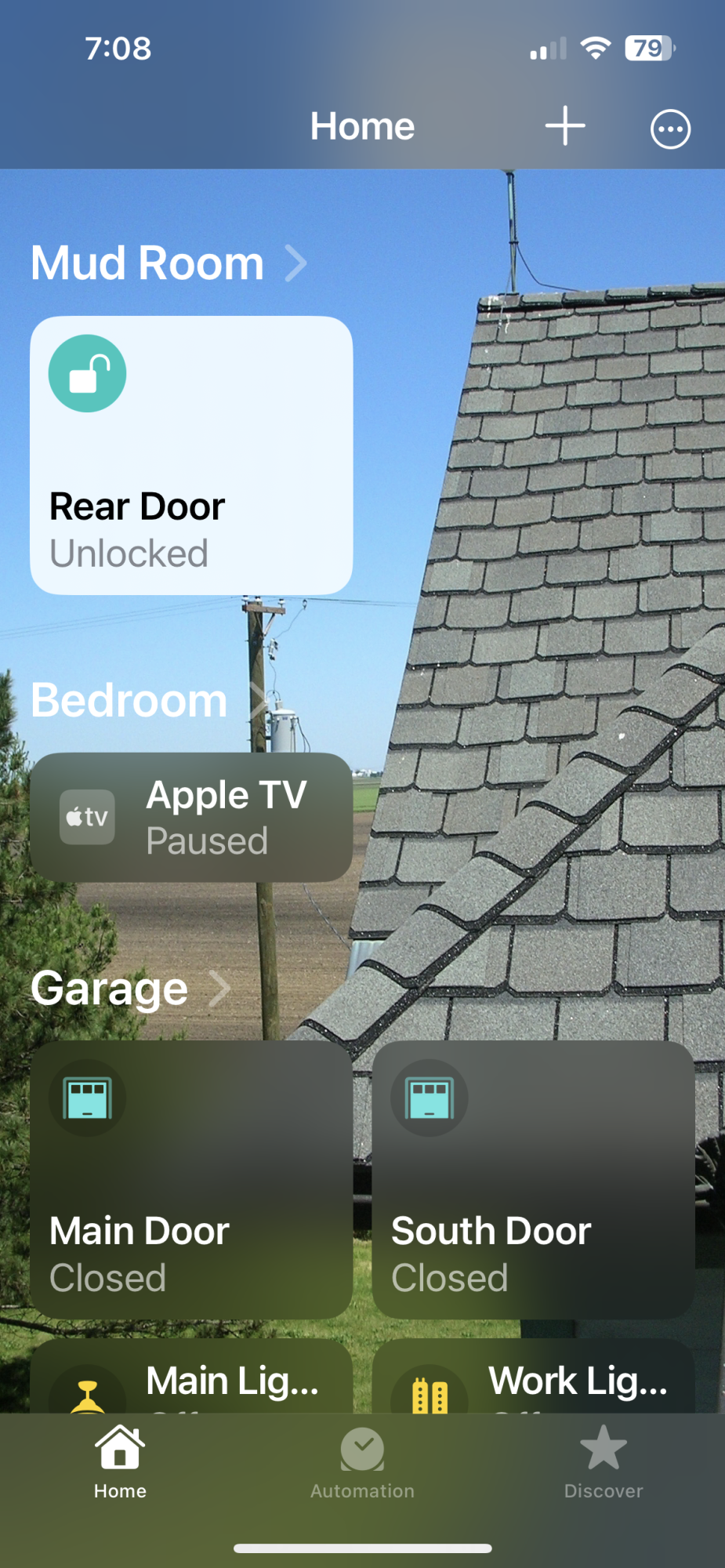

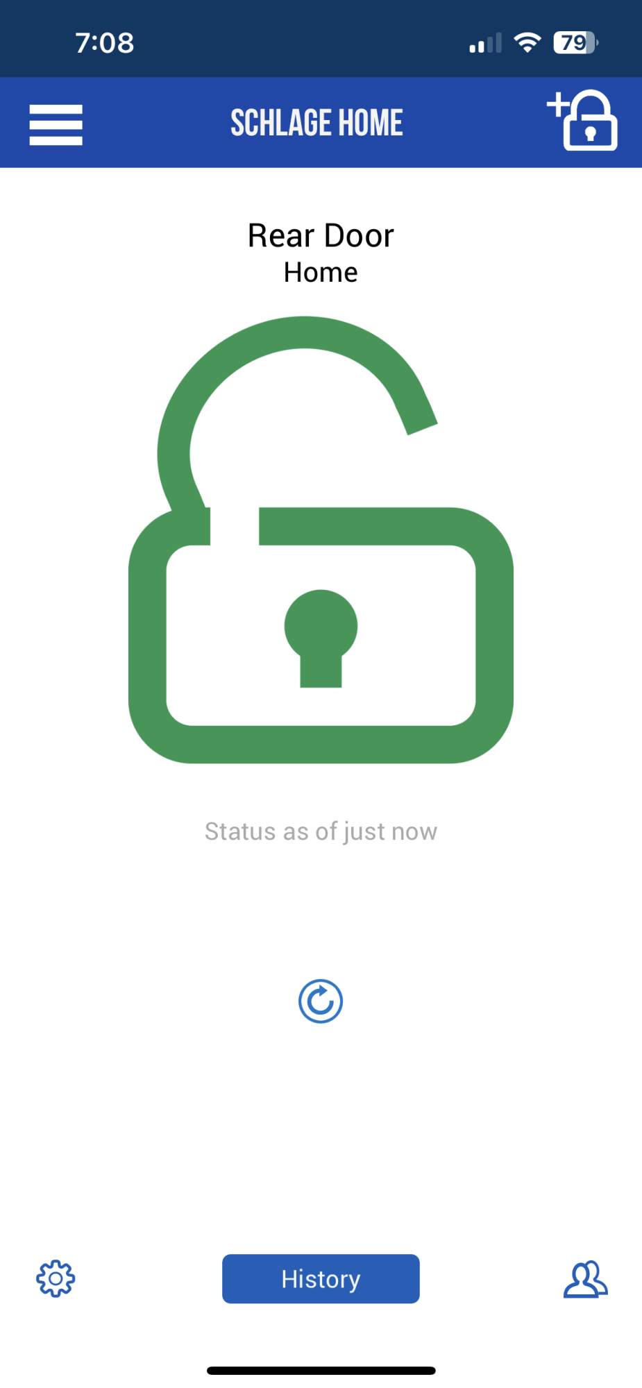

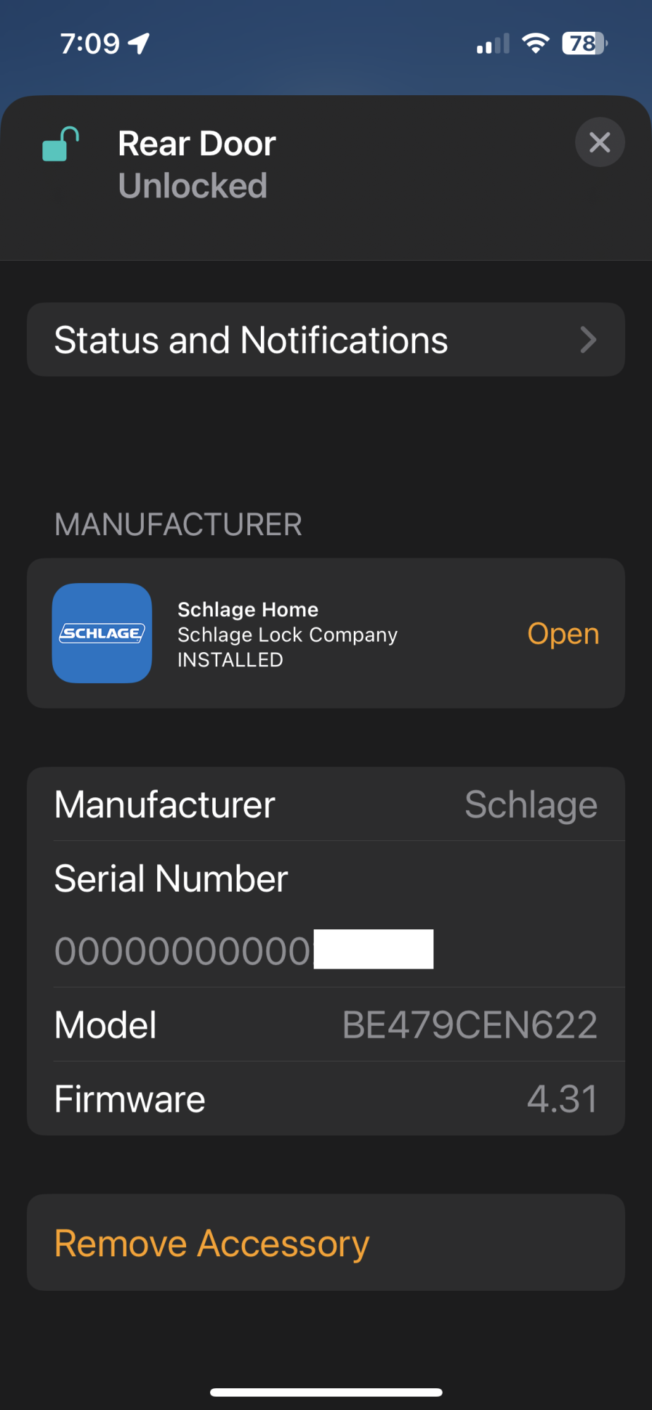

And it was when I tried to add them directly to HomeKit where I got the message from the Schlage App that the Sense was not HomeKit compatible.
And yet I completely deleted mine and successfully re-added it to HomeKit just a couple days ago...
And here it is in the Schlage app...
The website is out of date and they haven’t updated it now that HomeKit is dropped.
I just called Schlage and they confirmed that Sense fully supports HomeKit and that their website is up to date. I encourage you to do the same before making bizarre claims.
Good luck, I hope I’m wrong. But I doubt you’ll ever get the Sense back on HomeKit if Schlage dropped HomeKit compatibility. But it’s not obsoleted. It still works just fine. You just can’t use HomeKit automations or when you’re away from the house.
Schlage cannot "obsolete" a lock or "drop" HomeKit without touching the lock's firmware. The Sense has been on the same firmware (v4.31) since at least 2018.
As others and myself have experienced, rebooting the Apple Home hub restores full HomeKit remote functionality. The same remote functionality that was working reliably well just until tvOS 16.3.x was released.

Same problem here! I just searched today for the umpteenth time to see if ANYONE else has had this problem as I have struggle with it for many months since I decided to install Apple's new, now aborted, Homekit architechture on my Apple TV. I had hoped that the latest updated was to clean everything up but it didn't. Now all I can hope for it that TVoS 16.4 restores the original Bluetooth function that was working flawlessly before. Schlage support is disgracefull. TOTAL SILENCE. I'm done with a company that treats it's customers that way.
See if my latest reboot procedure helps you. It's not a permanent fix, and it's super inconvenient, but I'd be curious if you get the same results.
• Force quit Schlage and Home apps from your mobile devices (probably does not matter)
• Unplug Apple TV (or all Home hubs if you have more than one)
• Reboot your router by unplugging it for 15-30 seconds
• After your internet and wifi are restored, plug in Apple TV (and your other Home hubs)
Test Schlage remote functionality by first disabling wifi and bluetooth on your phone. This seems to hold for 12-24 hours.
Also to note, like the other poster, even when I have no remote access, manually operating the lock seems to wake it up and restore some remote functions, like Home notifications.
Totally convinced that the last HomeKit update screwed up how this lock works with BLE. It goes to sleep and then cannot be woken remotely, effectively killing remote access until the next reboot.
