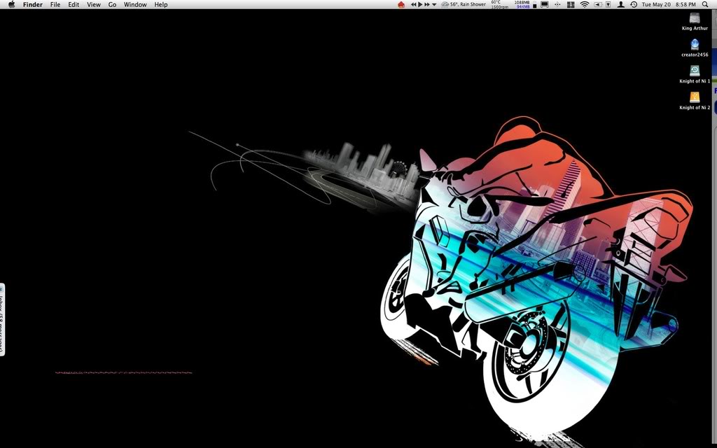

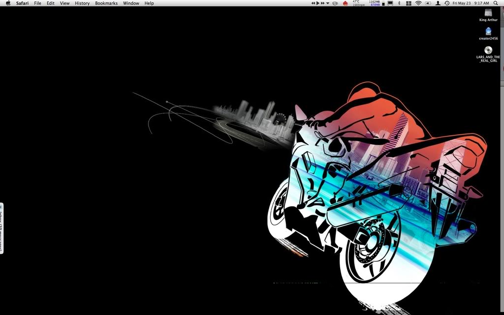

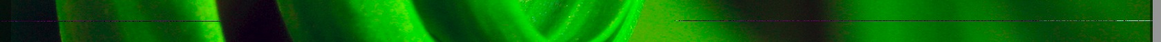

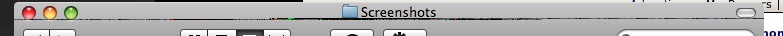

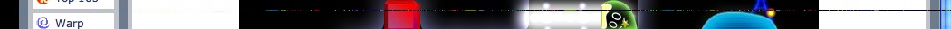

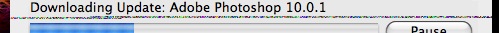

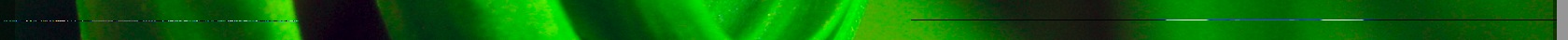

For the last few weeks I have been noticing that at times I get lines of scrambled pixels. This is happening in individual apps and on my desktop. Only way to get rid of them is to quit the app or restart.
lower left:
lower right:
close up:
I don't have a screenshot of it happening on an app window, but it looks the same as above.
17" MBP 2.16 GHz CD 2 GB RAM running 10.5.2
What could be going on?
They appear to artifacts related to the video card from overheating which causes the GPU to stop responding for even a millisecond.
I am pretty religious of keeping check on temps, and the lines stay on until I quit/restart.
I had exactly the same problem, but I also saw persistent 'hot pixels' (for want of a better expression) from the grey boot screen. I took it in yesterday and they are replacing mine (2nd gen 15" MBP) with a new one (hopefully).
Wow, there are sure a lot of lemons in the Apple store these days!

lower left:
lower right:
close up:

it's a first gen MBP so its not indicative of current models. you can't expect that to be problem free.

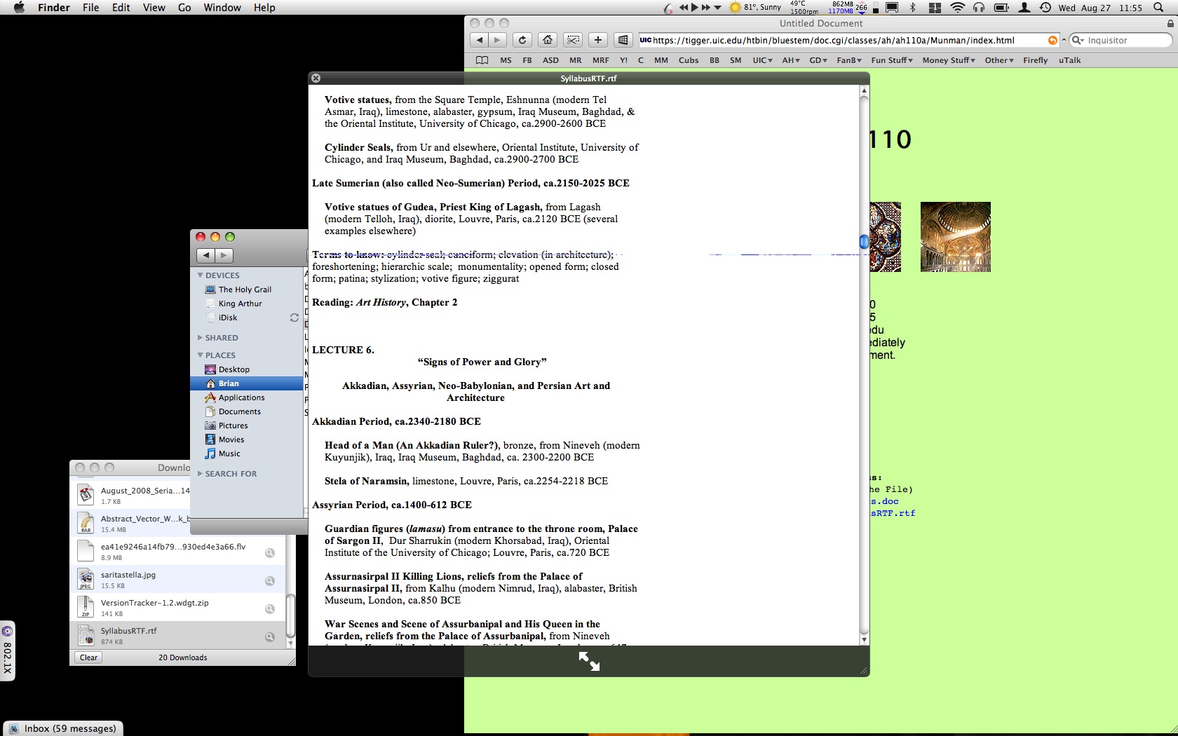

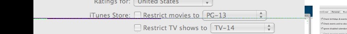

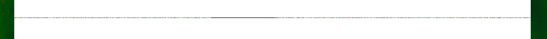

Just posting a couple more screen shots since I remembered to take some this time.
Adding in the temps (C) to show that overheating is very unlikely.
There is colored scrambles on the left side and a solid black line across to the right.

I would think its the
1. LVDS Cable
2. LCD panel
3. Logic board
unfortunately its a little hard to pinpoint the issue.
have you tried plugging the computer into a external monitor? If scrambling happens on the external monitor, i'm afraid to say it is the logic board. If no scrambling occurs with an external monitor, then you can bet its the LVDS cable (cheapest) or the LCD (more expensive)

Haven't seen it on an external that I can remember, but I will be using one more often now. I still have a year of Applecare so hopefully if it is going to get worse, it does it soon.

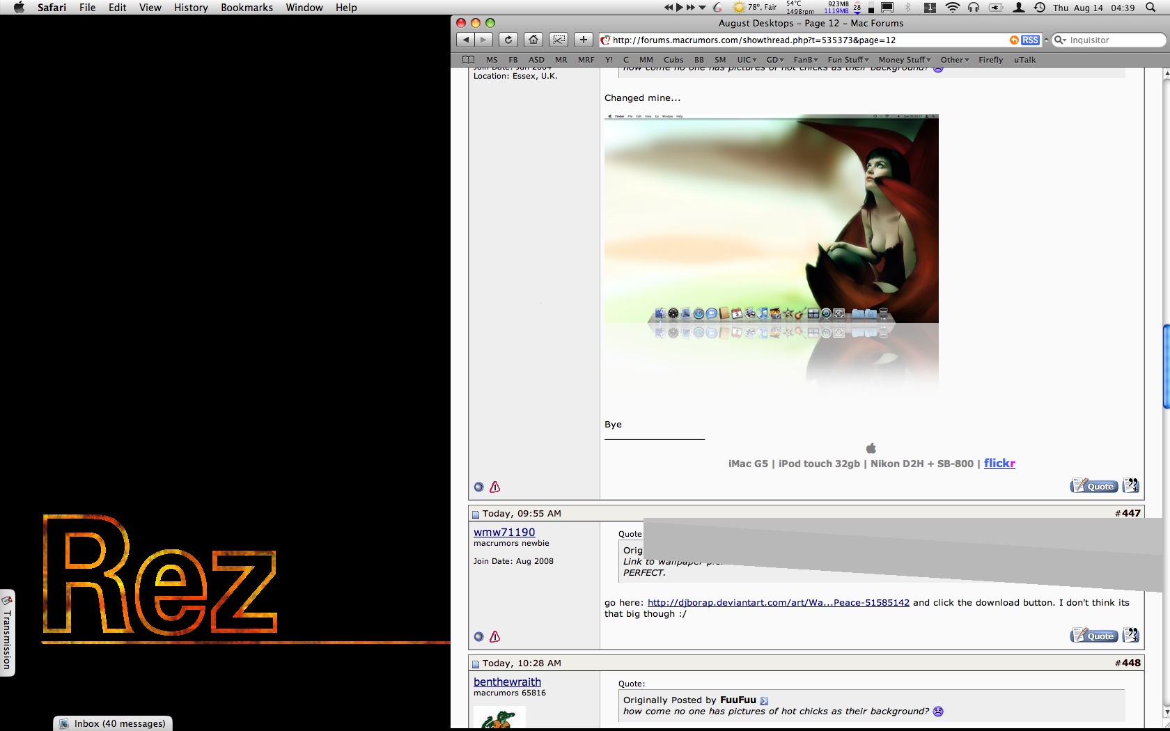

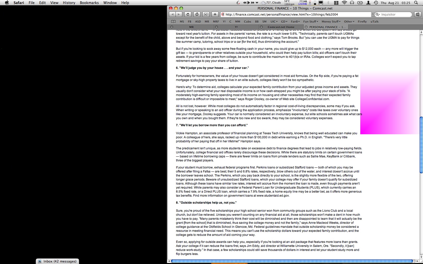

Another screenshot. This time the scrambled line is only occurring to the Safari window. It affects all tabs in this window, but new windows are fine. Temps are within 5 degrees of the last screenshot above.

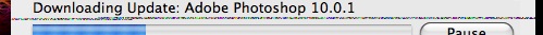

Again, just posting some more screenshots.
Edit: Adding another one (thinner), it's the same row of pixels as the other one, but it just changed within 30 seconds of me posting.

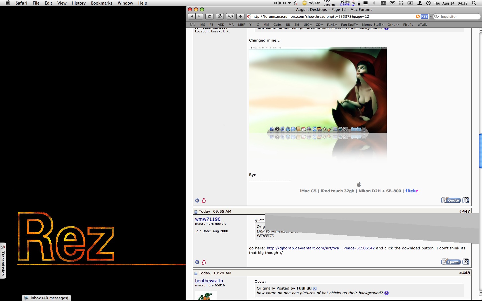

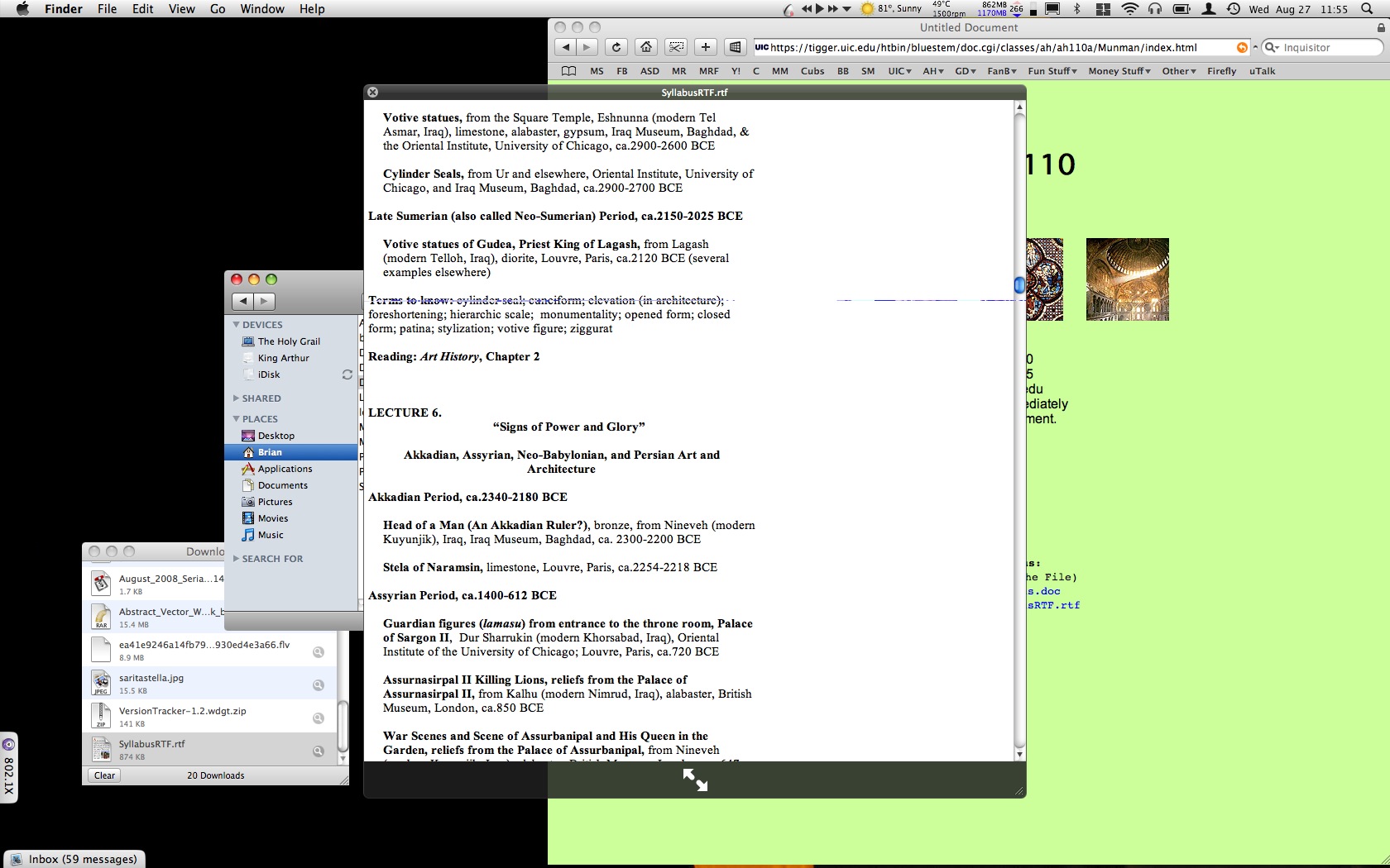

Here are some of the new screenshots (about 20 more)that I have taken over the last month and a half.
There have also been 'boxes' of color appearing (the pink in Safari) that disappear once the window scrolls or if I try to highlight it to get the screenshot (using cmd+shift+4, cmd+shift+3 works).

Are you taking screenshots or are you photographing the screen? If you're taking screenshots, then the errors shouldn't show up in said screenshots, if it's just a loose cable, connector, and such. For it show up in screenshot would indicate hardware issues like problematic video cards, motherboards, etc.
Taking screenshots. Some of the time I have to take a shot of the whole screen because when I drag the highlight for a portion, the scrambles go away, but most of the time just a capture of the portion of the screen works.
Now that I am back in school, I may just take it to Apple for them to look at, but have to wait until break to get it fixed.

that's a sign your gpu is slowly dying, probably from a little more heat then it could handle.
However at my old job we had a mac pro that had a similar issue, I was told it could have been a dying system drive causing it if it wasn't the gpu. But I left that job before finding out.

Just got back from the Genius Bar. The guy took one look at the screenshots and said it was the graphics card going and that the logic board needs to be replaced. I had them order the part and that will take up to 7 days (get to keep MBP during this time), once they receive it they will give me a call. After they call me, I have 7 days to hand over the MBP for repair. The repair will be 3-5 days.
Looks like I'll be using the school's lab computers for a couple days 🙁 but at least Apple is taking care of this promptly and with no hassle 🙂
I see; I would have said it was the display cable, but it's probably cheaper and easier to replace the motherboard first.
