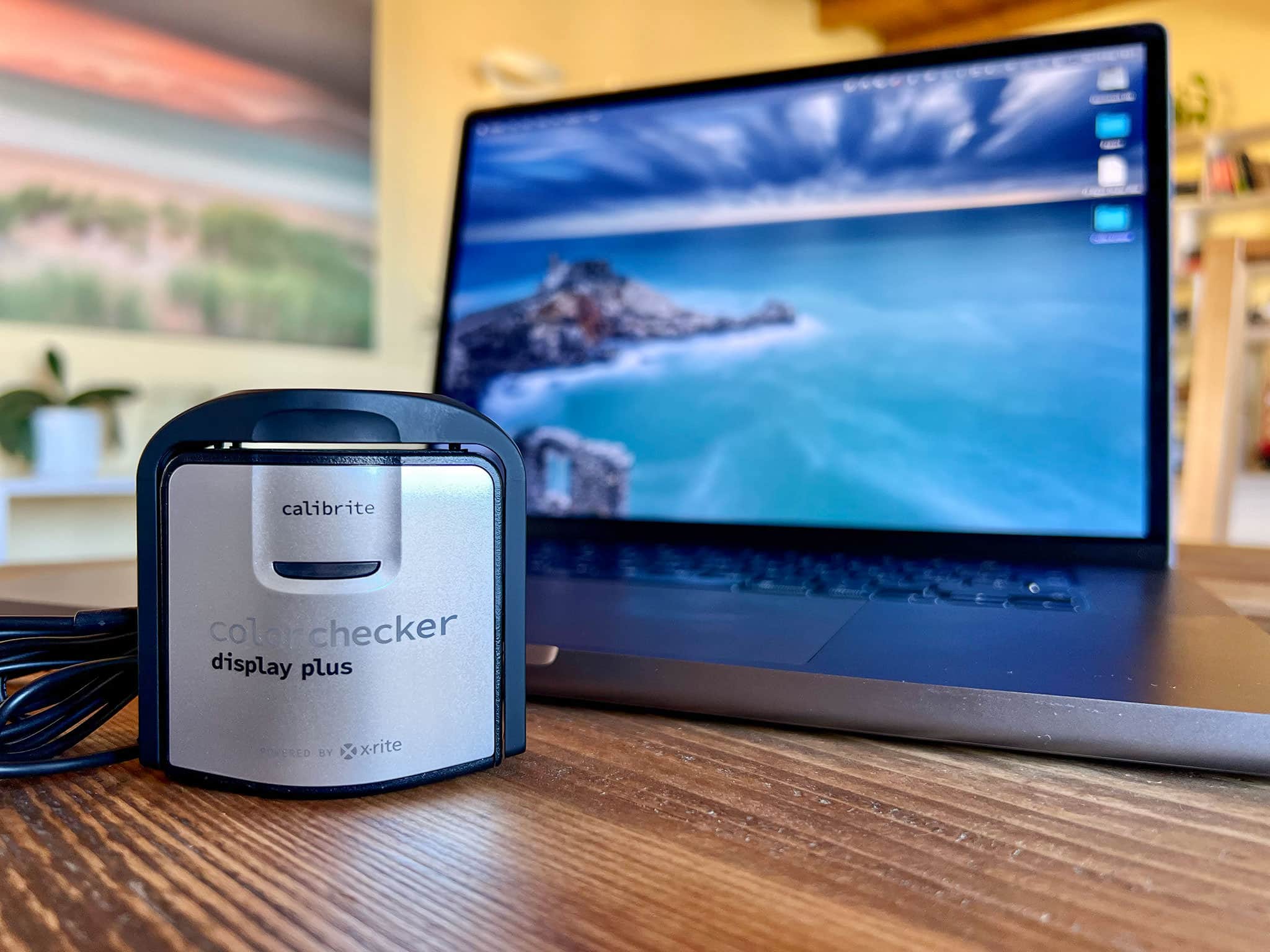

Furthermore, I realized that I had been missing a step in the display calibration procedure on my MBP. Before, I'd just start the calibration process, adjusting the brightness up/down to get to my desired luminance target (120), and then letting it measure/create the profile. But there's a series of steps that should be taken FIRST, to not only get the luminance locked down, but to also adjust the white point of the display, the details of which I found in this article:
How to Calibrate and Profile a MacBook Pro with Liquid Retina XDR (MiniLED) monitor
Calibrating and Profiling a MacBook Pro with Liquid Retina XDR (MiniLED) monitor is essential but not one of the most intuitive processes. In this guide you will learn how to do it easily.
So, with my MBP now properly calibrated, and with the M4 iPP in Reference Mode (with proper fine-tune measured and target numbers entered), the two match about as close as one could expect (and the M1, as expected, now looks a bit cooler in comparison).
