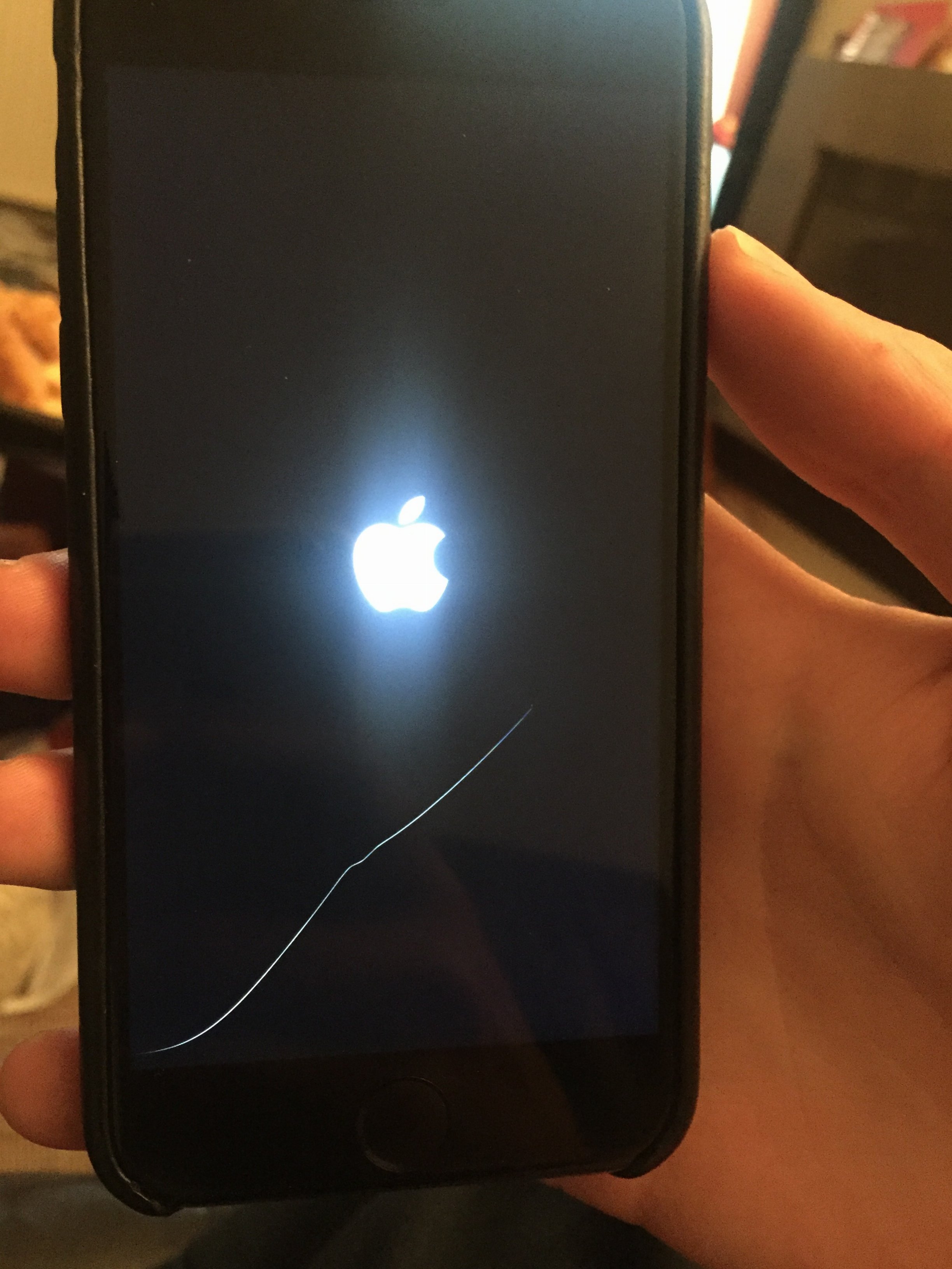

Hi everyone,
Today when I took my phone off charge I noticed a crack on the screen under the glass. It only shows when the backlight is on and appears to have broke internally, it's really strange as the phone was working perfectly the day before.When the screen is off the phone looks perfectly fine.
I'd be interested to know if anyone else experienced this. I'm absolutely gutted as the phone is no longer under warranty. Do you think apple would sympathise with me and swap it for free? (I wish!)
Also recently the phone has been getting very hot. Could these be linked in anyway?

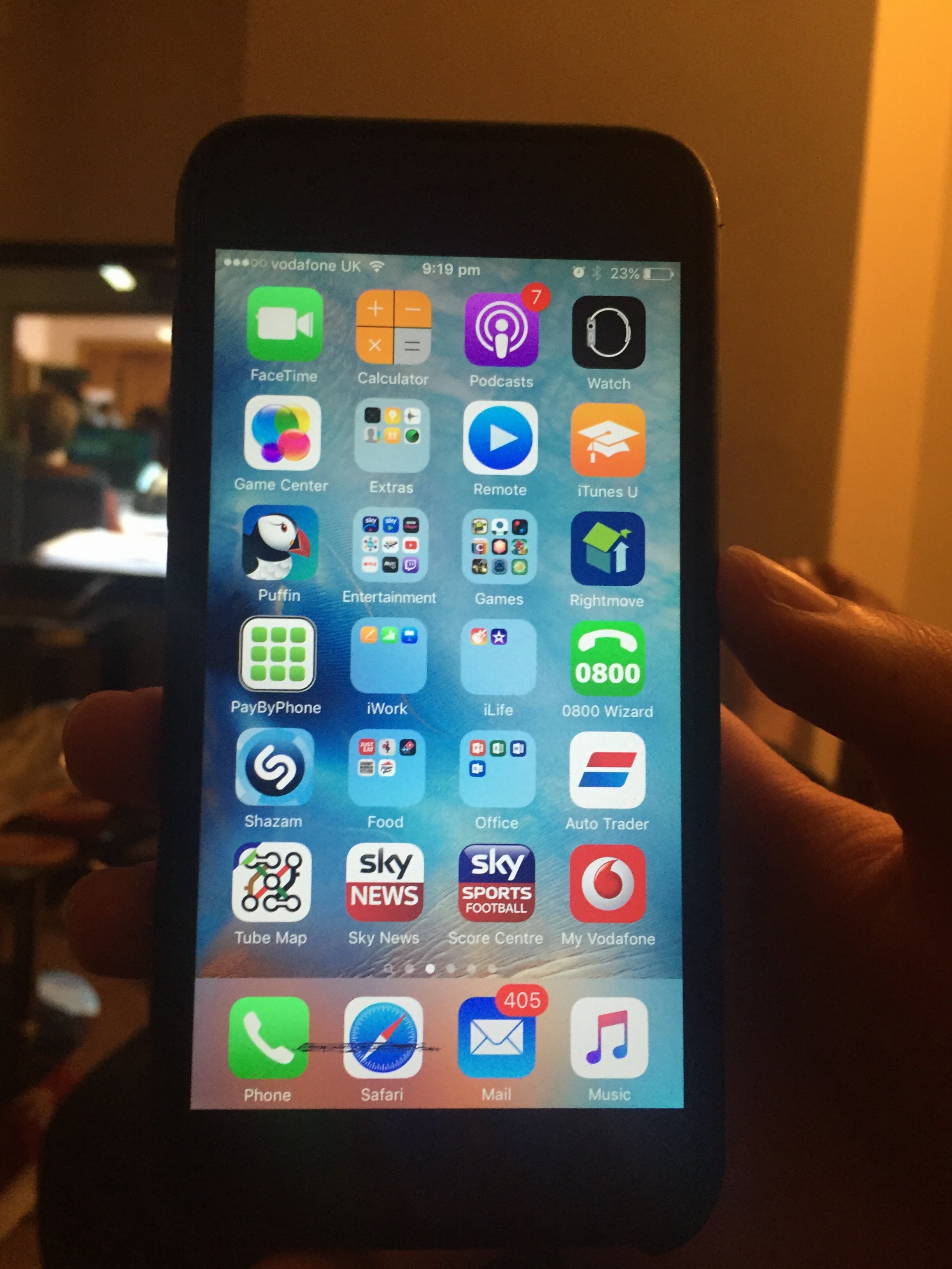

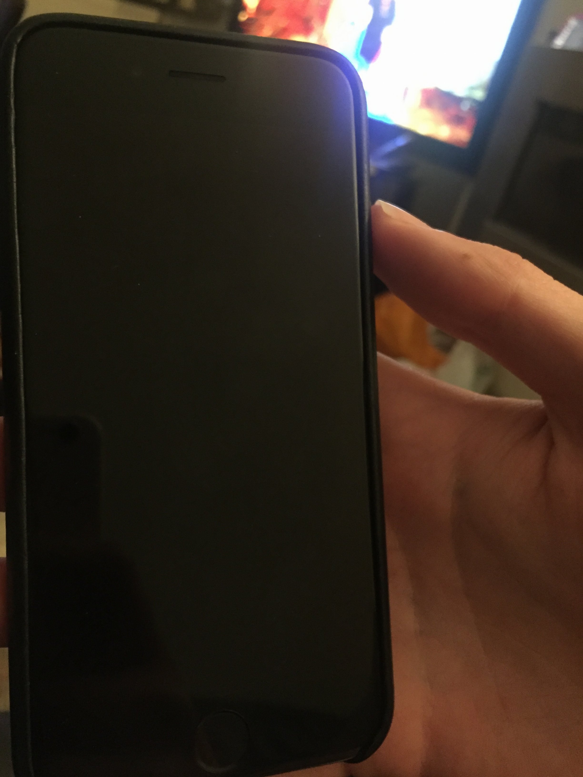

View attachment 630801 View attachment 630802
It is possible that your battery may be swelling. It could have swelled up enough to push on the screen/digitizer and crack the glass from underneath.
Take it to Apple and have them look at it. If it is battery swelling, it's a safety hazard, and they will replaced it free out of warranty or not.
