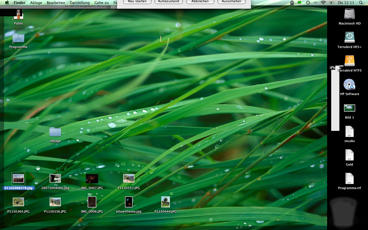

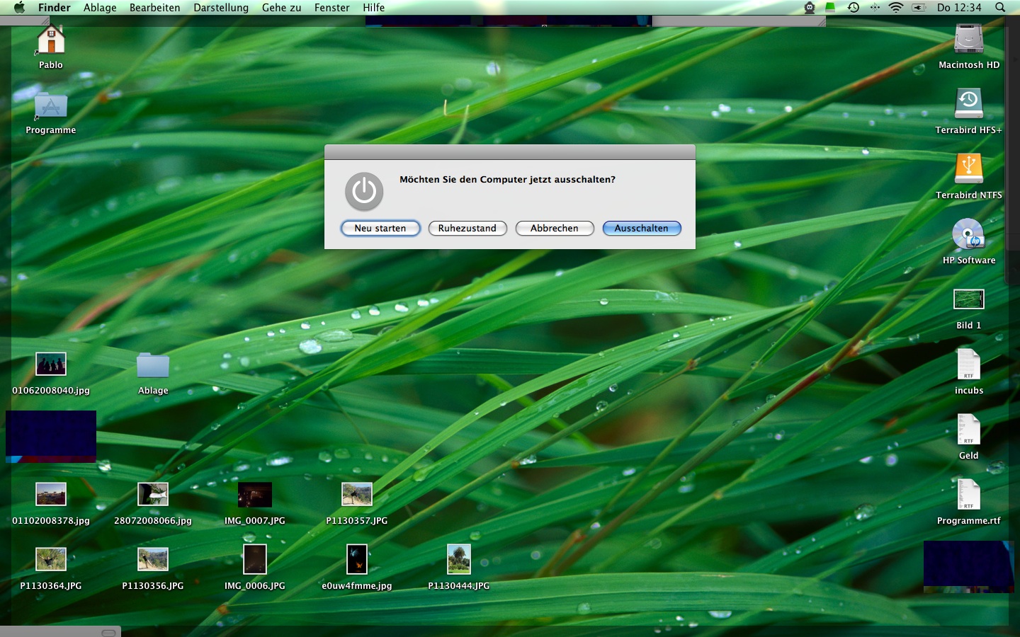

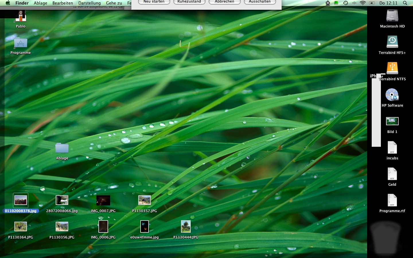

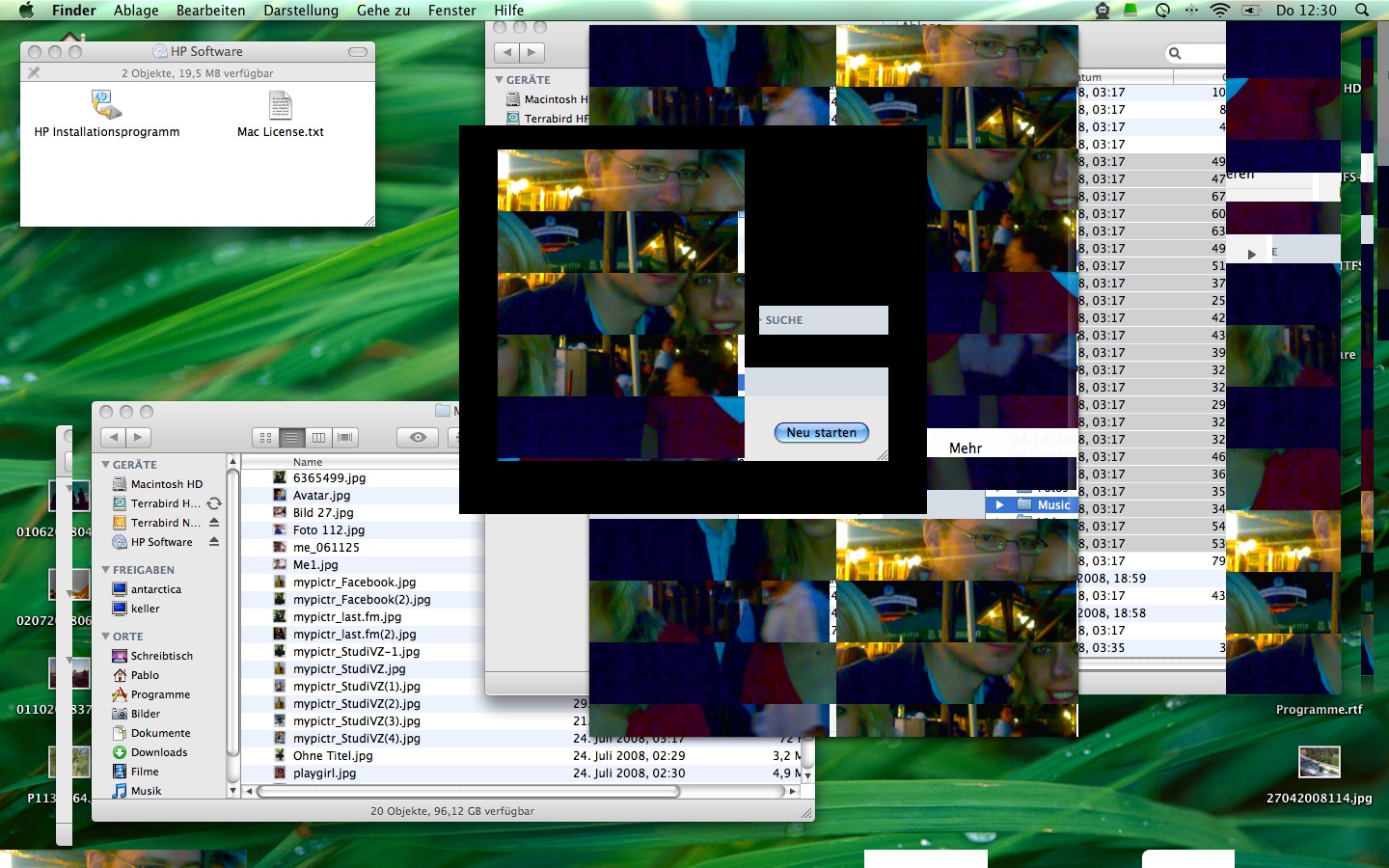

So I was wondering if anybody was experiencing similar issues... 🙁
Greetings,
Pablo
