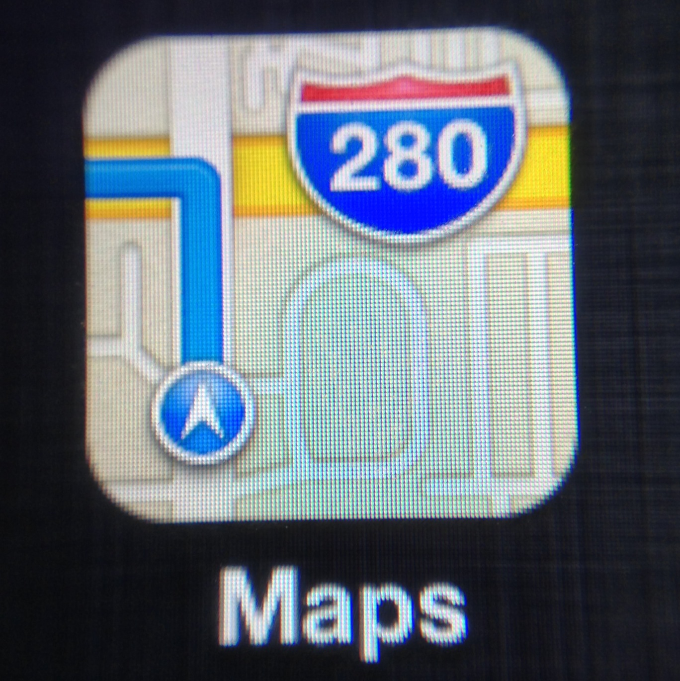

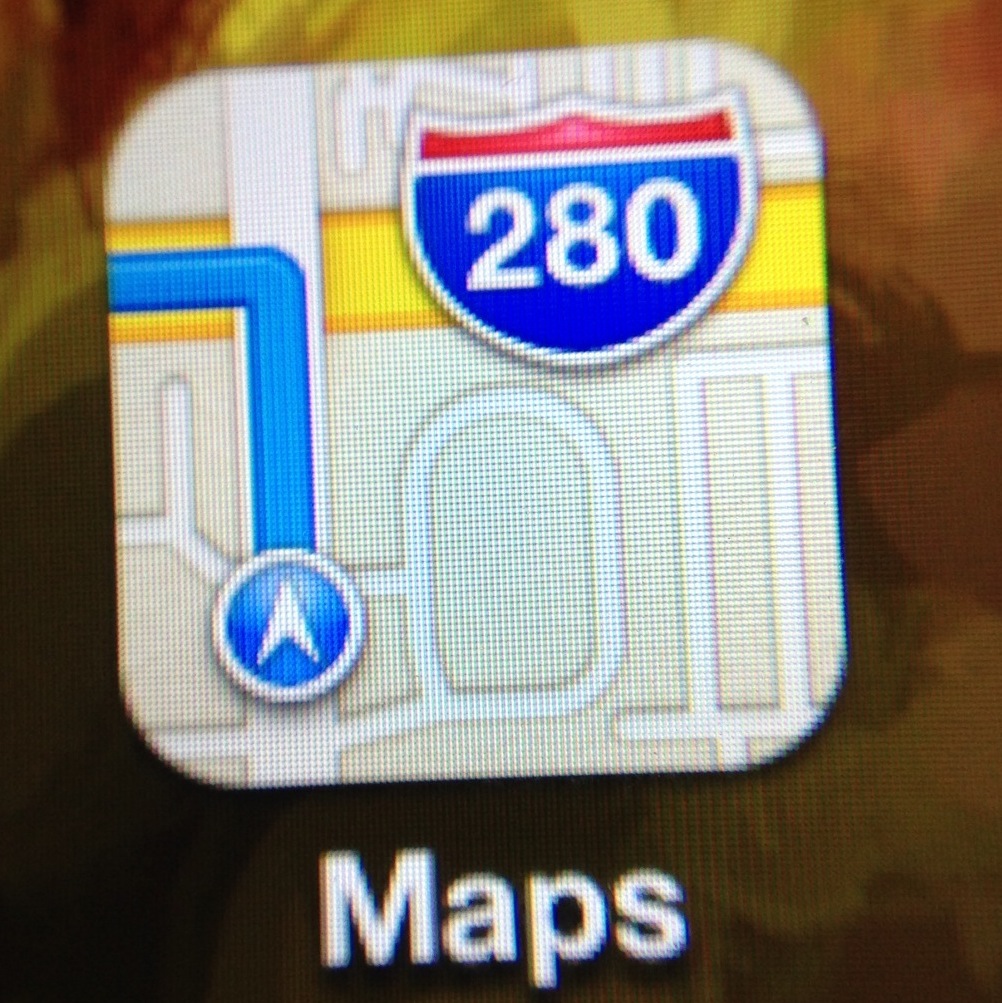

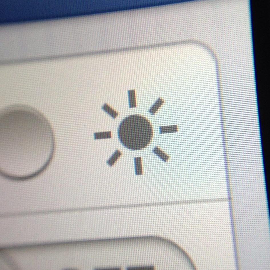

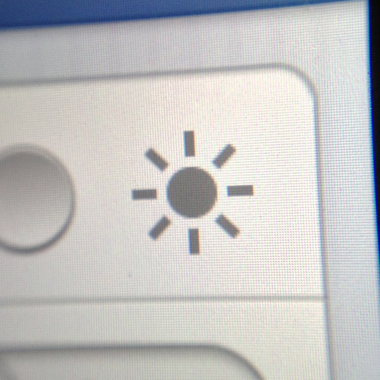

Also here is some more comparison shots of an iPhone that is affected with the issue and another that is not.
That first image looks normal. The second image looks exactly like the screen I had which had interlacing. The screens even look different on camera. If you say you can't see the difference there is really no point in changing. But even when I couldn't see interlacing lines at all times, my phones with bad screens were uncomfortable to look at whereas my current non-interlacing screen is easy to look at. I think it's the flickering that subconsciously makes your eyes uneasy.
My friend with a week 35 F2 also has no flickering but my later F2s which were 37, 38, and 47 all had flickering. It seems something happened somewhere along the line.
