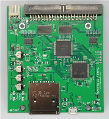

I recently purchased a SCSI2SD V6 board and I also got the following SD card for it
SanDisk 256GB Ultra SDXC UHS-I Memory Card - 100MB/s, C10, U1, Full HD, SD Card - SDSDUNR-256G-GN6IN

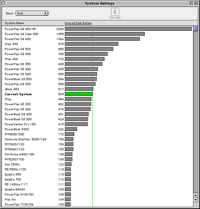

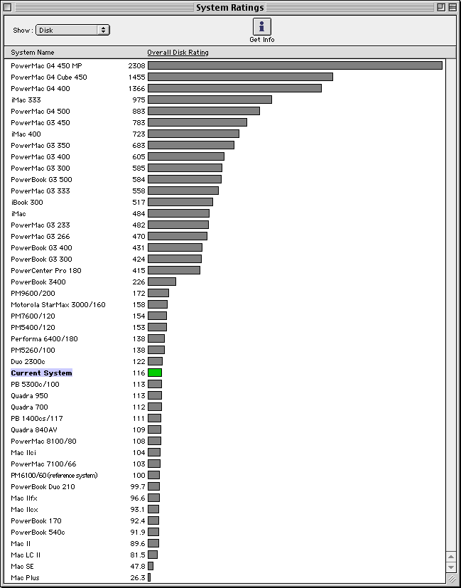

I was able to get the board updated to the lasted firmware and I got the card formatted with 2 HFS+ volumes (each 128GB). I am testing the card on a PowerMac 8600/350 (350 Mhz Mach V 604ev) on its SCSI 2 Bus. I cloned the main boot volume to one of the partitions and I was able to boot from it. But when I ran a disk benchmarking tool on it I was a little disappointed with the performance. I know not to expect SSD performance but I was expecting it to be faster than the mechanical hard drives from the late 1990s. At least that is what I was led to believe from this video The only tool that I had (on hand) to do a benchmark was Norton System Info. And it clocks the SD card at around the performance of a 68040 PowerBook HDD performance. Which is worse than the current SCSI HD that I am using with this machine.
Below are the benchmark results for Disk I/O

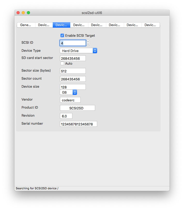

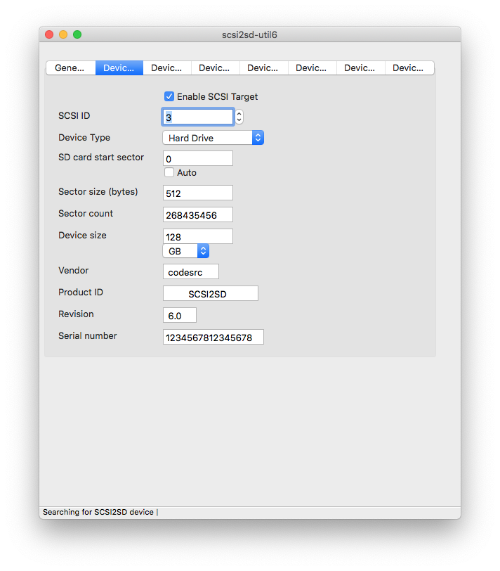

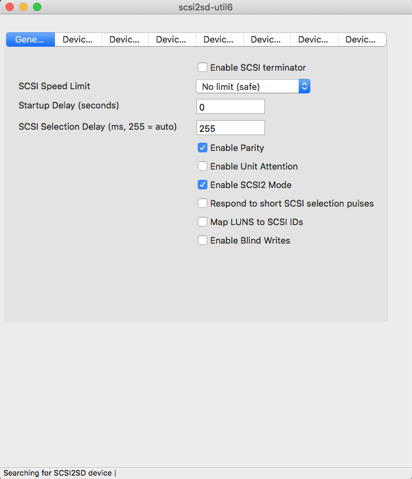

And here are the settings that I have configured for the board.
Any idea of what I may be doing wrong or mis-configuring? I have seem demonstrations of much better performance so I am sure it is something that I am doing.

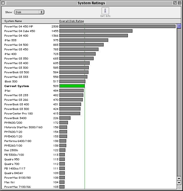

Okay, for benchmarking sake I put back the original Quantum Fireball drive and ran the same benchmark and I got the following result.

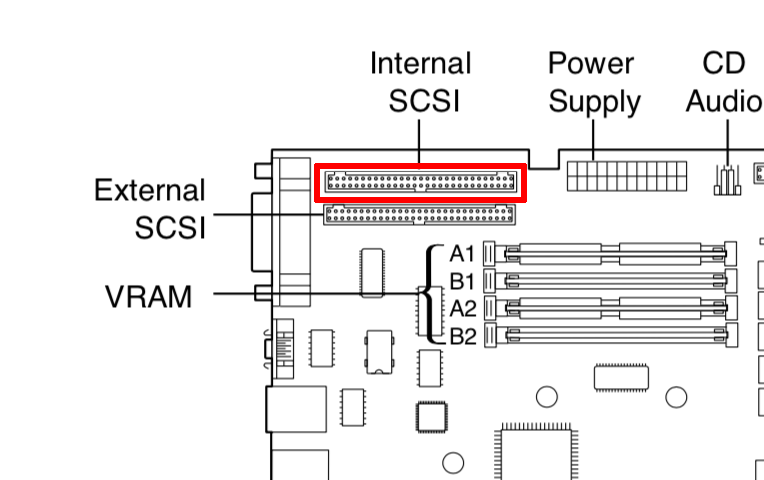

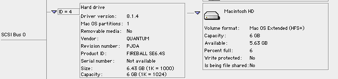

So even if at the WORST case scenario the SCSI 2 SD were to match this result, I would be okay with that. But since it is benchmarking at 1/5th the speed, that is making me think that I am mis-configuring something. Although I have yet to open up the machine to physically check the busses, I did check in System Profiler and I noticed the following.
The drive is sharing the same bus as the Optical Drive and the internal Zip. So I am not sure if SCSI Bus 0 is the internal bus or external bus but it was physically on the same ribbon chain as the aforementioned devices.

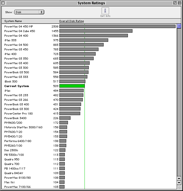

You can add up to 7 Drive to a FAST SCSI cable. All drives are workig with full speed. SCSI is a bit complicated to configure if you don't have the basics.
Every drive must have a unique ID and both sides of the cable must be terminated (nomally the controller is self terminating, so you need to terminate the last drive only)
