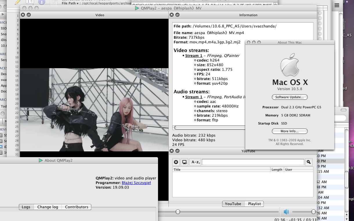

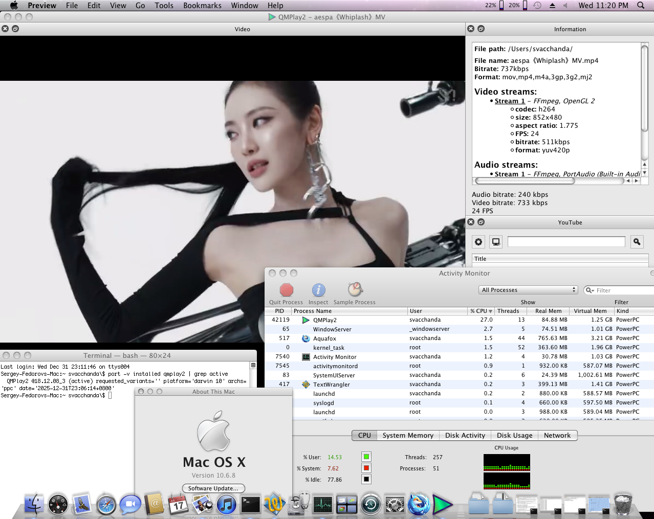

install QMPlay2 - there is gui there, h264 doesn't play - no image, time counter at 00 then stops.
Can’t reproduce. Do you try offline video or streaming? Streaming from YT may have issues for unrelated reasons, offline it works normally for me.
QMPlay2 is a single process, but there is an equal load per-core.
Xvid works. Performance is bad.
Re QMPplay2.
Could you give some details? What machine, what are video specs? If you can share (upload somewhere) a sample of video to try, it will be nice.
4k at 60 FPS will likely lag, though it can be partly improved via settings (disable sync to audio).
But if you get visibly worse performance in QMPlay2 when compared to mpv and mplayer, something is probably wrong.
Precompiled.
Error: Can't install qt4-mac-devel because conflicting ports are active: qt4-mac
sudo port -f deactivate qt4-mac
sudo port -v -N install qt4-mac-devel
P. S. I have verified that QMPlay2 works fine regardless of whether qt4-mac or qt4-mac-devel is used. No issues with offline h264 playback on my end.

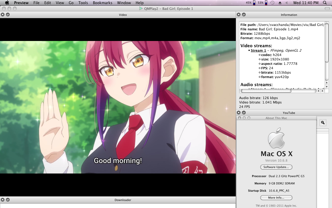

Re QMPplay2.
I have built updated dependencies now, and QMPlay2-devel works fine on Leopard.
