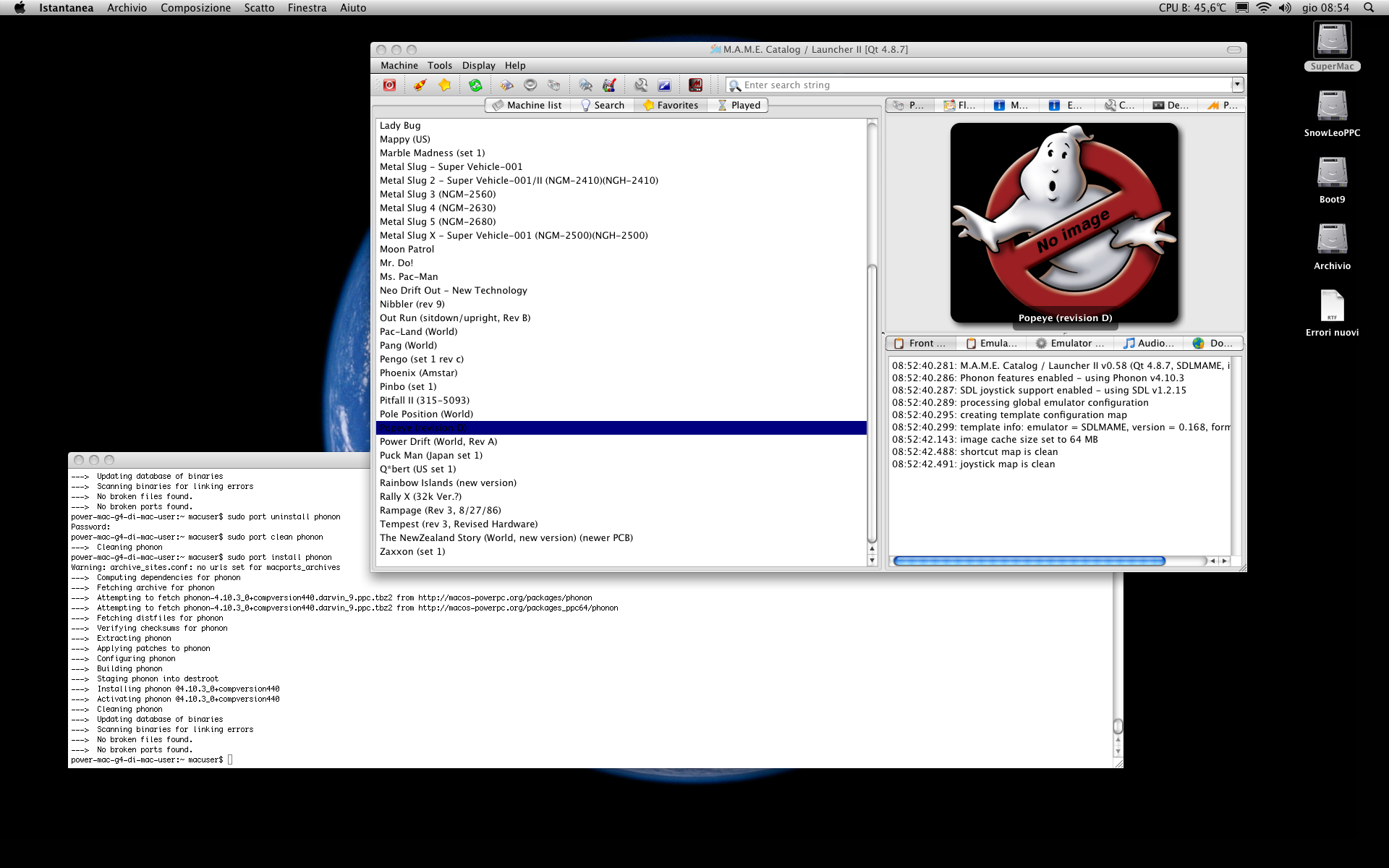

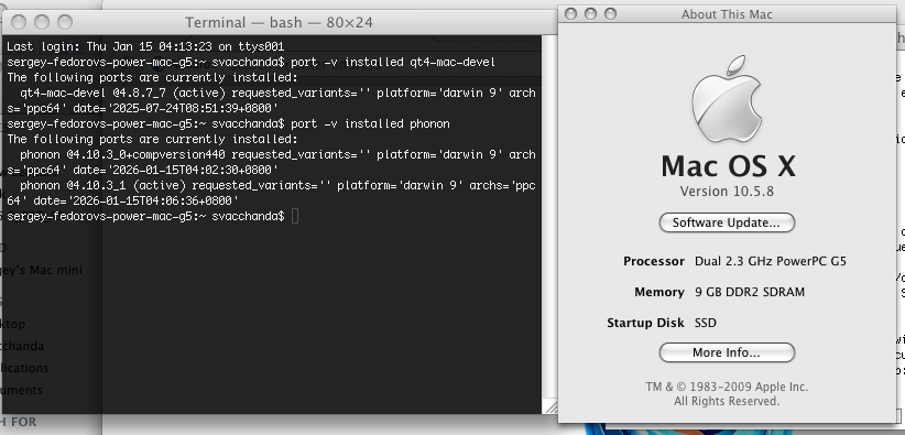

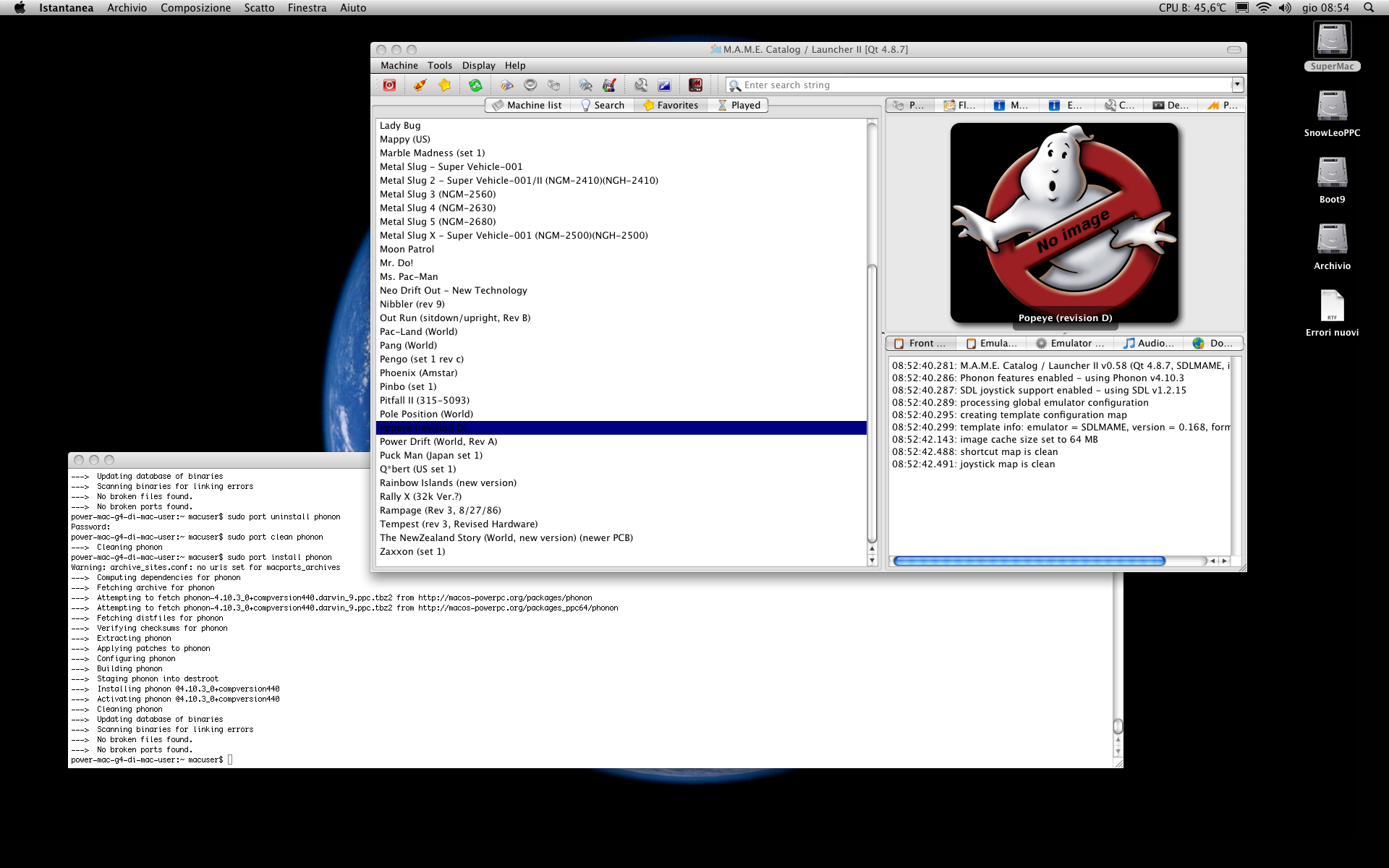

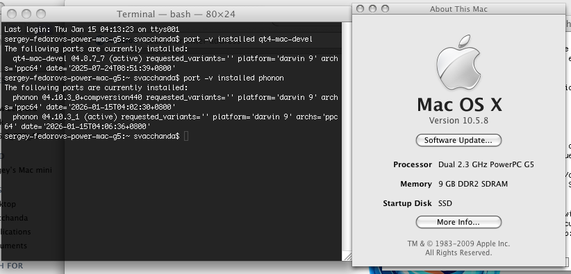

Well, this is fun... I have just stopped the installation of qt4-mac-devel, redo the command "sudo port install qt4-mac-sqlite3-plugin", the old qt4-mac went reactivated and now the sqlite3 plugin is installed... however, if I try to redo the same command, the terminal told me the same thing as before (even in verbose mode)
Error: Unable to open port qt4-mac-sqlite3-plugin: can't read "qt4_dependency": no such variable
Anyway the plugin now is there, the verbose install of phonon is the following:
sudo port -v install phonon
Warning: archive_sites.conf: no urls set for macports_archives
---> Computing dependencies for phonon.
---> Fetching archive for phonon
---> phonon-4.10.3_0+compversion440.darwin_9.ppc.tbz2 doesn't seem to exist in /opt/local/var/macports/incoming/verified
---> Attempting to fetch phonon-4.10.3_0+compversion440.darwin_9.ppc.tbz2 from http://macos-powerpc.org/packages/phonon

---> Staging phonon into destroot
. missing (directory not created: File exists)
./Applications missing (directory not created: File exists)
./Developer missing (directory not created: File exists)
./Library missing (directory not created: File exists)
Executing: cd "/opt/local/var/macports/build/phonon-df9a10e9/work/build" && /usr/bin/make -w install/fast DESTDIR=/opt/local/var/macports/build/phonon-df9a10e9/work/destroot
You need to clean the build first, other it just tries to resume.
I just installed phonon with qt4-mac-devel with no issues on Leopard.

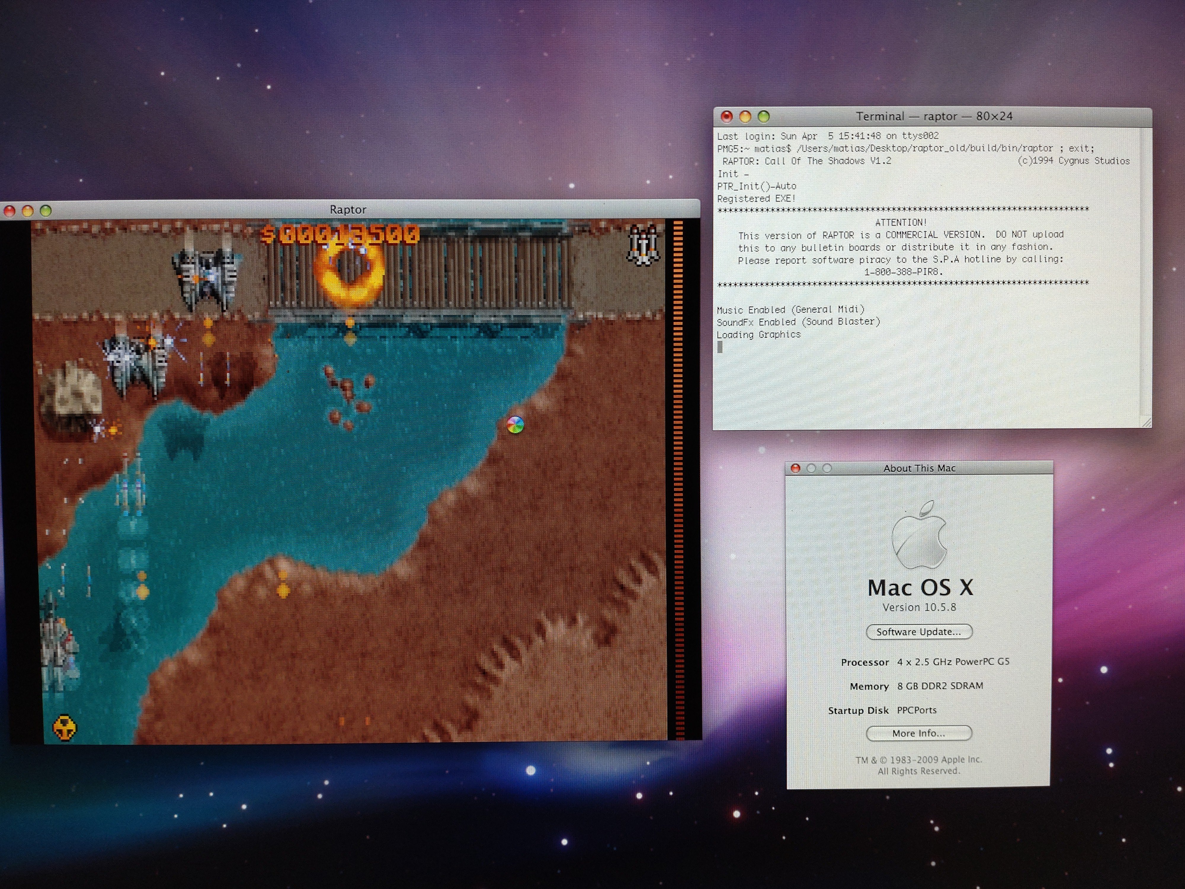

Crispy-doom port exhibits a similar behavior. Game runs fine but appears frozen on the spinner and doesn't accept any input.
I ran into this exact problem once again. I compiled https://github.com/skynettx/raptor and the game fully runs with sound and everything after 2 very minor fixes needed to get it to compile (strnlen and AudioComponentDescription).
Interaction/input is impossible 🙁. I just get the spinning ball, the game shows up as not responding in Activity Monitor and spindump process is active.
EDIT:
This is using libsdl2-cocoa-2.32.10_1+opengl. I can confirm that the issue does not exist when using libsdl2-x11-2.32.10_0+opengl.
EDIT:
Yeah, that’s a known issue with Cocoa one. Annoying, since it makes video controls unusable in mpv. (Likewise, x11 is fine.)

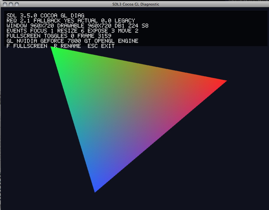

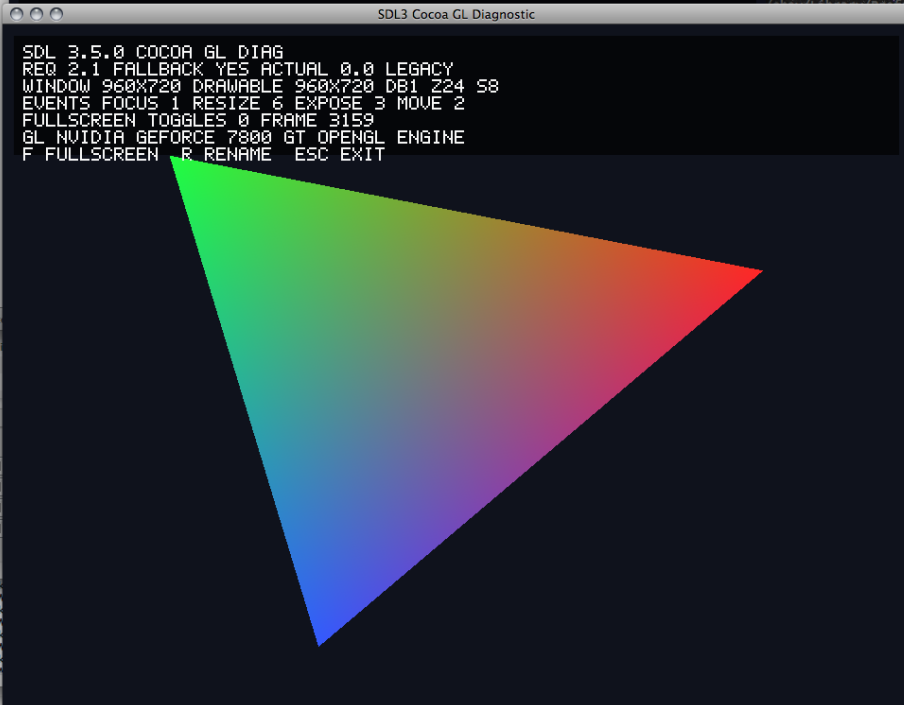

Sort of relevant, I fixed SDL3's Cocoa + OpenGL backends to work on PPC/Leopard. Maybe with `sdl2-compat` this would be more useful than the ancient version of SDL2 we have.
You can check out my fork here: https://github.com/doctashay/sdl
@barracuda156 would love to figure out how to make this available on PPCPorts.
@srp Sounds great!
I am away from the hardware at the moment, unfortunately, so can try this only once I am back. If you wish, we can add it as a non-default variant first. You could make a PR with a patch (as I understand, it does not need to do anything non-trivial, just a patch against existing source?).
I left a few comments there: https://github.com/doctashay/SDL/co...2b4693af2926a13463779#commitcomment-181672924 (since Issues are not enabled).
P. S. Are fixes back-portable to SDL2? (Most of related software still use SDL2, so it makes sense to fix both.)
