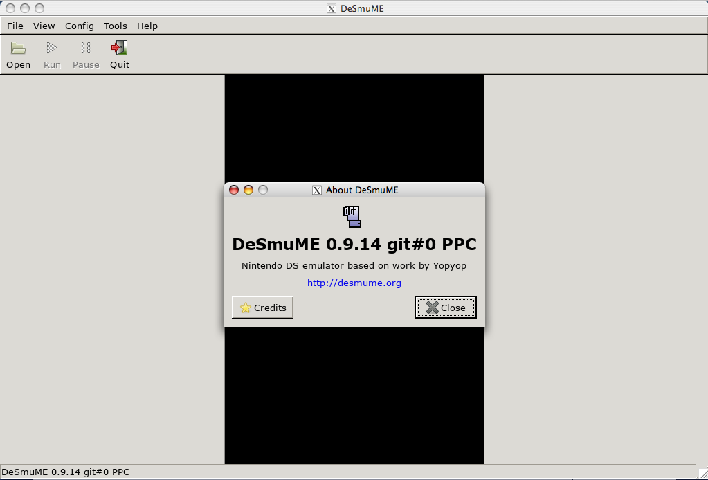

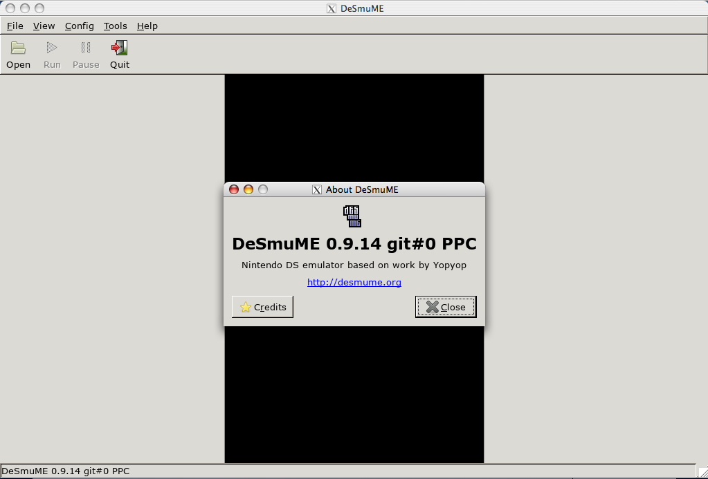

@lauland Side note, but we can enable joystick dummy without any tweaks to Cocoa module, and that apparently can remove launch failures with apps that require it.
That's awesome! How do we do that? I got Desmume to compile on Tiger, but it fails to launch because of lack of joystick support. If I can test it with the dummy and it functions, I will make a Portfile.
Check libsdl2-x11 port. I will do the same for -cocoa today.

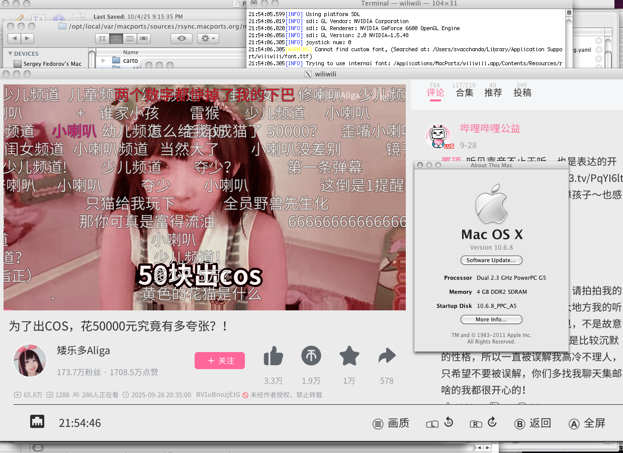

This is wiliwili client using SDL2 on 10.6.8, which had that issue (and which led me to fixing it finally):
